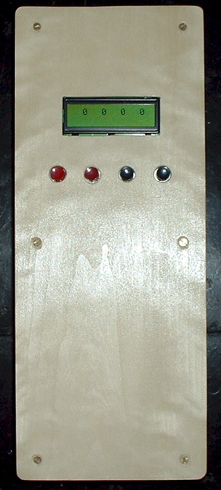

Carb sync...

Here's one video to show how it compares to a mercury manometer. All eight readings (of the two manometers) are connected to one cylinder so they can all be compared against each other.
You may need to watch it full screen to see the numbers and the columns.
I'll post more details as I can.

So whats in there lou, a couple map sensors and a digital voltmeter or something?

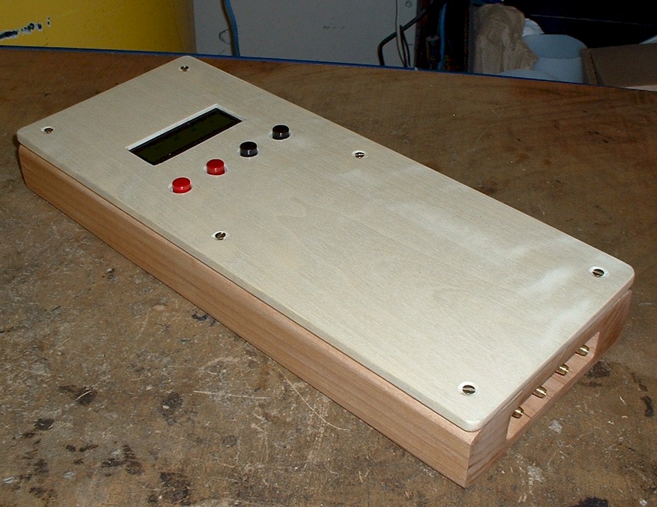

Yes, four raw transducers, plus differential amplifiers and the core is a microcontroller. The parts cost about $100, but I didn't really find good deals anywhere. The rubber tubing, alone, was over $20.

Ya if you could put up a Scamatic that would be awsome!!
