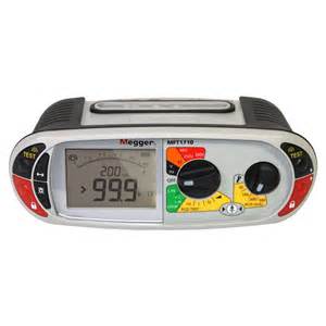

The coil test procedure in the manuals seems like a blunt instrument to me, will sometimes confirm a duff one but not really certain.
As above coils often become intermittent rather than totally failing.
Do you think a 1000V 'stress test' with a megger would show a duff coil?
(Used for testing domestic and commercial wiring - will also measure disconnection times for RCD and MCB's , ground loop impedences etc)

1000v on the primary might damage the coil. The primary side usually sees up to about 600v, but could be as little as 300v. In use, the spark plug gap and cyclinder pressure determine what the final secondary voltage, and thus the final primary voltage, will be. It's usually around a 100:1 ratio.
1000v, would then be inadequate to test the secondary.
As you pointed out, illustrated by the earlier video, the coils can fail gradually, so other basic tests won't really tell you the whole story.
