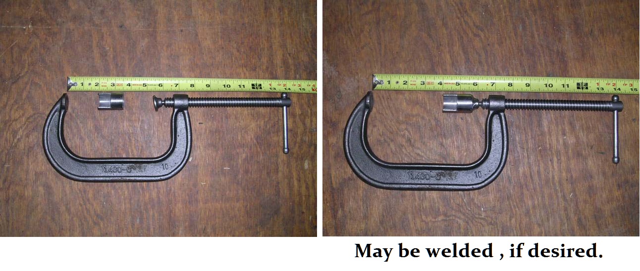

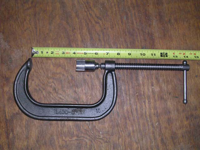

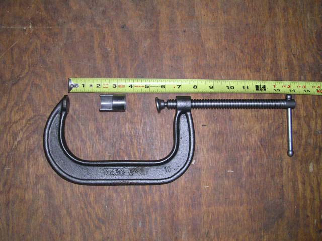

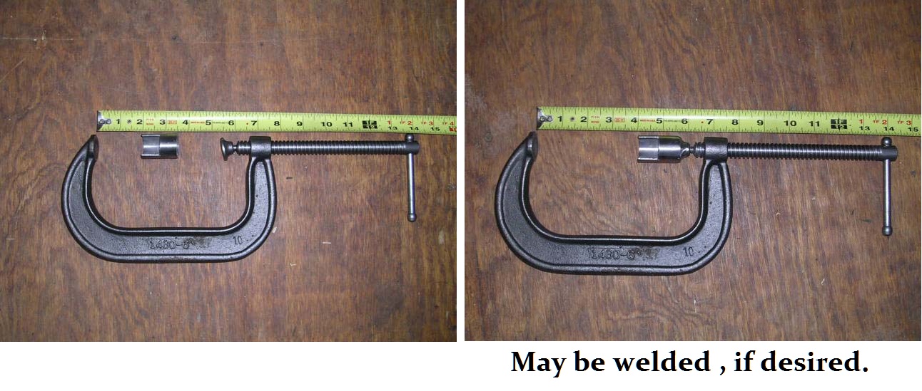

I have used the the c clamp type shown above with a cut out bucket for years . Works great.

Wow, I might ditch my converted automotive one for one of those C clamp types!

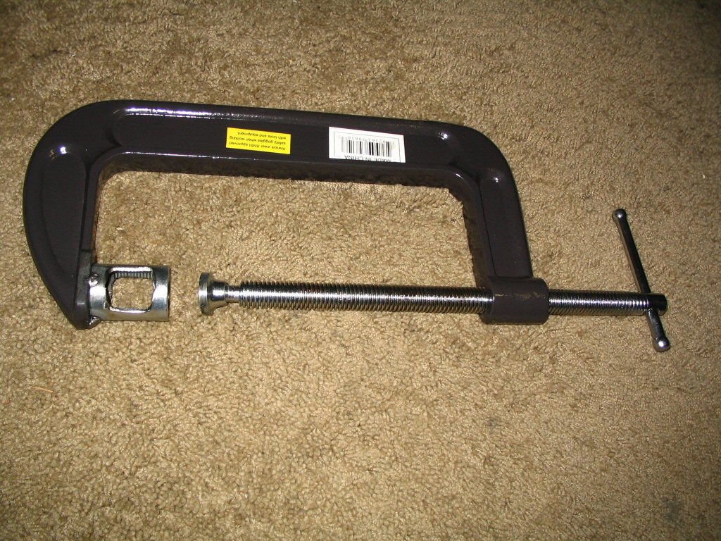

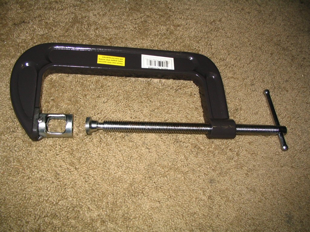

No eBay APP ID and/or Cert ID defined in Kunena configurationFor $15 & Free shipping how about this one....

No eBay APP ID and/or Cert ID defined in Kunena configurationNot sure it will be any better than the cut down bucket on the c clamp.
650ed wrote: For $15 & Free shipping how about this one....

Here's mine. I use an old bucket with a hole in it. Works great,
