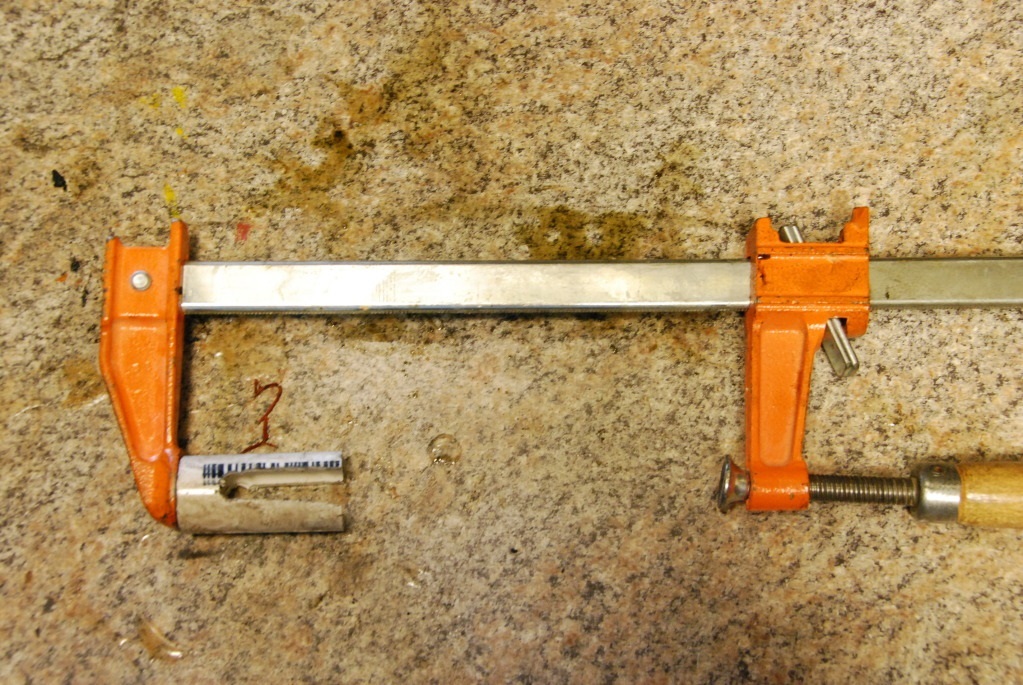

I have used the the c clamp type shown above with a cut out bucket for years . Works great.

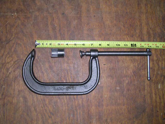

Wow, I might ditch my converted automotive one for one of those C clamp types!

Made one out of an old socket

Here's mine. I use an old bucket with a hole in it. Works great,
Wayne
