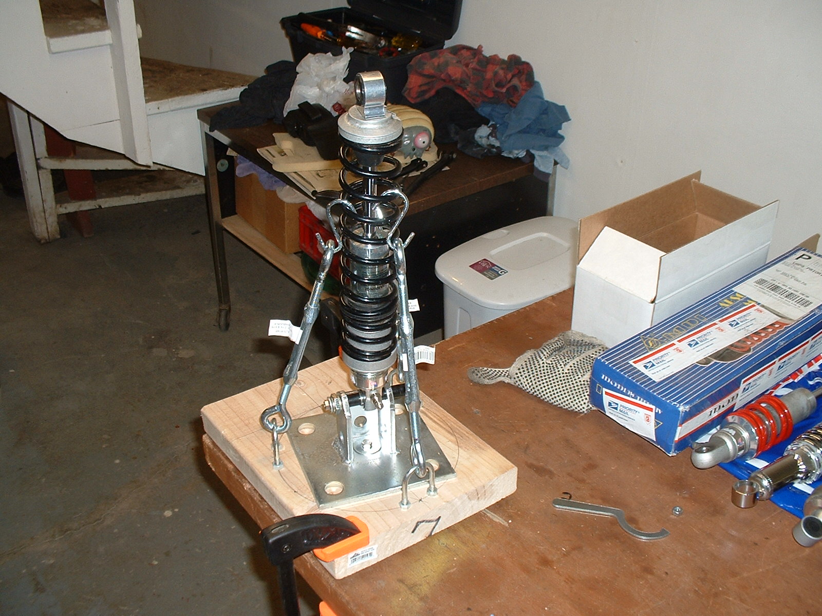

Has anyone made a shock coil spring compressor tool? If so would you mind posting pics of what you done? I dont really fancy splashing out £30 ($50 ish) on something i'm probably only going to use once

This is probably not cheaper if you have to buy everything. I had most of it accumulated over the years. The main reason I made it was that it was much faster than the compressor my friend had, and I was going to be doing a lot of spring swapping.
I only have one photo of it. Get the bracket from a large caster and take the wheel off. Use that as the lower mount for the shock. Attach it to a board and clamp the board to a table. It's hard to see in the photo, but there are actually 3 turnbuckles. Each one is held down with a "U" clamp mounted into the board.
Once the turnbuckles are set to the right length, it's just a matter of rocking the shock backward or forward to pull the spring down and slide out the retainer.
Later I replaced the "S" hooks with strapping material loops to prevent scratching the springs.

Thanks Lou. I think im gonna see my friend with the CNC machne tomorrow night. I'll get 4 'claws' knocked up & use some M8 threaded bar with nuts & washers to compress them.
Either that or 2 claws & a flat plate with a 40mm hole & 2 M8 holes either side to put the bar through & grab the 'claws'. The only thing putting me off the 2nd descroption is i doubt every shock will fit into a 40mm hole.
