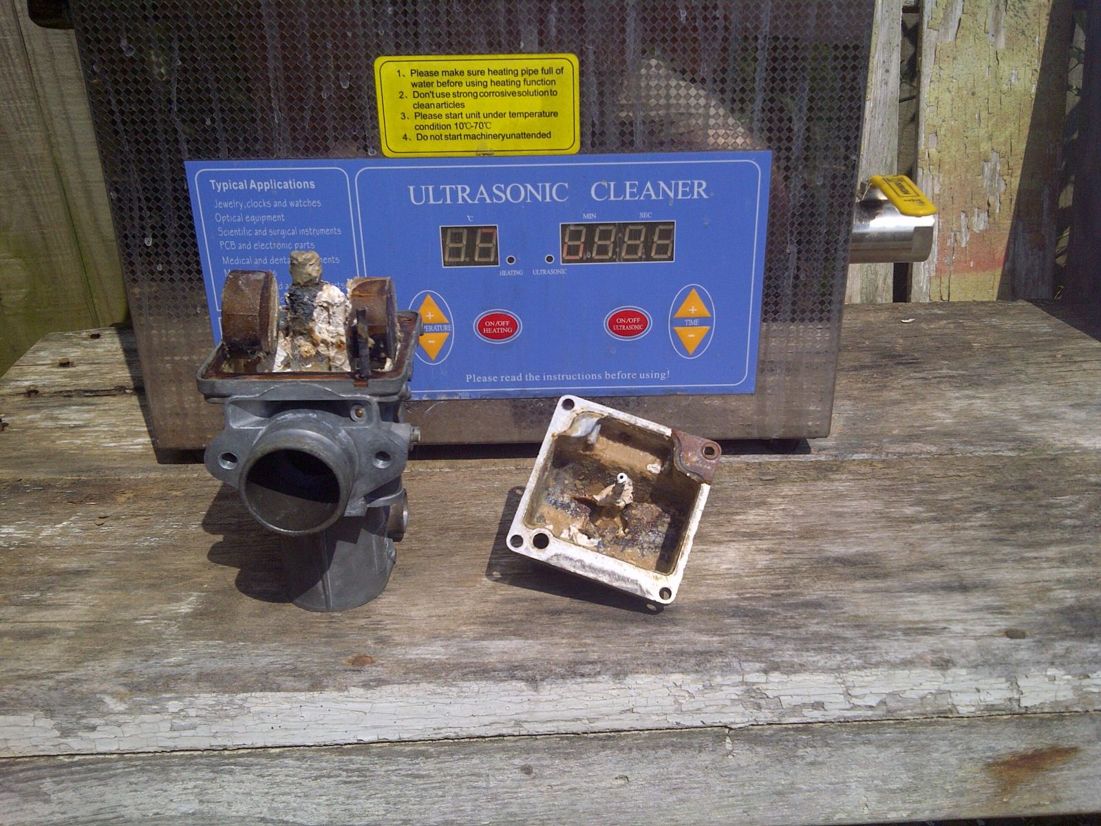

I have been cleaning up some old carbs and the ultrasonic cleaner is realy worrth the money if you have a lot to clean, If I only had a few bikes I wouldnt buy one, One this size 6 litter cost around 300.00 Anyhow I opened up a carb and found this so im going too take a before and after picture. I use 1 gallon of vinegar half a cup of stanly degresser and fill the little bit left with rain water. Dont think I could find anything dirtier will post results in a bit

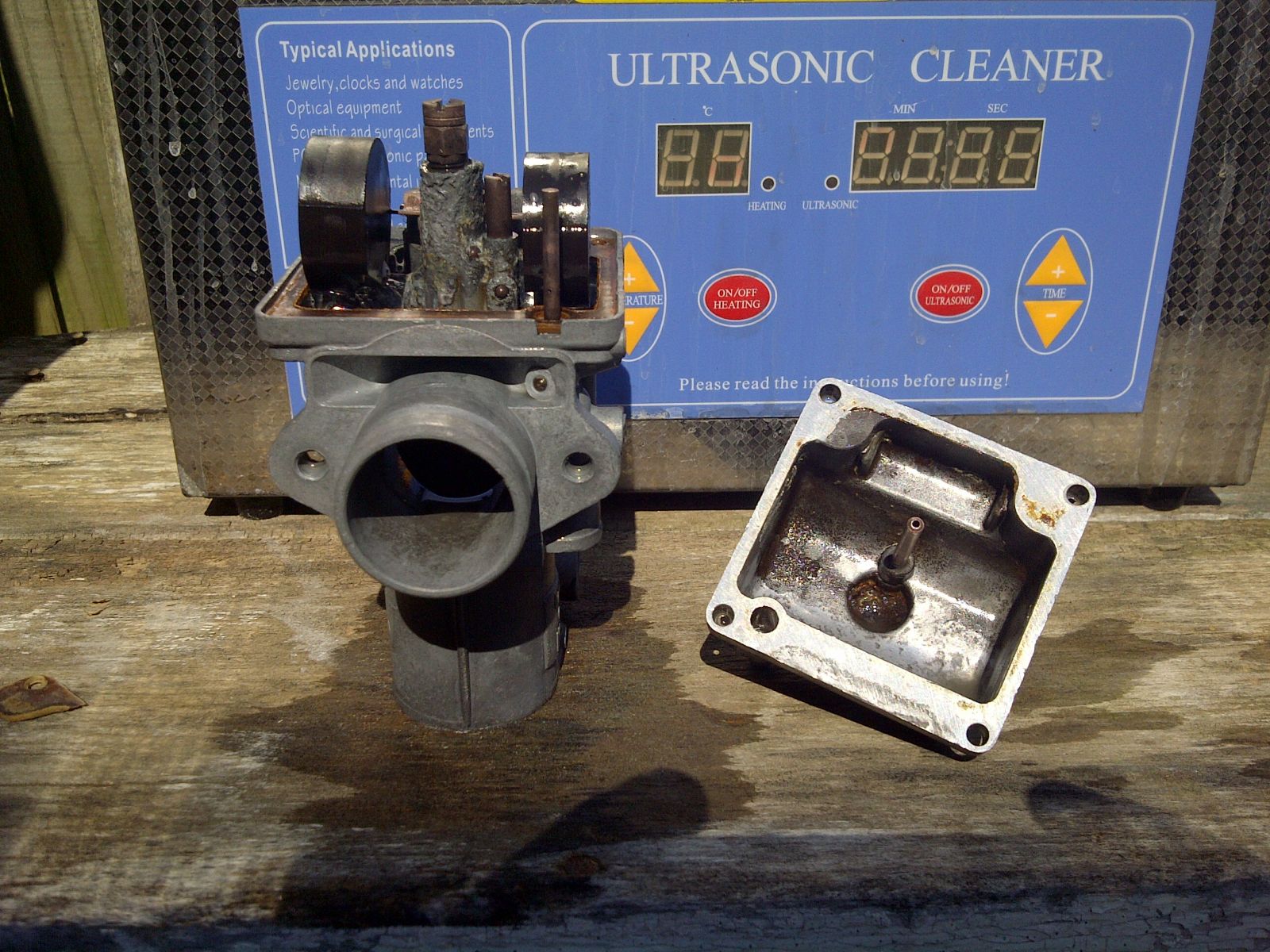

1 hour later it works great on carbs that are not that bad and I actualy think it did a great job in an hour. No I dont usualy leave the parts on when i clean I just did it like this for a test.

Looks like it did one heck of a job, considering how nasty that carb is.
