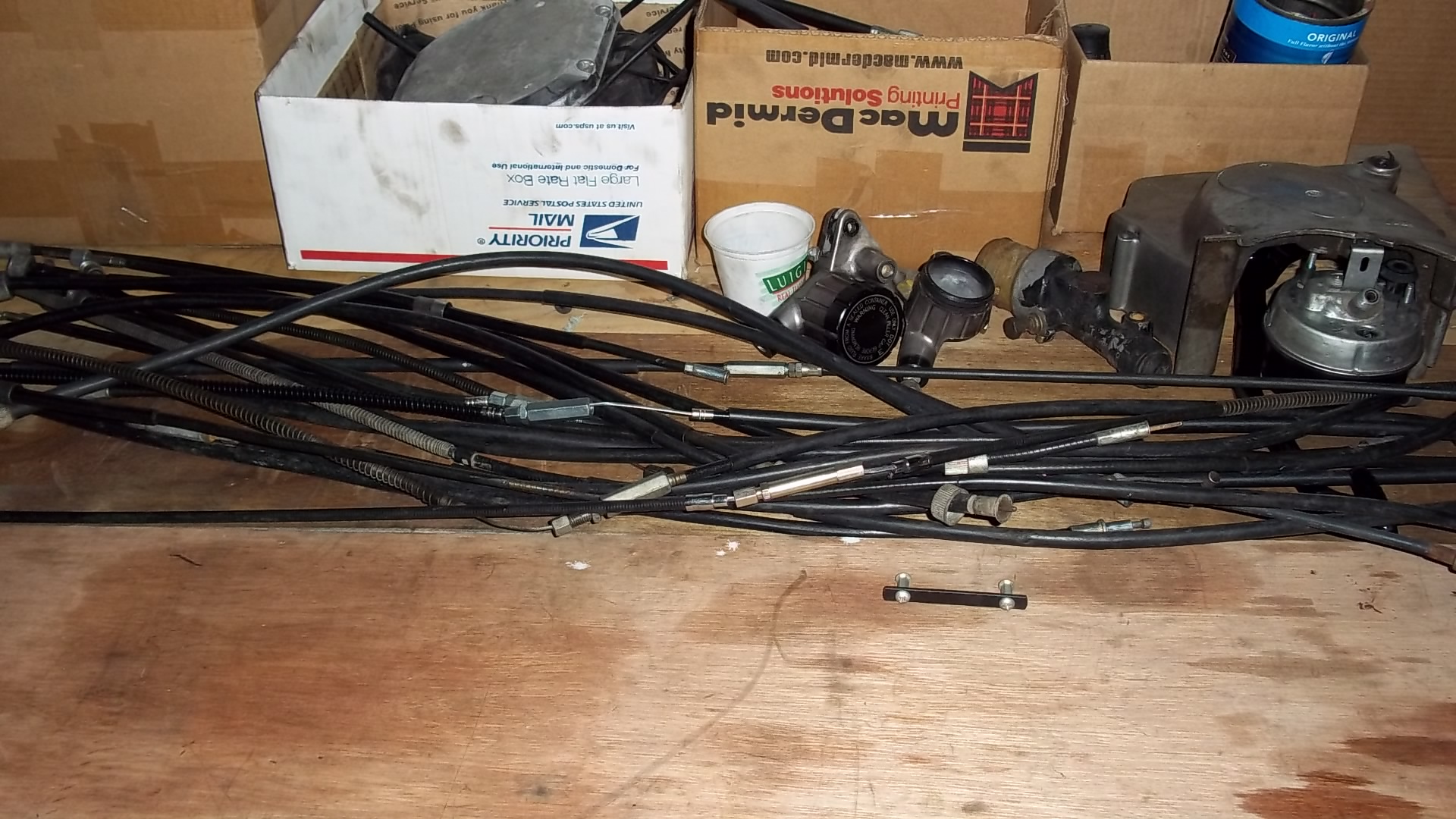

25 years ago, Easyrider magazine had a roadside tip:
carry a small hose, screw clamp. If your cable breaks up top like most do.
losen all your adjusters to get enough frayed cable to clamp that to your clutch lever.
Enough to hold it till you get somewhere safe.
When I rode, I always carried a master link and one of these screw clamps in my tool kit.
Then get home and look in the junk pile.
