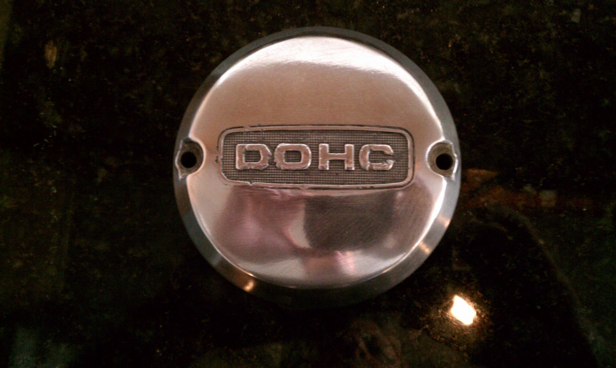

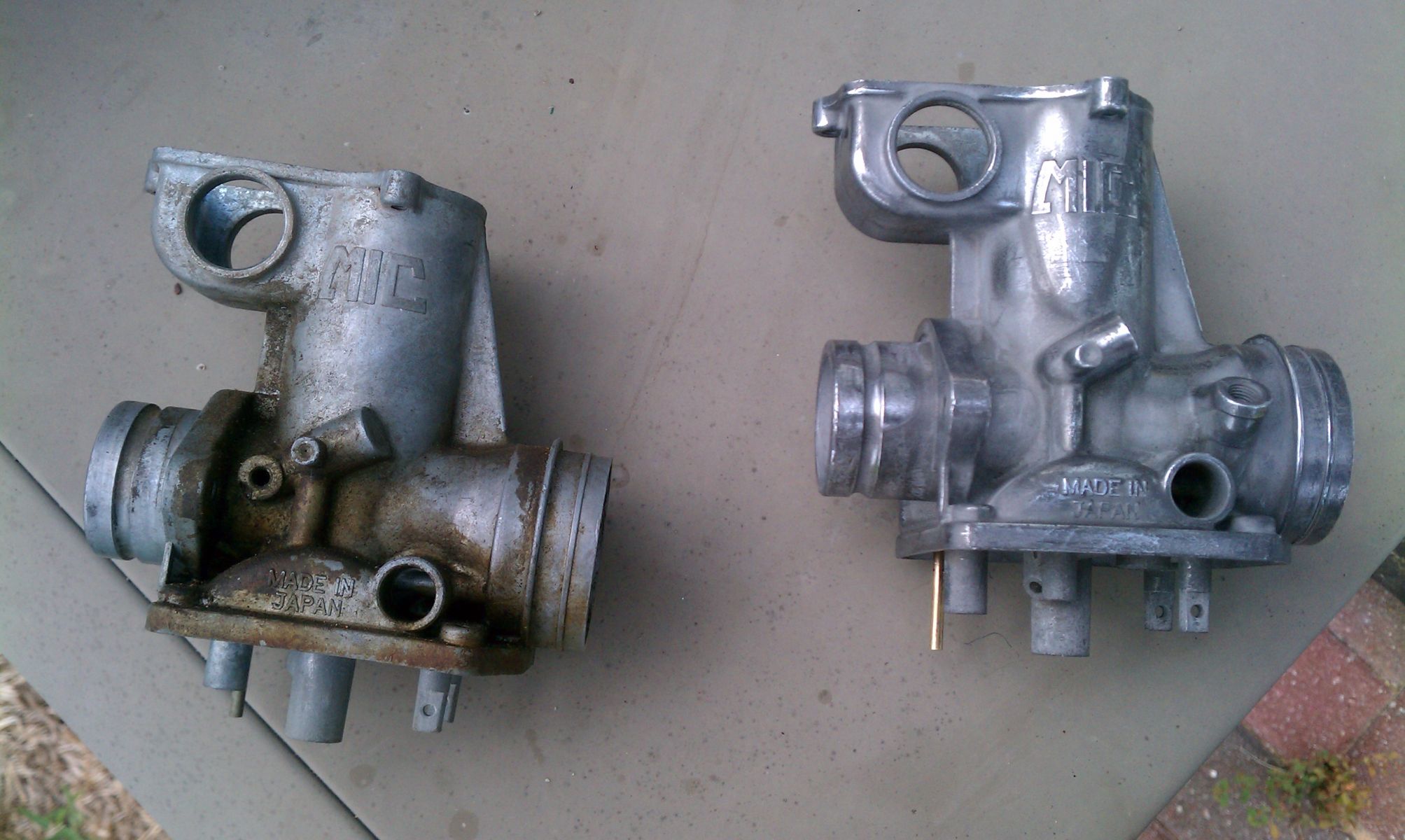

This is an awesome post. I will try it out without a doubt. I have used a polishing wheel (mounted on a drill) with great success. I have somewhat restored my points cover and polished up my carbs (attaching before and after pictures). However, my question is: What do you do once the part is cleaned and polished? Should I spray it with a clear coat? The carbs seem to be dulling and getting a dark residue again. The points cover is ok so far. I have purchased some Rust-oleum clear coat engine enamel. Figured it would be the best for higher temp applications. But I am worried it will yellow after a year or so. So I haven't decided if I will use it. I don't mind not clear coating it and just wax it to keep the luster. As long as that will work. When I tried that with the carbs, (Maguire's ultimate qik wax) it seemed to have darkened it again. What is recommended?

Thanks for the info. Don't really want to paint the carbs. Trying to keep the bike as close to original as possible without going overboard. It looks to me like the Eastwood product is to protect the metal (sort of like armor all would do to rubber) and not an actual clear coat paint. They say it lasts 3 months. This may be a good option as long as there is no elbow grease required at every 3 month application.
