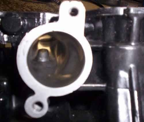

Before I deem this tool "a piece of ship", I'd like to hear from anyone that's actually used one with results.
I used my $80.00 tool for the first time today, as I'm slowly working on my '85 GPz550 installing the 615 kit. I have a replacement bottom end(a.k.a.short block) that only has 12000 miles on it as a doner, so I don't want to split the cases to replace the chain. My old engine has a case of #3 rod knock at the 44,000 mile mark. I have a new cam chain from Kawasaki, and want to replace the cam chain with the tool and link I bought from Z1 Enterprises.
I started to use the tool today, as it should be pretty self explanitory, or so I thought it was. The part of the tool than pushes the link pins thru the actual chain isn't long enough to push the pins completely thru the link(in the picture above it's on the right). How is one supposed to extract it any further? I fiddle-farted around with it, for more than I wanted to, and after much frustration, I stopped.
Someone has used this tool with success, right?
This is what it looks like, and I can't go any further.

I'm not giving up on this cam chain replacement. I have two choices.
1. Have the cases split and "while I'm in there..." replace the main and rod bearings...
2. Buy a cam chain tool that will work for my application. I've tried everything I own to get the remaining pins out of the chain, but nothing seems to work.
No ofense to Z1 Enterprises, but that K & L Tool will not work for the type of chain I have on my GPz. That is something that should be noted on their site.
Does anyone know what tool will work for the chain pictured above? I'd prefer not to split the cases, and do all in #1 above. This engine only has 12,000 miles on it.
I'm open to suggestions.
:S

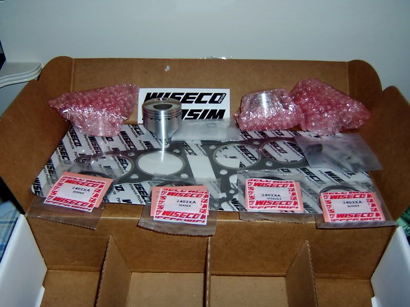

This 615 kit has been sitting in the box since June of this year, and the cylinders I had sent out to APE were machined for this kit. Been way too long.
