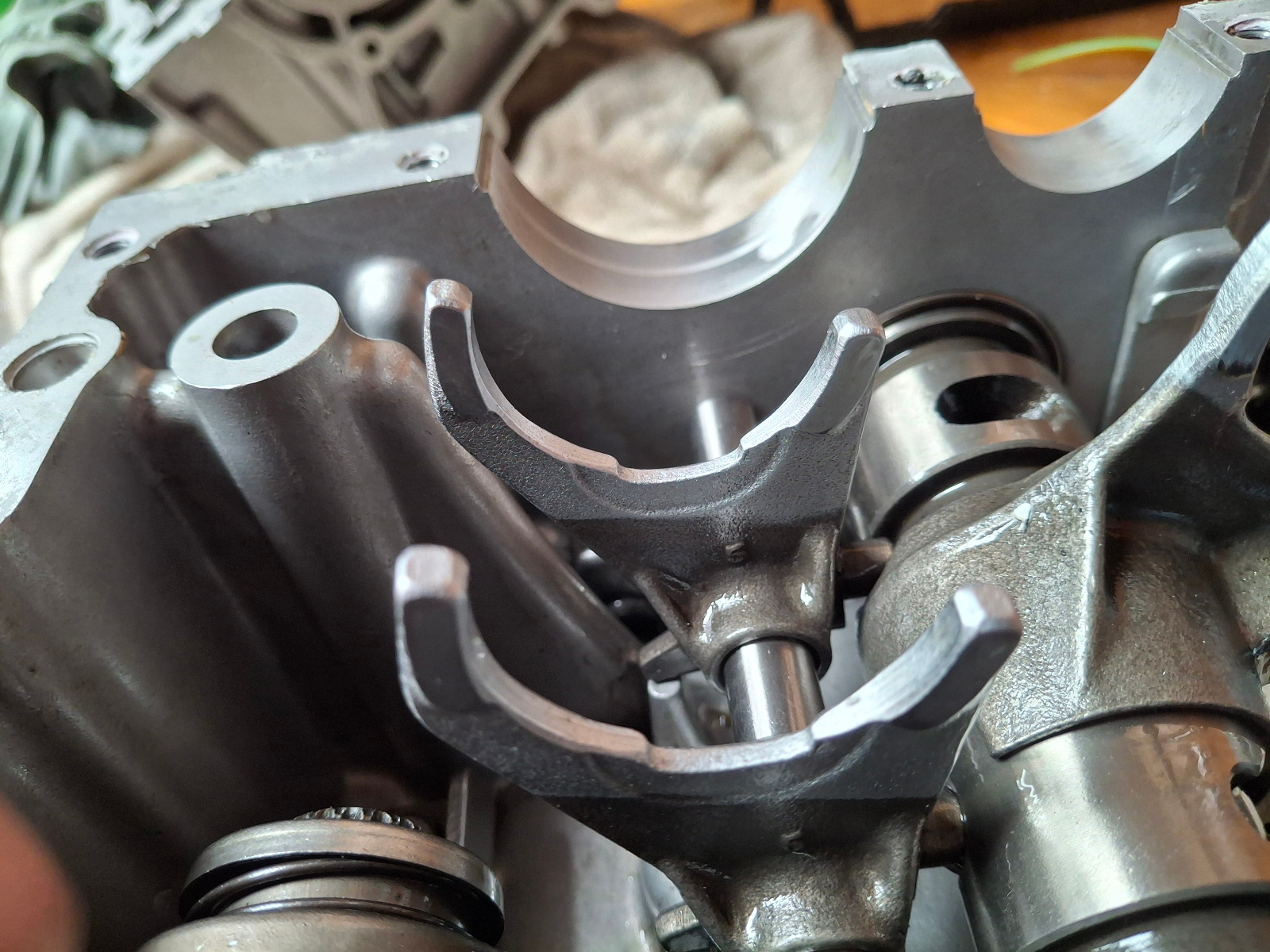

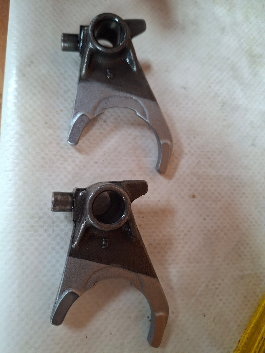

Hi, I am having trouble with the transmission on the KZ650 1979. I am working from a 1977 workshop manual and it is saying that there is a difference between 4th and 5th gear forks. I checked mine out and they are both the same, they are stamped with a figure 5 on each of them.The bike when I first got it from USA rode very nicely and nothing wrong with the gear changes and selecting neutral. Sometimes I can get it into 1st gear and back to neutral and sometimes I can get it into 2nd but not very often. Just wondering if it would be better if the bike was running, but I don't want to assemble it if there is any chance of it not being correct

Looking at CMNSL the selector forks are dependent on model and year, some have two different forks and some have two the same. I guess ultimately if it selected ok before strip down then I don't think the forks are an issue. There is no syncro-mesh in these transmissions so if the engine and trans are stationary then it's normal that it can't select gear unless the engagement dogs are aligned.

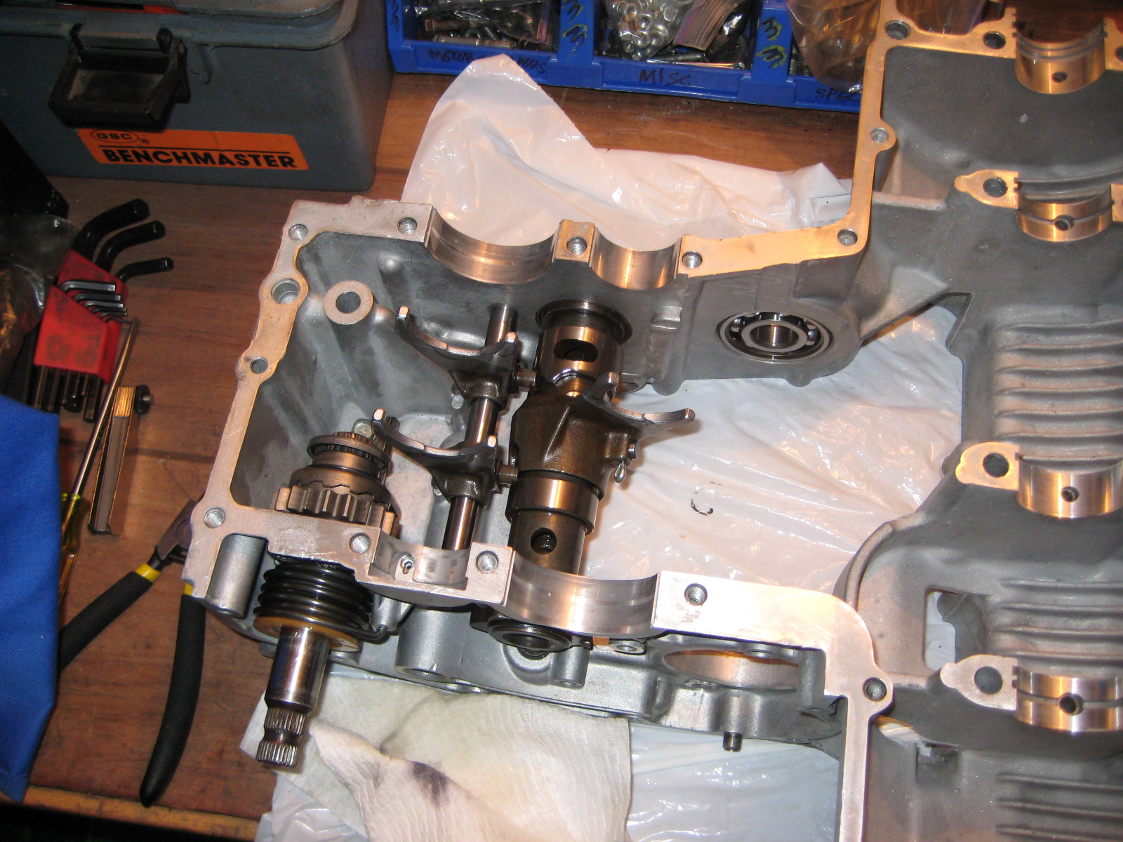

On this rebuild of a 1978 model the shift forks were the same :
I only have one 1977 model year engine but the bottom end is not split so I could not tell you if it has the two different shaped shift forks.
This may be something that Kawasaki moved away from because it was not necessary and possibly confusing. First model year bikes always seem to be unique in the parts selection and mostly goes away in subsequent years for cost savings or simplification.
