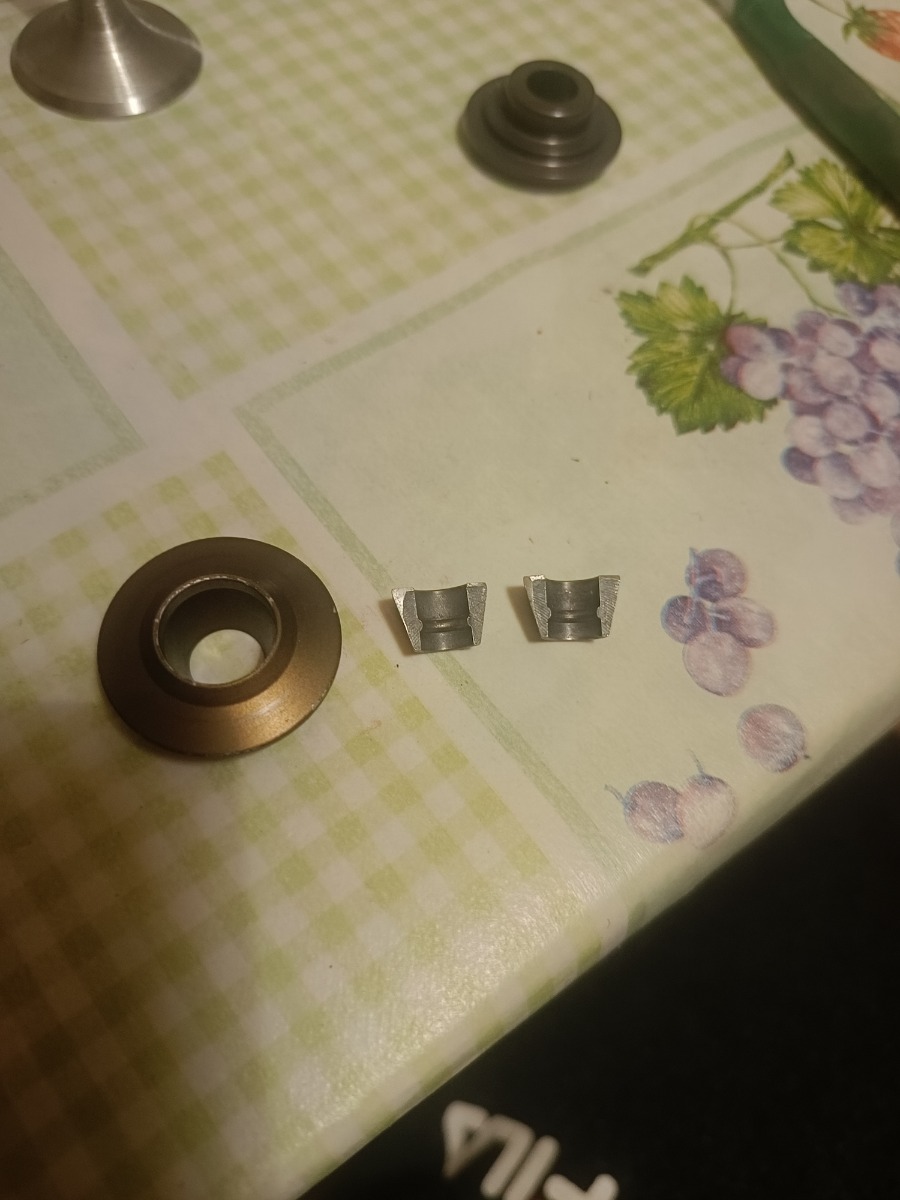

Hello everyone! While sorting through some old junk, I came across these aluminum valve spring retainers. Does anyone in this esteemed community happen to know which springs or what lift specs they are designed for?
- asphalt900
- Posts: 1964
- Thanks: 1321
Re: aluminum valve spring retainers
26 Sep 2026 03:52
Look like pedestrian KZ650-750 SUB collars. Have you tried a correct shim to make sure it fits correctly? I wasn't aware these were available aftermarket but i don't do the smaller 650ish stuff? I see in the background you have what looks like an original steel one, just compare. They won't be stronger, just lighter.

I have some exactly the same with the matching wider angled collets from the Orient Express drag bike.
They fit Z650 through to GPZ1100.
You can use any cams or springs you like but they are meant for racing only and very frequent inspections for wear and cracking etc..
I opted to replace them with titanium ones for the rebuild as does everyone now so really only a vintage race item suitable for display .
Off the top of my head ally retainers were made by Web Cam, Denco and Yoshimura.
The following user(s) said Thank You: Dragbike_Mike, v.f.

Thanks for the reply, but it is specifically the aluminum valve spring retainers (and keepers) that differ from the standard ones—and they are very lightweight. I’m specifically interested in which valve springs can be used with them. 🤷🏼

Zed, thanks a lot for the reply. Great stuff, as always. 👍🏻 I have titanium retainers too, but these are definitely much lighter. I suppose they can be installed on a GPZ1100 camshaft using the stock springs? I won't be using them with .440" lift springs. Also, could you tell me what the compression ratio is on your bike with the Andrews cams?

I would only use those for display.
Titanium is the only answer for a upgrade
The following user(s) said Thank You: v.f.
- zed1015
- Posts: 3371
- Thanks: 2080
26 Sep 2026 10:51I wouldn't use them in any engine now but if you did they would need inspecting very regular and i don't mean every few hundred miles but after every run or race..Zed, thanks a lot for the reply. Great stuff, as always. 👍🏻 I have titanium retainers too, but these are definitely much lighter. I suppose they can be installed on a GPZ1100 camshaft using the stock springs? I won't be using them with .440" lift springs. Also, could you tell me what the compression ratio is on your bike with the Andrews cams?
You should put them on the shelf and use the titanium ones.
Non of my current bikes have Andrews cams.
They are Norris 407's and Kent 410's in the normally aspirated ones with 10.25 :1 comp and GPZ1100 Unitrack cams in the supercharged and Turbo bikes with 8:1 comp.
