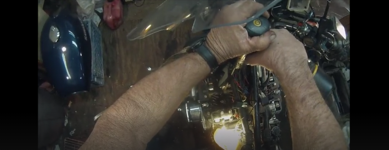

I like the idea of pulling the engine out or you can go through this.
rumble.com/v26fram-getting-the-bolt-out.html
rumble.com/v26i5ns-drilling-the-bolt-out.html
