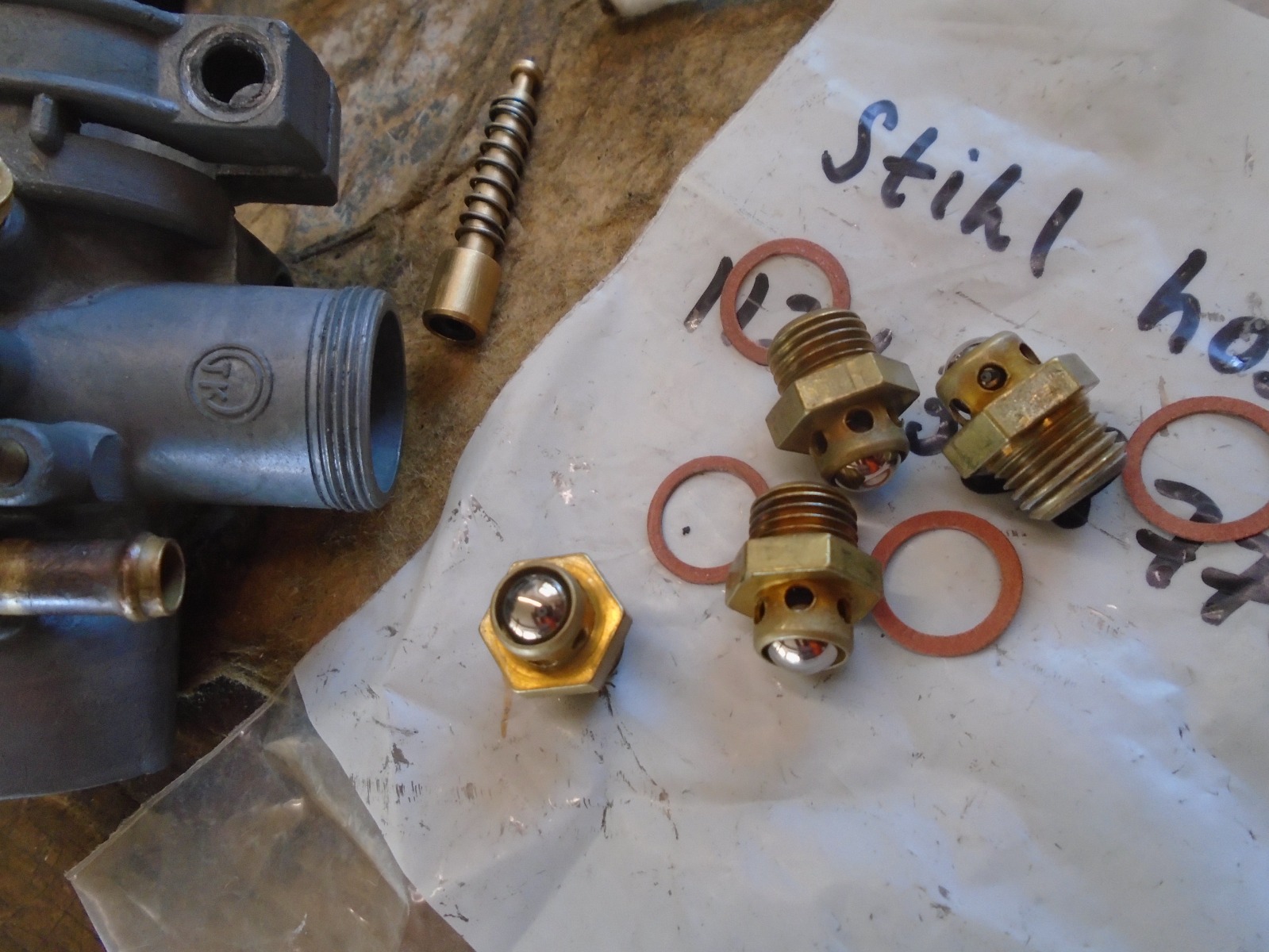

Here's a blast from the past Zed, remember these? Have had a couple friends bring me these Big ball/small ball replacement float seats. Sporadic sealing at best, sometimes/maybe/never ha. Came out in the 1980s and offered for cars and bikes. Actually pulled a set out of a Lancia carb set before replacing immediately. Noble concept but real world failure was imminent
- zed1015
- Posts: 3366
- Thanks: 2075
Re: Z1 plunger replacement
06 Sep 2026 09:08Remember them !Here's a blast from the past Zed, remember these? Have had a couple friends bring me these Big ball/small ball replacement float seats. Sporadic sealing at best, sometimes/maybe/never ha. Came out in the 1980s and offered for cars and bikes. Actually pulled a set out of a Lancia carb set before replacing immediately. Noble concept but real world failure was imminent
I see them fairly regular especially in the vintage S&S Super B carbs that come attached to some Rajay turbos.
The ball is usually plastic in those.
I also get plenty of plungers in with bent needles and have become quite adept at tweaking them straight without a thought as part of the refurb process and now have a couple of dedicated tools for the job.
