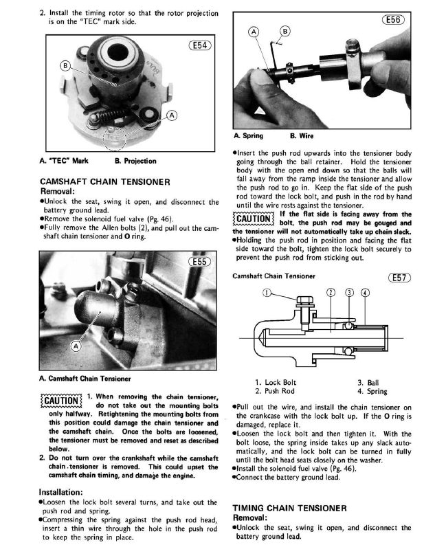

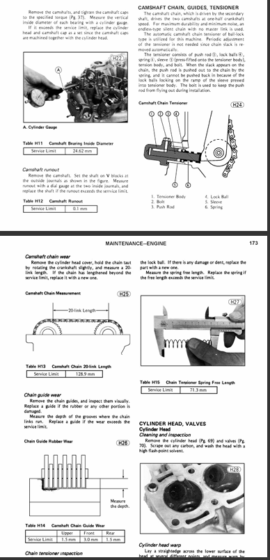

- Posts: 8403
Re: KZ1300 cam chain tensioner won't go back in
13 Aug 2026 12:28
- detmeyer
- Posts: 36
- Thanks: 6
14 Aug 2026 07:37 - 14 Aug 2026 07:41
"...and one day, I'll be dead yo yo yo."
Last edit: 14 Aug 2026 07:41 by detmeyer.
- Posts: 8403
14 Aug 2026 10:48
Different part of the manual. What I posted is from the Disassembly section.
