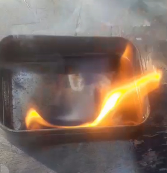

Are you sure its been over filled and you haven't left the fuel tap on on or prime and filled your gearbox with petrol?
if it is petrol/oil mix then running that engine will wash the bores instead of lubricating them. Your bores and rings will be destroyed in very short order if so.
drain some out into a tin. Put a blowtorch on it. If it catches alight it has petrol in it and needs to be drained and replaced immediately.
