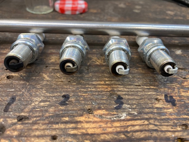

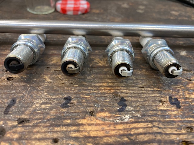

I replaced spark plugs yesterday, prepping the bike for a trip to Gettysburg bike week. During a 3 mile test ride, the bike idled poorly and stalled out twice. I checked the plugs, and #1 was black. I decided to put the old plugs back in, went for a short test ride and once again, poor idle and #1 plug is carbon fouled black. Resistances through plug caps, wires, and coil is good. #1 plug is giving a crisp blue spark.

Well it doesnt seem like ignition is a likely issue. Im assuming you sorted through the carbs and whatnot. Did you check compression, valve clearances, or look for evidence of burning oil? The fact that plug 2 also is a little dark leads me to believe that it could still be a carb issue.

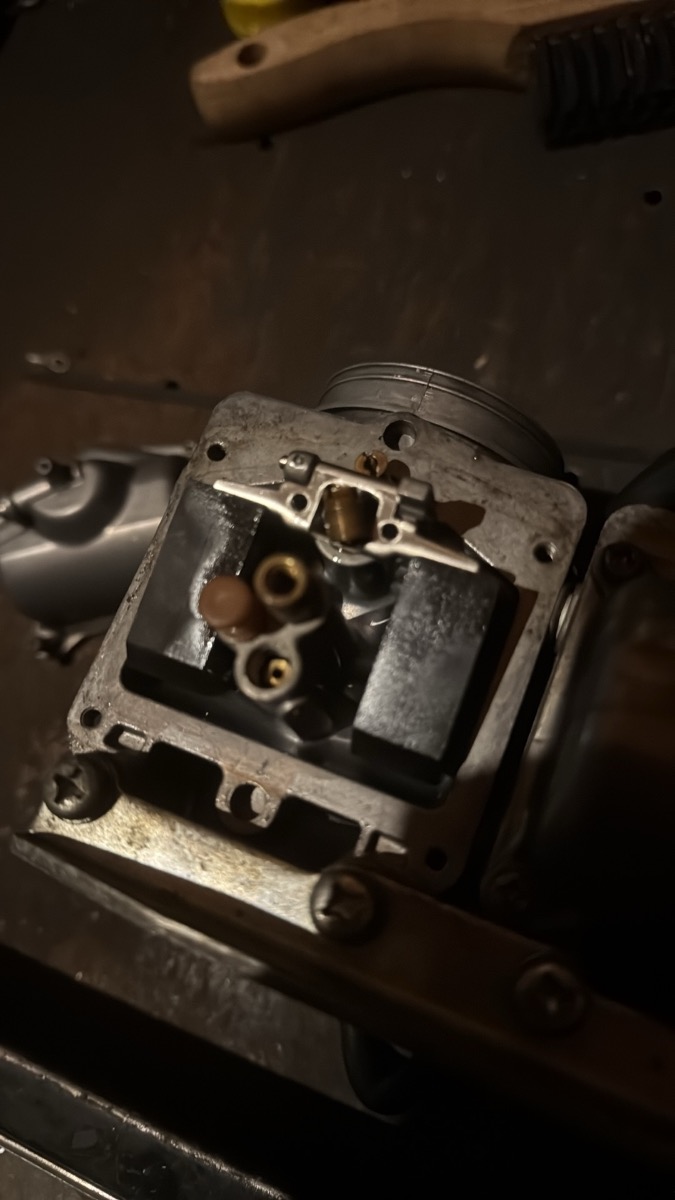

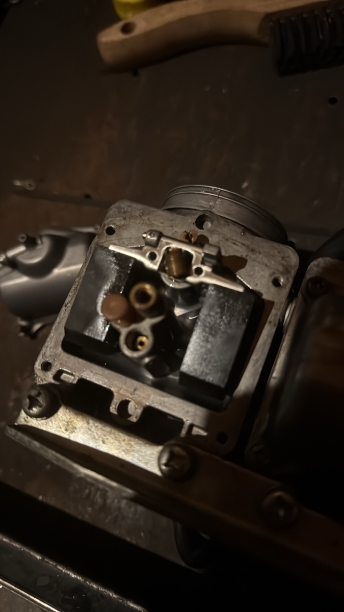

Today, I tested the vacuum petcock on the ZL600 by pulling vacunm with a syringe. After holding vacunm for a few seconds. fuel started flowing into the air box. Looks like carb rack will have to be pulled and sorted out on the work bench.

That'll do it. You can probably assume that one or two of the float valves arent sealing for one reason or another.

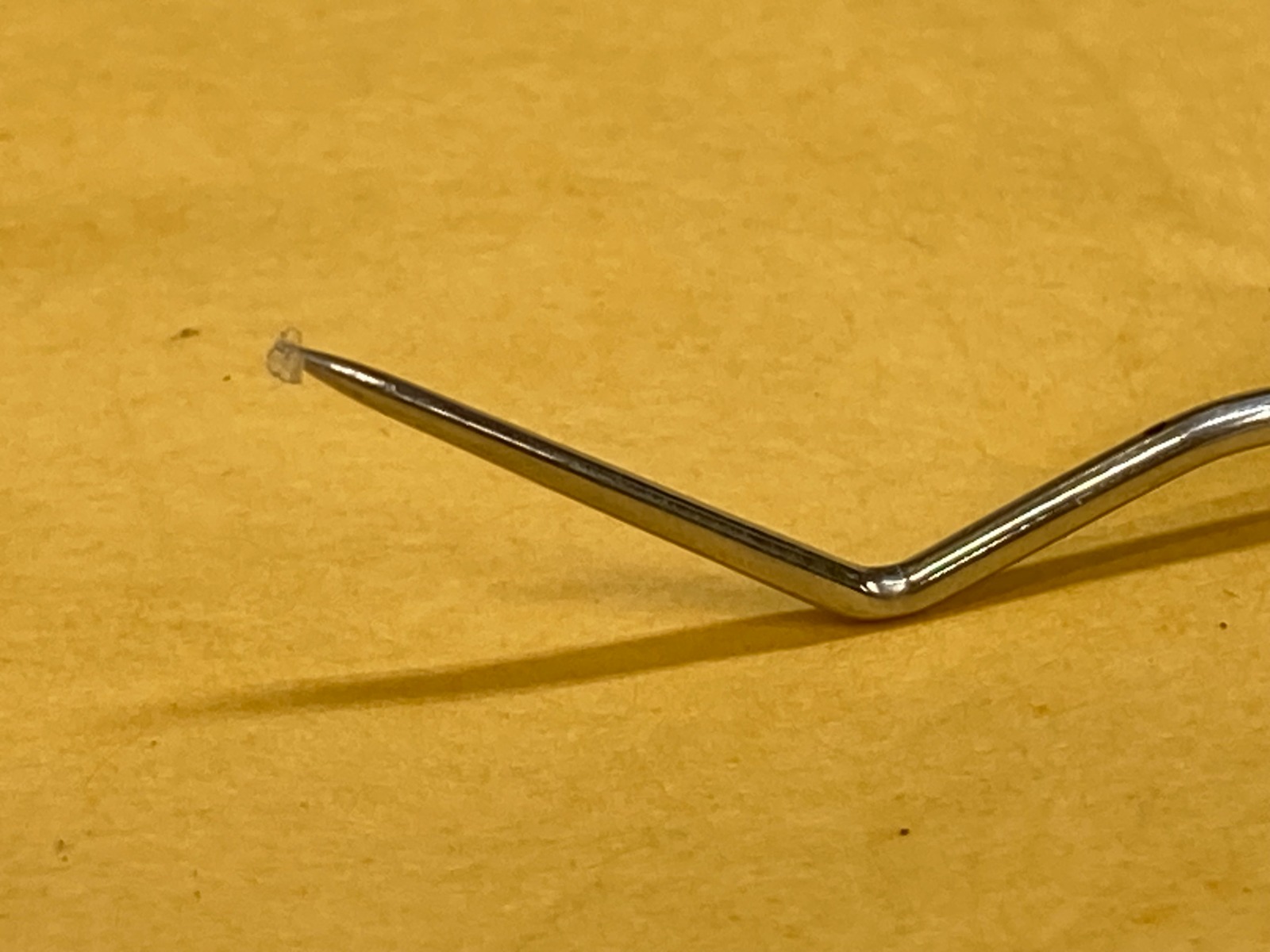

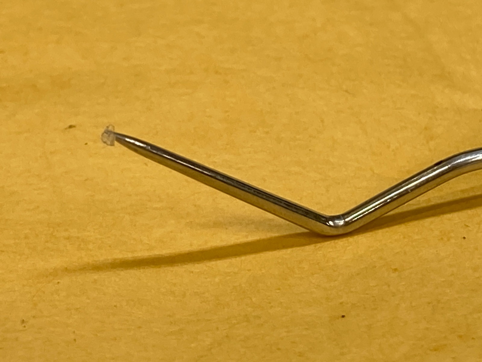

Here's what I found in the float valve of #1 carburetor. It is soft and semi-transparent, probably a bit of silicone sealant. I think I'll be adding an inllne fuel filter.

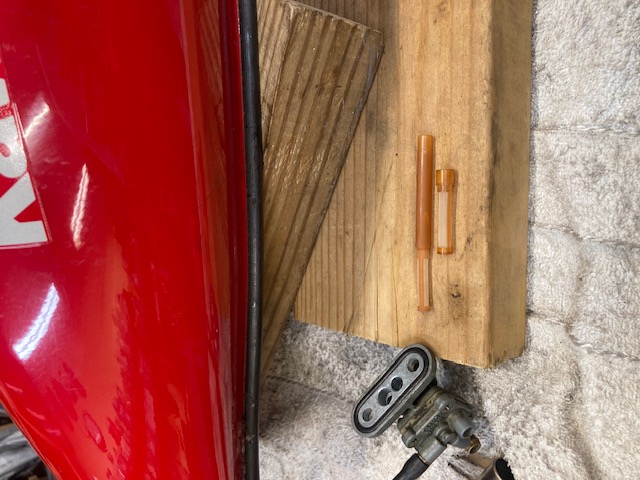

I found out how crud was getting ro the carbs. The petcock was missing its filter screens. I found them in the bottom of the fuel tank. When I reinstalled them in the petcock, the fit was not tight and I could see them falling out again. I glued them in with fuel resistant gasket maker and will let that dry a couple days.
