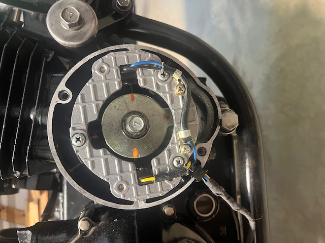

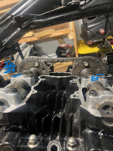

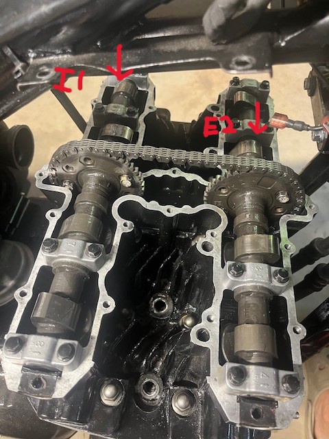

Been rebuilding this 1985 zx550A. The entire engine has been taken apart and put back together. When i try to rotate the engine with the cams in it stops at 2 places. Heres some troubleshooting ive done so far.
-No bent valves. I pulled the head after this condition to make sure again after this.
-Timed the cams according to service manual and louds graphics.
-engine rotates freely with cams removed so i think bottom end is fine
-Checked valve clearances for each valve. All meet the minimum clearance so its not a lack of clearance.
-Ive removed the tensioner and still experience this condition while rotating with hand pressure keep the chain on the sprockets.
-Everything is oiled with a light coat of oil and the caps are torqued to spec in order of service manual

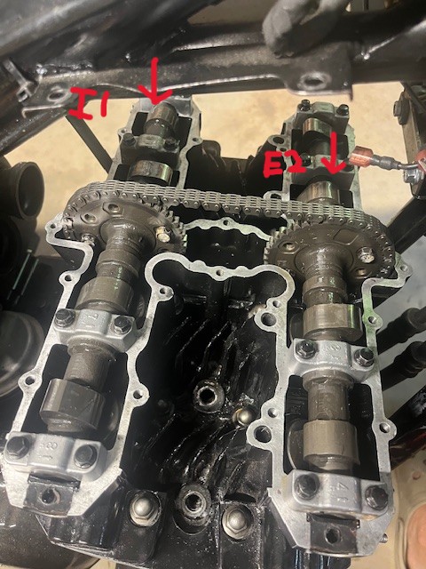

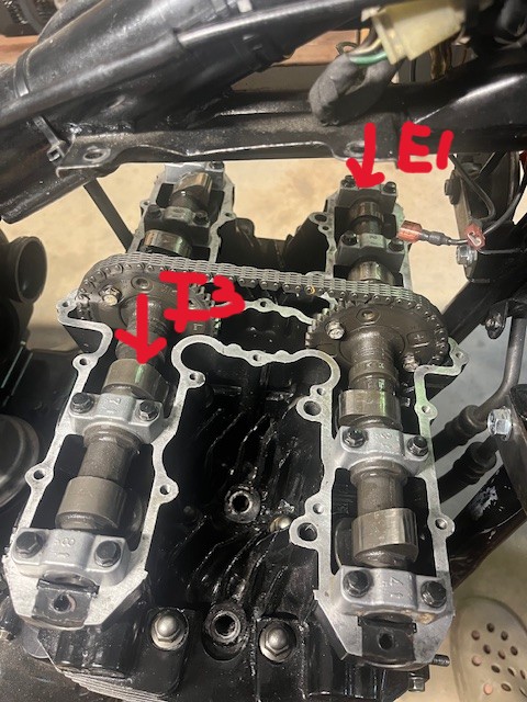

-It stops at the same two spots every time. (Intake 1 and Exhaust 2 depressed / Intake 3 and Exhaust 1 depressed).

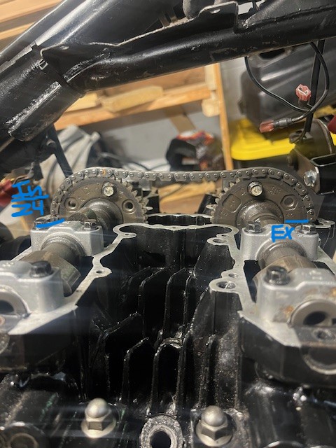

Ive included pictures of my cam timing and of the positions of everything in these two spots. Let me know what you think im kindve lost.

You show multiple “timing mark” pics as far as I can tell. The cam lobes for #1 are typically facing directly toward each other when 1&4 are at TDC. It’s really hard to tell from your pics is that’s the case.

The lobes on #1 can also face away, as that would be the compression stroke as the exhaust lobe would be close to opening the valve.

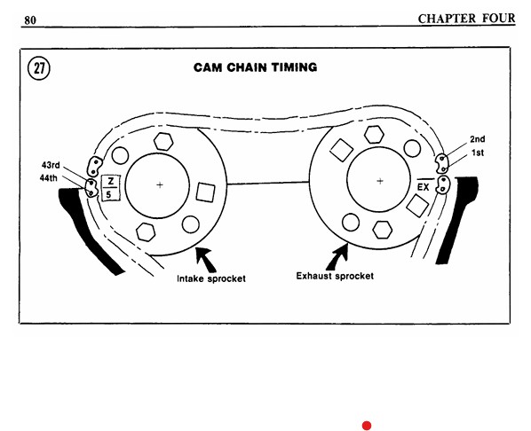

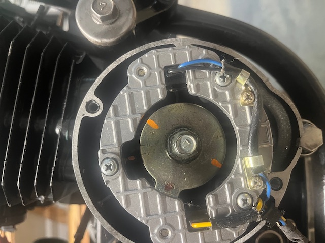

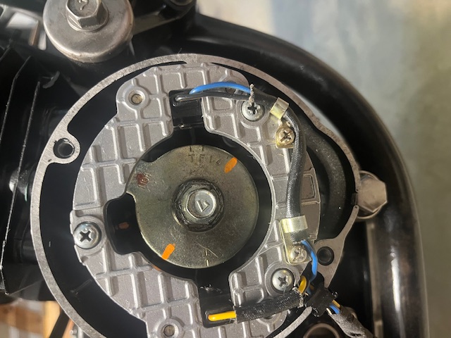

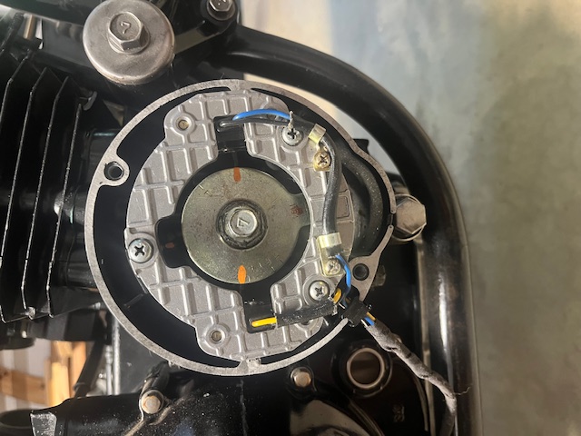

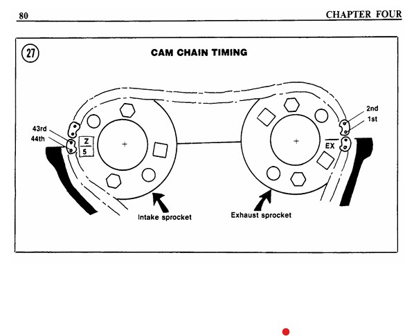

Streetfighter, the order of the pictures came out alphabetical instead of sequential of upload i think. So picture 1 shows the cam position i set them at with the timing plate showing TDC "T" lined up with timing mark. Picture 5 the position of the timing plate when i set the cams (TDC). The other pictures show the cam lobe conditions when it locks up.
Wookie, confirmed pin count. The z4/in line is between pins 43/44 as seen in picture 1 i posted.
Hugo, no its locked at those points. Plugs are removed and it moves quite freely before those points. I have rebuilt this same model of engine before but im unsure where to look next. Guessing this has to be a timing issue.

I found the issue. Figured id post in case someone runs into same issue. When i said timing plate before i was referring to the Rotor, Pulsing Coil (21007-1104). Well, the 4x8mm tension pin (555A0408)
that connects the crankshaft to the Rotor, Pulsing Coil broke off, so I was setting cam timing while the lower end was oriented correctly. Retrospectively I should have probably looked inside the cylinder to confirm top dead center. I found a drill bit that fit snuggly into the hole and cut it to 8mm, rotating fine now.
