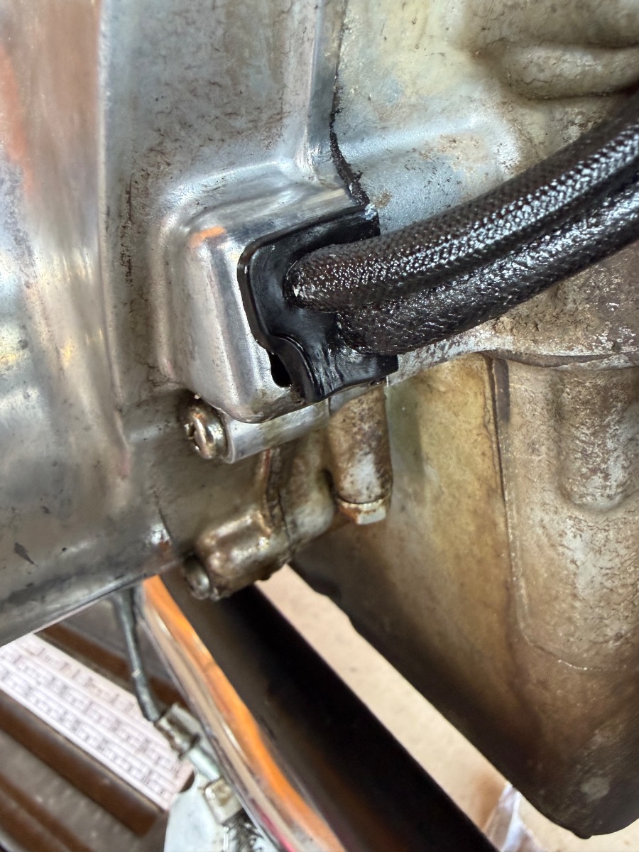

So I was wrong (nothing new there). The leak is actually coming from the grommet for the two wires that lead into the stater cover. Why would there be oil in there?

To cool the generator.
