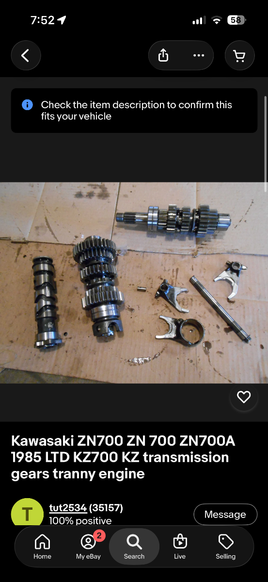

What should I look for in terms of parts and gaskets? Can I swap in a transmission that doesn’t do 5500k rpm at 70? Are there mechanic’s manuals that tell me how to help the transmission? I see there are whole used transmissions on EBay for ~60$.

I suggest you have somebody with experience carefully check the new transmission before installing it. What usually goes bad are the shift dogs, not the teeth on the gears. The more rounded the dogs get, the less able the gears are to stay engaged.
All of the transmission gears are always engaged with their partner on the other shaft. The dogs and slots on the sides of the gears determine which pair of gears are transmitting power at any given moment.
Yes, it is possible to explode a gear with enough abuse, and it more often than not will be second gear. However, a transmission that at first glance looks ok may have dogs so badly worn that it cannot stay in any gear.
An inspection may save you another tear down.

As for the dogs, anything would be better than what I have at this point. The ZN stopped going into 2nd gear at all. I’m draining the oil out of it this weekend and I’m guessing I will find whatever was left of 2nd gear in there.
The gearbox has ~15k miles on it and looks pretty much brand new. There is zero rounding on the edges of the dogs and the inner catches on 1st and 3rd look fine.
I will listen though, since I have time I’ll go say hi to some of my friends at Retrospeed here in Wisconsin to have a look at it.
