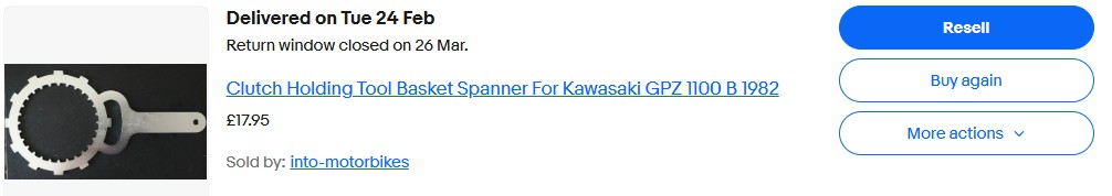

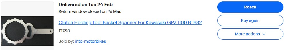

I used one of these on my "J" motor. With it in gear and a piece of tube over the handle I was able to torque up the clutch, generator rotor and gearbox sprocket by holding the trans with this.
