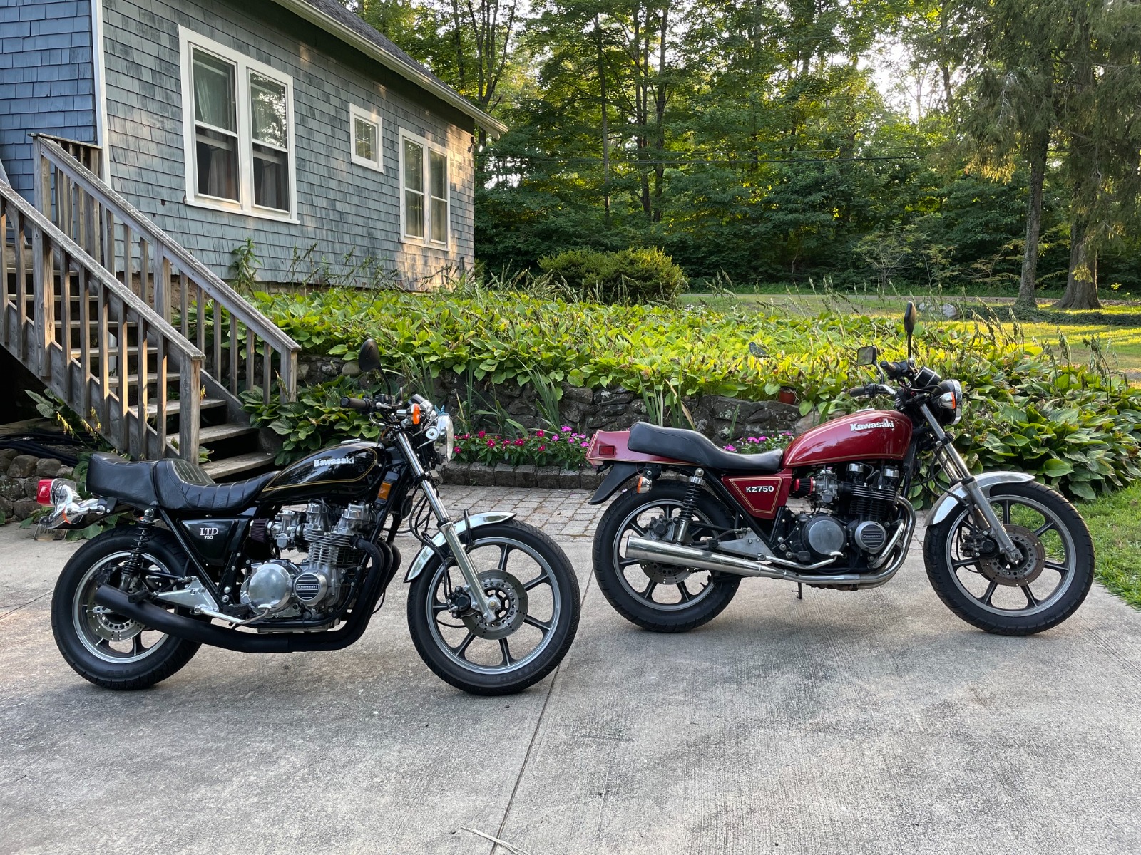

Greetings to all, it has been a while. I have finished my black 1980 750 LTD that I bought from the showroom 46 years ago. I figured since I know how to work on that one, I bought this year the one I didn't buy 46 years ago. This one was surely not cared for as well as the one I bought years ago. It wasn't exactly neglected but whoever work on it was lacking skills and was very adept at using gasket seal, on everything. It did not run when I bought it, but it did turn over and the electrical system seemed to work. I have spent much time cleaning everything including the carburetor's which were loaded with gasket seal.
My issue now is the clutch. I decided that it would be a good idea to, of course, adjust the clutch and lubricate the clutch release lever. The issue here is the push-rod does not push in now. It did when I bought it but it has been sitting now for seven months. Did I pull the push rod out it too far and something dropped in the engine or get mis-aligned? Have the clutch plates frozen? I did turn over the engine a few times through the months. Thanks for the help.

Nice looking pair of bikes.
My first suspicion would be that the clutch plates have stuck together from not being ridden for a while. Be sure the transmission is in gear, pull the clutch lever all the way against the hand grip and rock the bike back and forth. Two or three times usually does the trick for me.
