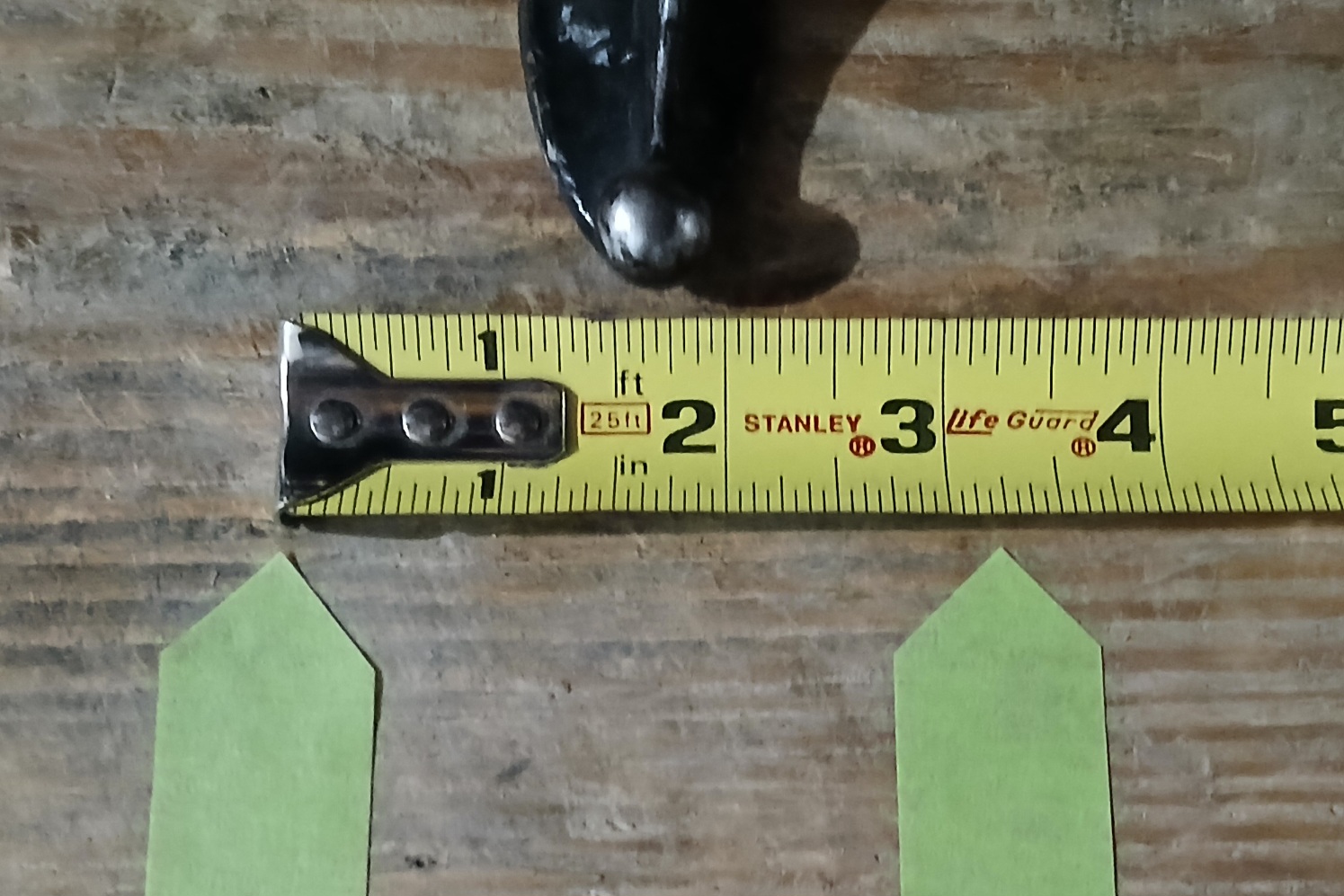

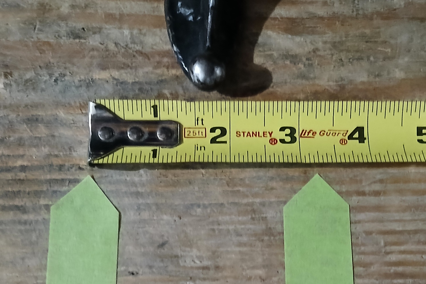

Today I measured the front to back (slack) travel distance of my KZ1100 Shaftie while parked in 1st. gear...
Total travel 3.25"
Total travel 3.25"
