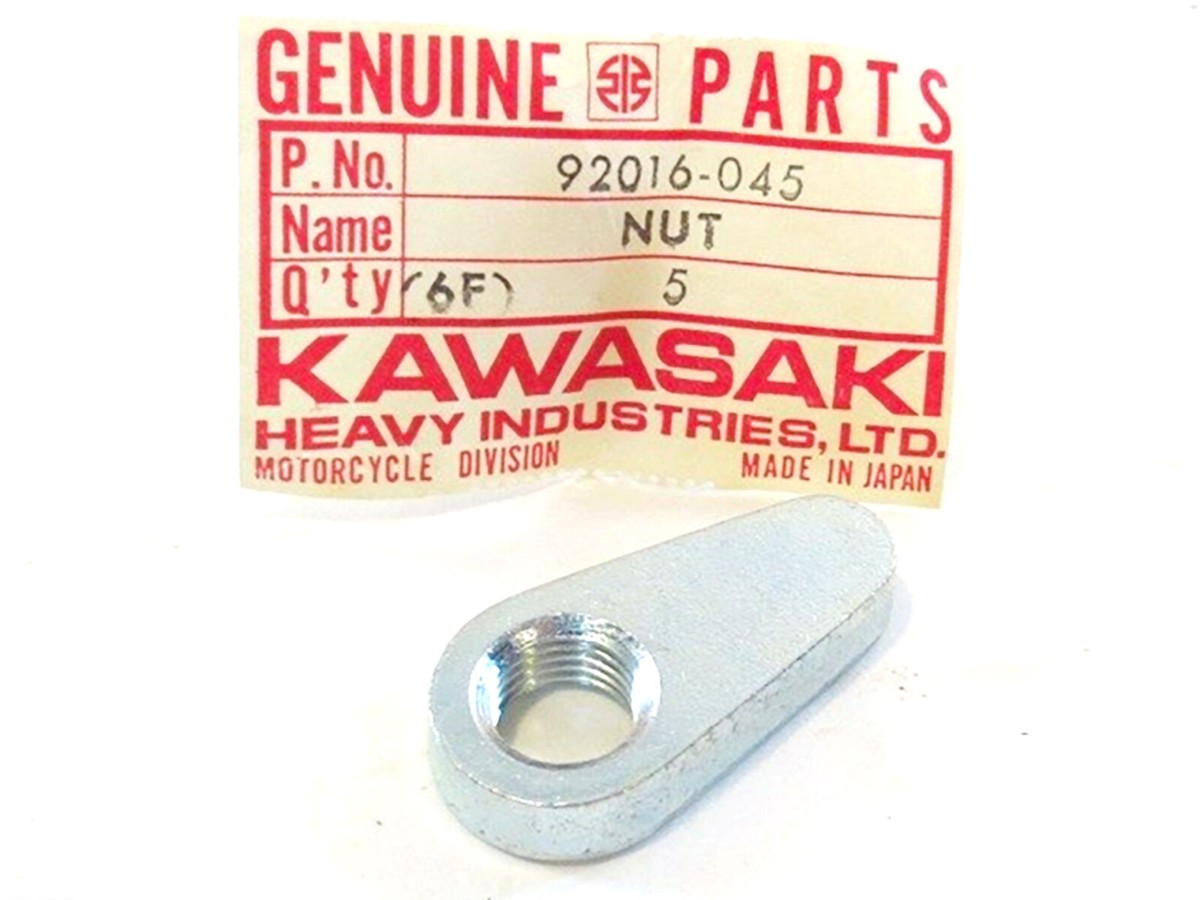

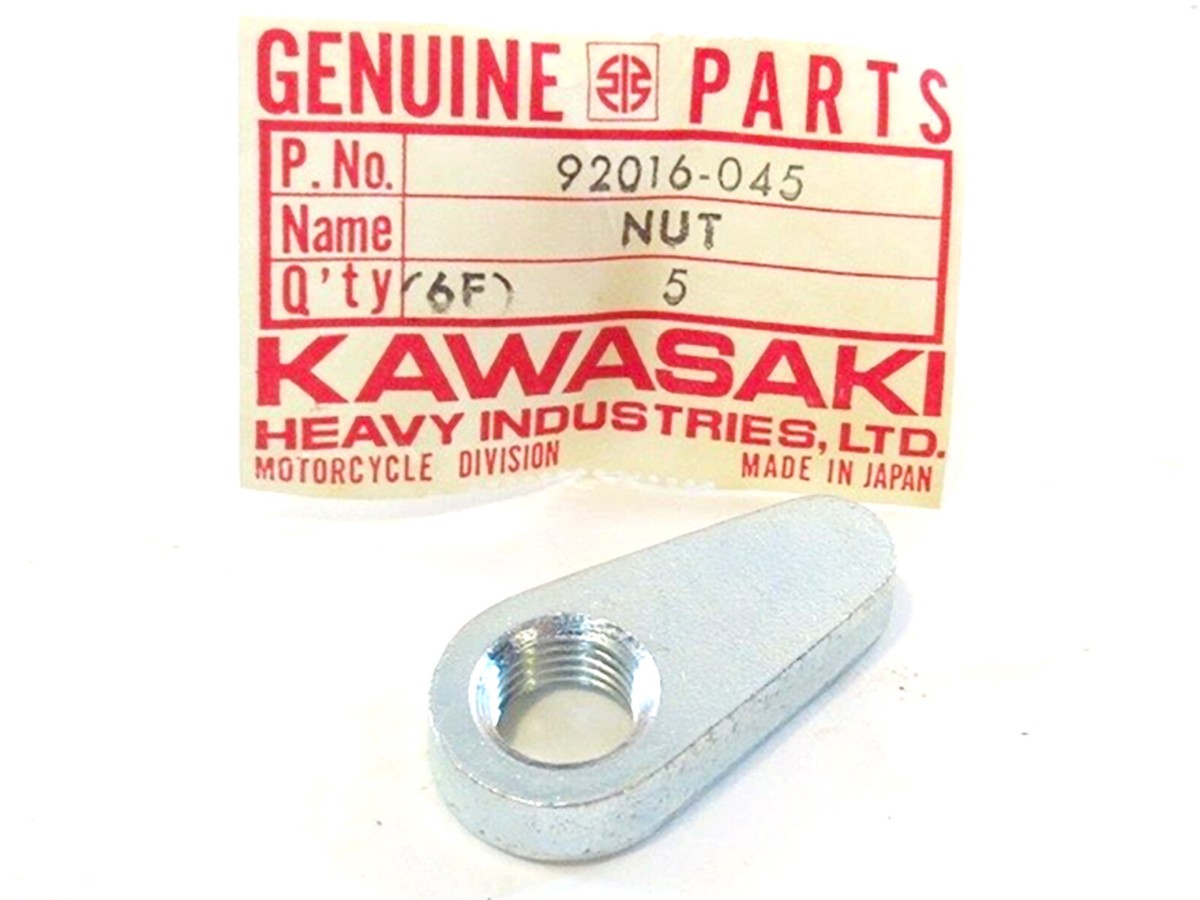

None of the engine mounts on 73-80 Z1/Kz900-1000 engines are threaded.  The lower left and lower right bolts thread into a “teardrop” nut the resides inside a cavity cast into the lower crankcase half.  The nut may have dropped out on you or fell out long ago although, highly unlikely.

   We have mini case guards on all our Z1's. We've never stripped threads on the teardrop nuts.
But...
   The lower case guard brackets are thick enough to require slightly longer bolts when mounting case guards to ensure all threads are engaged in the teardrop, but not so long as to contact the teardrop cavity's other side.
   The ones pictured look to have collars on the lower mounts.  A standard bolt will likely engage few threads in the teardrop.
  One must be very careful when fitting longer bolts on the lower mounts, as a bolt too long will contact the solid side of teardrop's cavity, giving false sense of being tight.  Or, worst case, force it's way well into the case.   There were pics posted here some time ago of exactly that happening.  That's a bad day in the making.
  The cavity in which the teardrop lives is only slightly wider than the teardrop is thick.  If a longer bolt is used, monitor clearance visually from underneath using a mirror.  Use washers as shim, as needed, to prevent the end of the bolt from contacting the case inside the teardrop's cavity.
