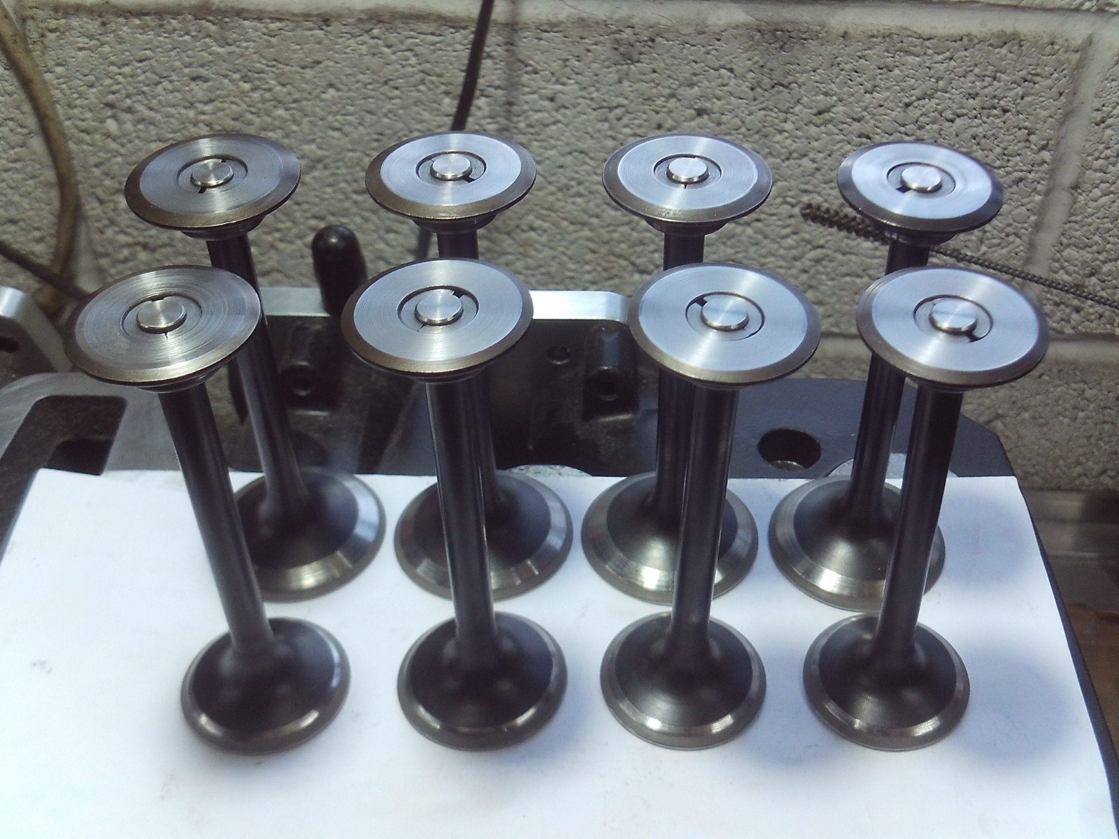

Any 998/1089 J/GPZ head will do the job EXCEPT the GPZ1100 Unitrack and some Z1100 that have the Bathtub combustion chamber with steeper exhaust valve angle which are not immediately compatible with your pistons without modifications.
You can however in shim on top configurations skim a further 1mm from the existing valve stems, collets and retainers to regain the lost clearance and allow the use of shims in the upper end of the range which will give plenty of scope for future adjustment.
I have done this hundreds of times.
This pic is of the last set i did for my own J head that is on my Racecrafters build.

I fit the collets and retainers to a spare valve stem so that it can be held in the lathe chuck and then use the tailstock center to push the valve stem tight into the collets and retainer against the chuck jaws before tightening the chuck.
I have a pre shortened stem and collets for cutting the retainers and another retainer skimmed back around 2mm for trimming the collets so that they can be cut shorter and sit below the surface of the 1mm skimmed retainers..
The following user(s) said Thank You: Dragbike_Mike, Wookie58

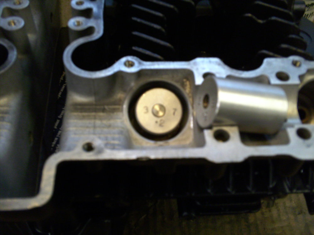

05 Apr 2026 13:00 - 05 Apr 2026 16:11By the book you can only remove .30mm from the stem because you risk the bucket riding on the collets or retainers.Thank you all for your help. I thought that I could only skim only .3mm from the retainer et al. I will be seeing a machinist this week and will ask him about this. I have spare collets and valves, but not retainers. I will keep an eye out for a "P" head.
You can remove up to 1mm (depending on your current stem height) from the collets and retainers to enable a further 1mm to be removed from the tip which will put the stem height back to stock and allow the use of shims in the 300 range.
There is no "book" that will tell you this as it is a modification that goes beyond the normal factory service procedure.
Modifying the collets and retainers does not prevent them from being used with stock uncut valves.
Your machinist will need the head. a 37.2mm stem height gauge ( easily made from a bit of ally bar or brass etc see pic below ) and vernier to measure the protrusion and calculate how much each individual valve can be shortened..
The height gauge is much more accurate and consistent than measuring down the bucket bore with a vernier and make sure it is used against the bare head with the steel spring seat removed.
Any valve lapping or seat recutting should be done before trimming the valves and ideally you should fit 1mm valve spring shims afterwards to retain correct seat pressure.
