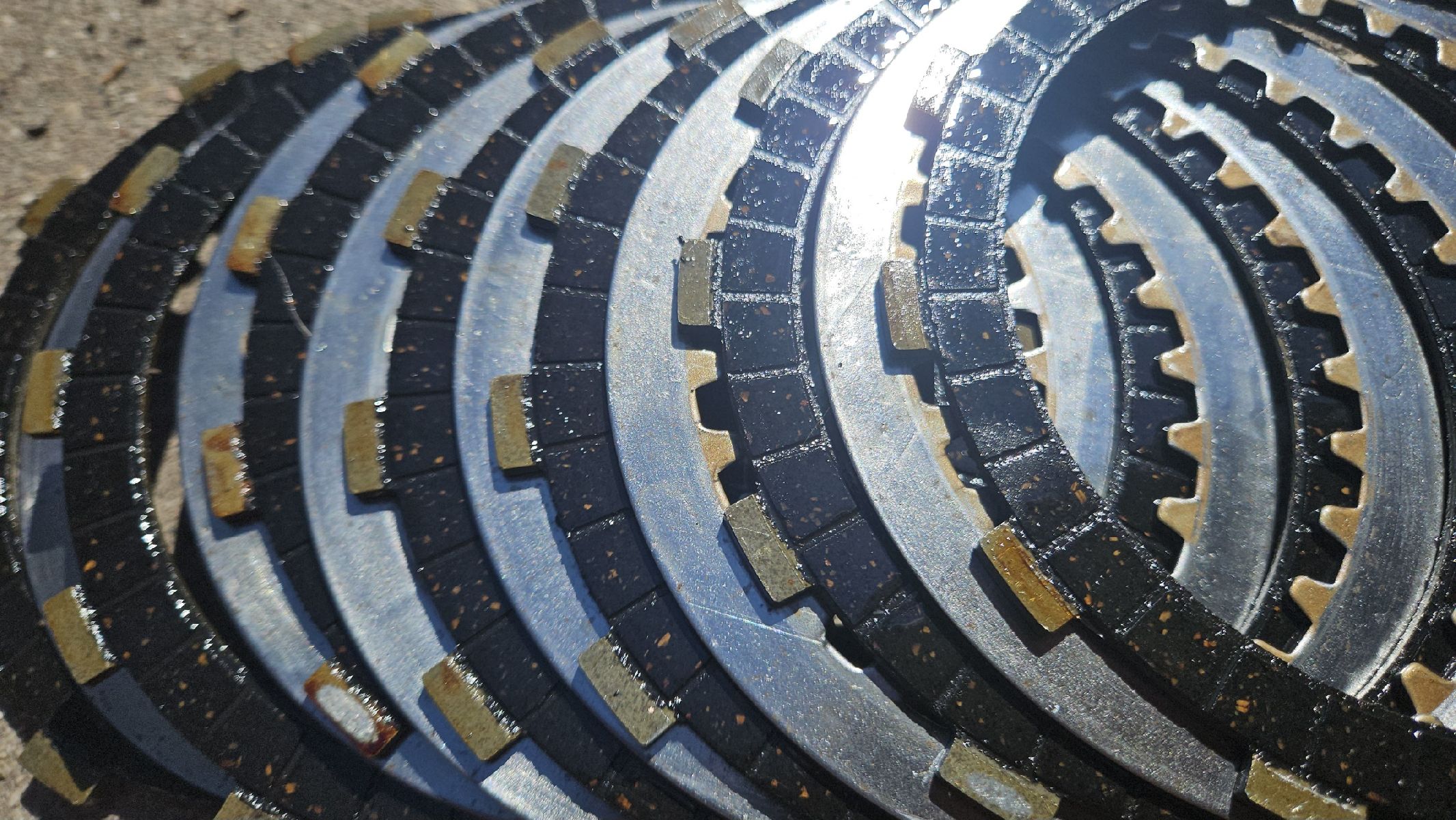

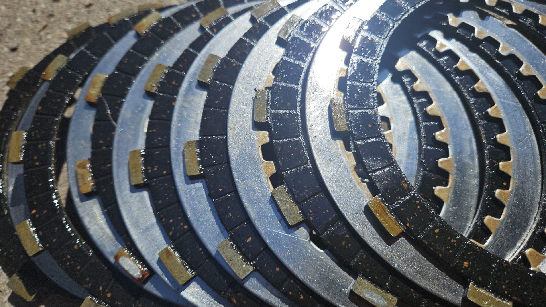

Im still curious though, what was wrong with the other clutch plates? here's a picture of them.

Looking at the deposits on the friction plates they were probably stuck together

I see what you mean. It's weird though because I am positive that they were not stuck when I put it together because I tried to get them on all at once but ended up putting them on individually. Maybe them getting stuck a while ago caused damage?
Well I won't worry about it too much. Im just happy that it was an easy fix. Diagnosis: the friction plates were bad in one way or another!
