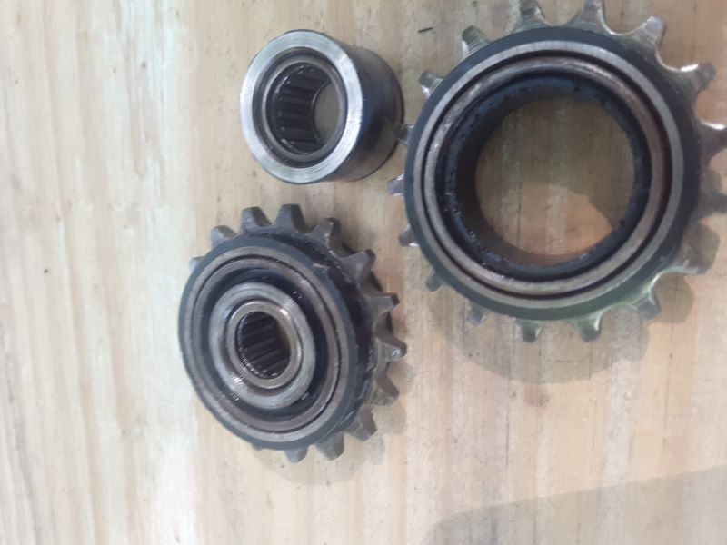

I know it's possible and the "Drawn Cup" bearings are available somewhere but I've never done it. Thinking bearings are 11mm ID, 16mm OD and 13mm length. One of the fella's here does it, perhaps he'll chime in. Take note of condition of your rubber damper vulcanized between bearing holder collar and sprocket first. This is the usual failure point allowing the sprocket to roam free of bearing holder steel collar. Have fun!

As Clay stated, the failure point is usually the rubber damper. Best solution is to convert to solid as zed and others have done or just buy Liska solid billet type sprockets. KZZone, Z1enterprises, and others sell them.
Doesn't make much sense to depend on 50 year old rubber that's been subjected to all those heat cycles...

Perfect representation of failure sf4t7!! I have bags of the same, just can't seem to throw stuff away. I have noted over the years the early "peanut" camchained KZ650's used the same idler gears but had a different Kawasaki part number? All dimensions identical to the Z1/KZ ones but had a different "pin count" of needles in drawn bearing. Z1 had 14 and KZ650 had 16. What do YOU get for a set of 3 solid rebuilt idlers Kevski? Or are you selling them? Seems you're in the states so shipping would be soo much easier. Also, not mentioned NT-NZ, check for run-out of sprocket. Mount it, spin it and watch toothed behavior. Run true or does sprocket wander back and forth?

Yeah, took those out of my hotrod Z1 motor a year and a half ago. Could explain why the timing was a little different each time I checked it, and every once in a while the motor seemed sluggish. Replaced all the sprockets and idlers with APE (liska) billet parts and it goes like a rocket again.
