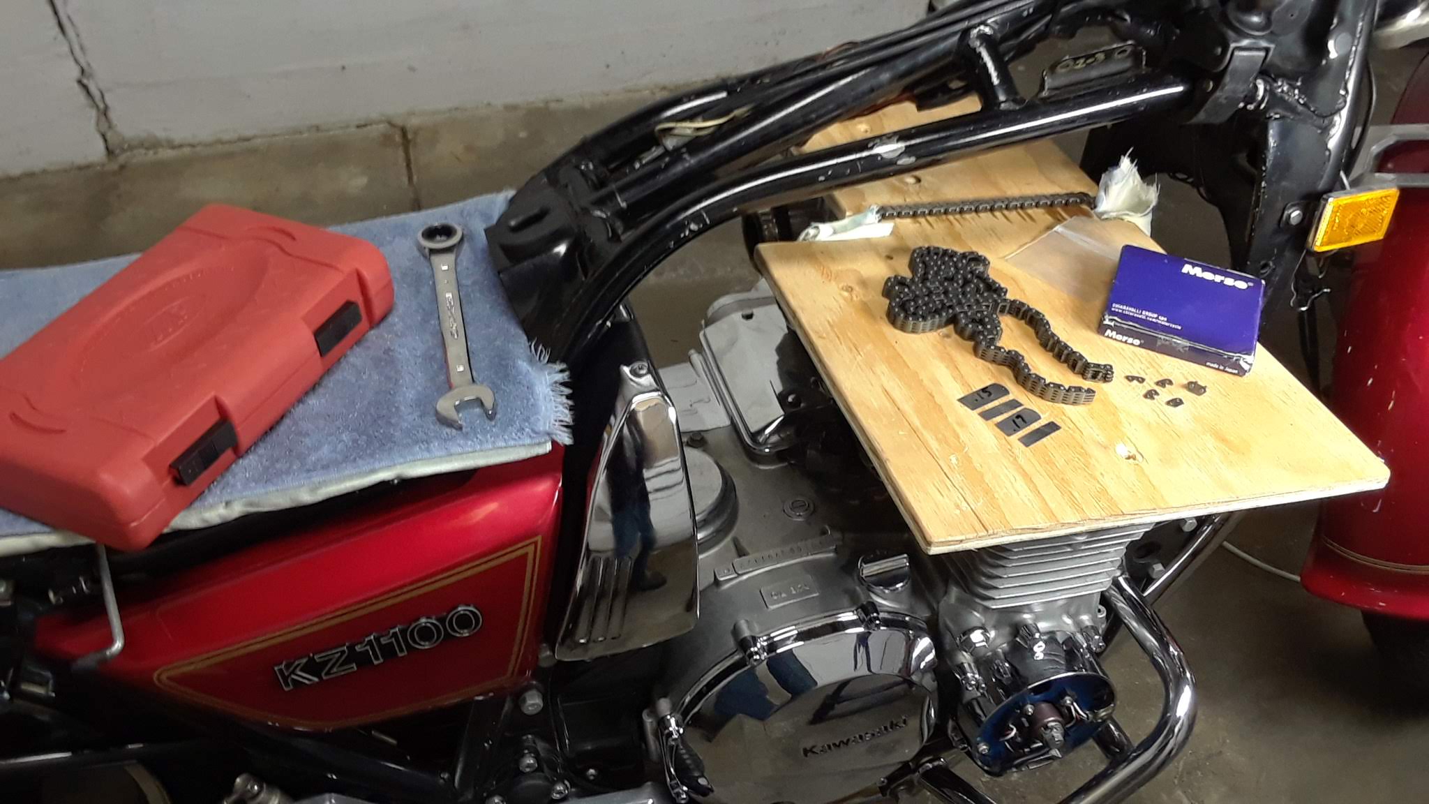

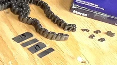

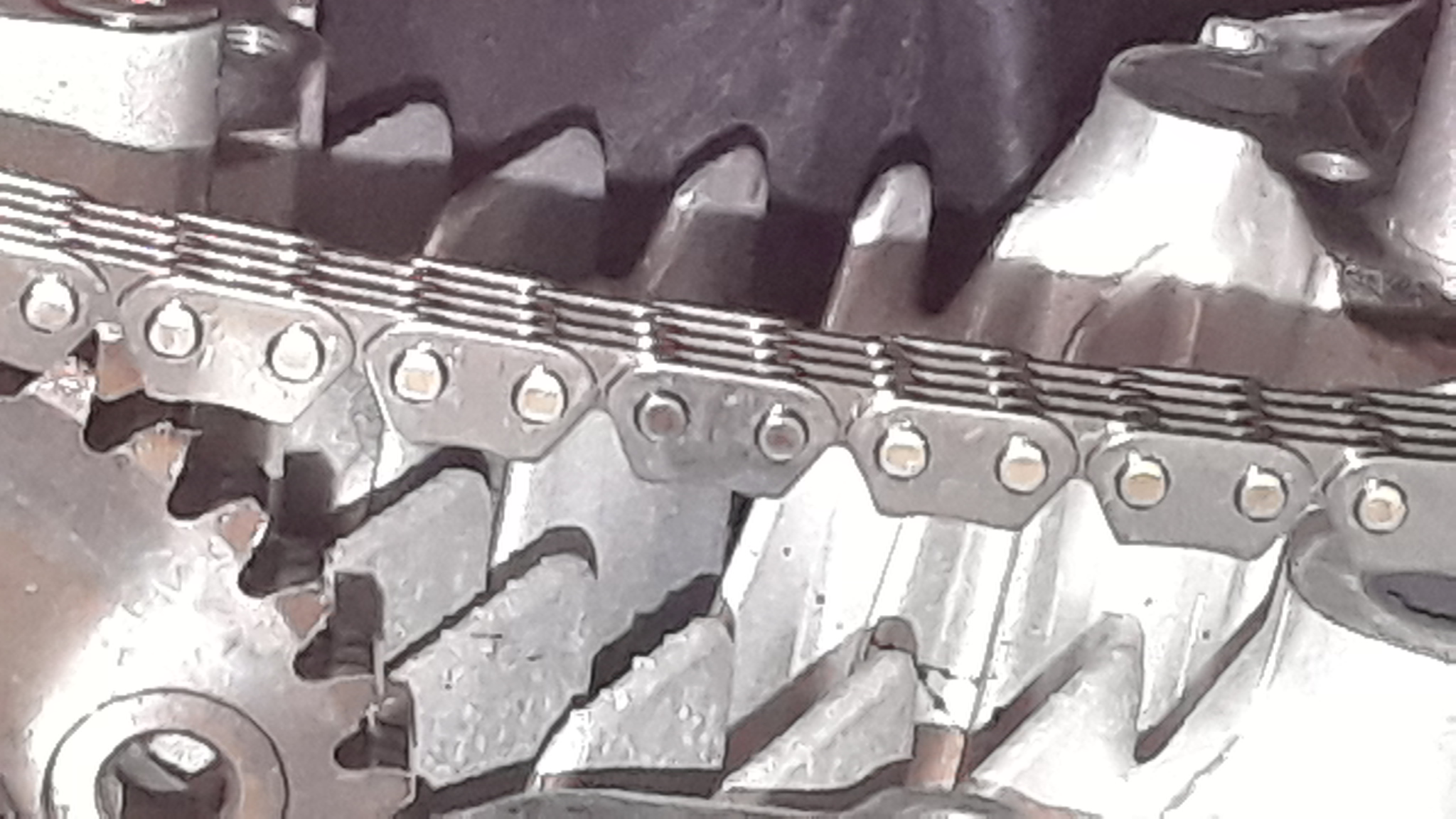

31 Mar 2026 17:31I decided to go with a new chain & master link. I'm having trouble with pressing the master link. I guess the press tool I have is not the best or I'm doing something wrong. When press the link together, it's too tight.Β
Daveo looks like you has great success with yours, what should I be looking at ?
Β
Spacers are needed behind the outer link pieces.
I utilized feeler gauges to measure the gap, and used two that fit tightly after cutting them off from the pack.
Procedure video, while available:
photos.app.goo.gl/cAyyLYXD5zmwQ7w38
