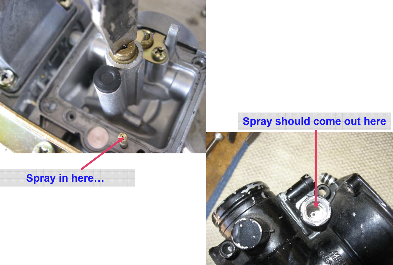

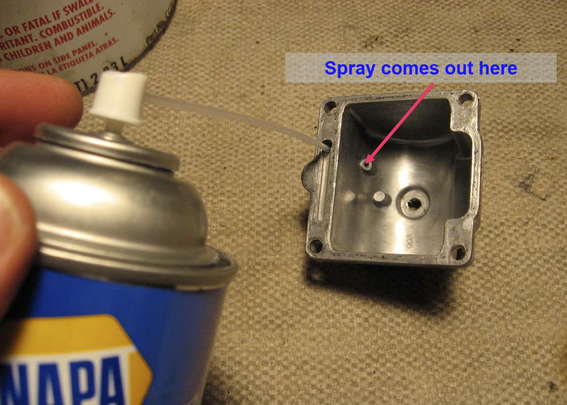

Yes I completely took the carbs out this winter, replaced all the rubber and brass parts. Cleaned it all in ultrasonic cleaner.
the bike was running fine for several months. Until now.
I also tried the kick start and found that it was surprisingly easy to rotate. Shouldn’t the kick be hard?
