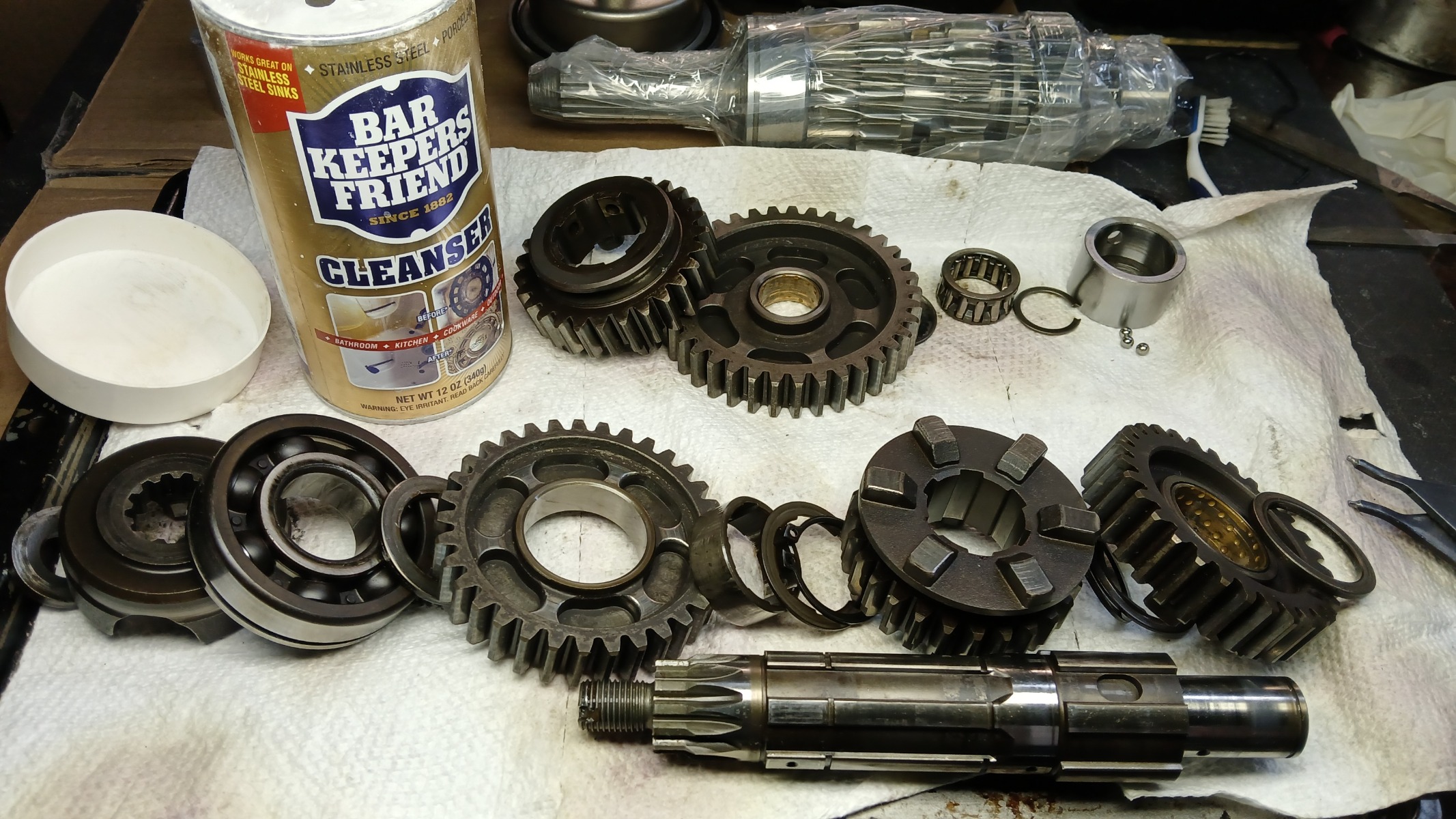

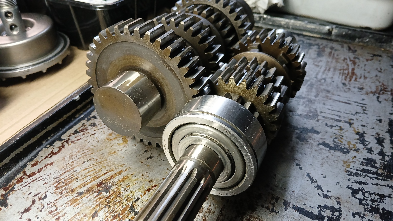

Until recently, my 82 KZ1100 engine was a pile of grungy parts in a plastic tub that sat in the basement for over a year.
The transmission was next after cleaning the case halves, but I needed snap-ring pliers for that.ย Ebay to the rescue!
Used Bar Keepers Friend to remove the dried up old grunge off engine surfaces.
It took concentrated scrubbing and rinsing, followed by WD40 and oil application...
Results are well worth the effort!
Just need a new nut

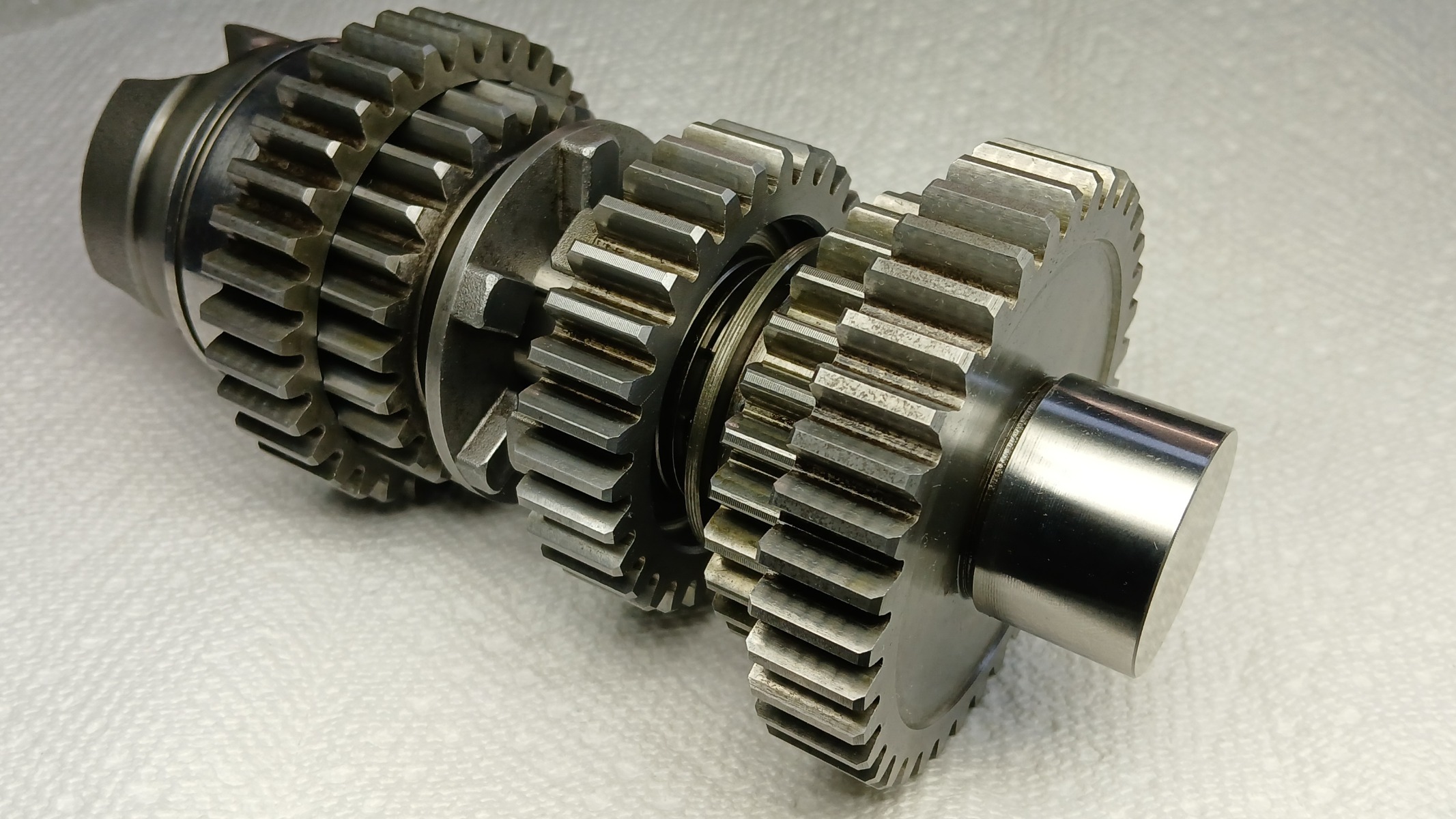

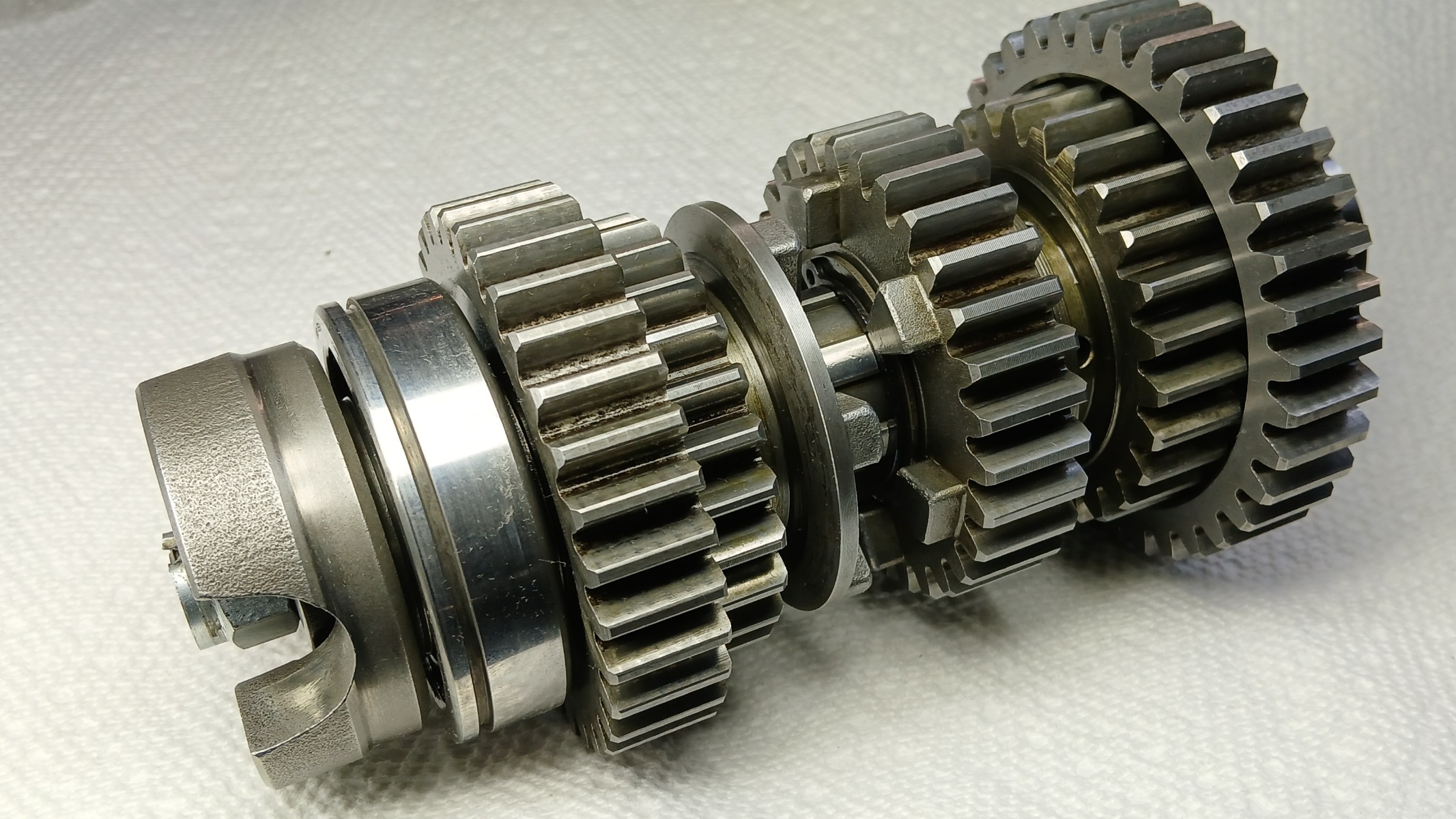

I believe Comet and similar cleansers have bleach and abrasive powder formulas.
BKF uses an oxalic acid polishing powder, when combined with water makes a slurry-paste that helps dissolve greasy grime after it's applied.ย
So the scrubbing is more like gently brushing it around after it sits a few minutes, before brushing/rinsing the solution offย with water in our laundry tub.
Grossness!
And, itย gentlyย cleaned out the old gunk around the balls in these bearings!
