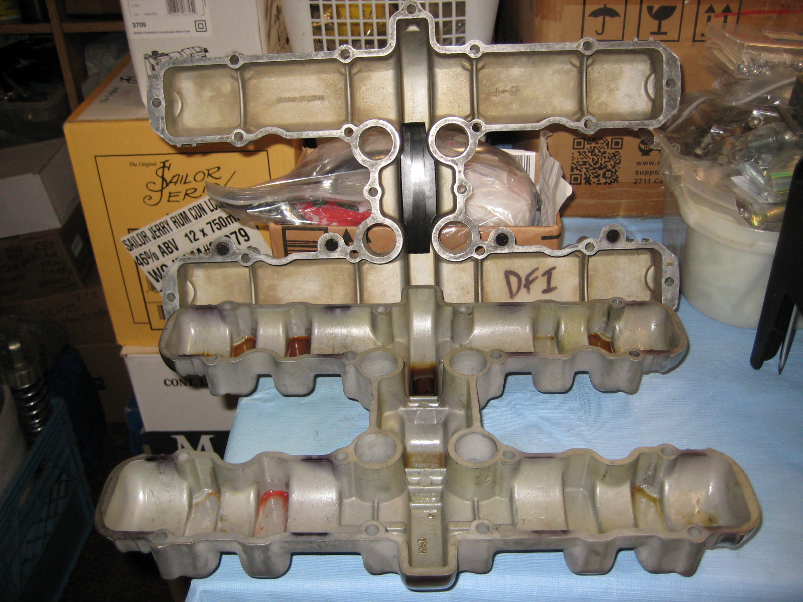

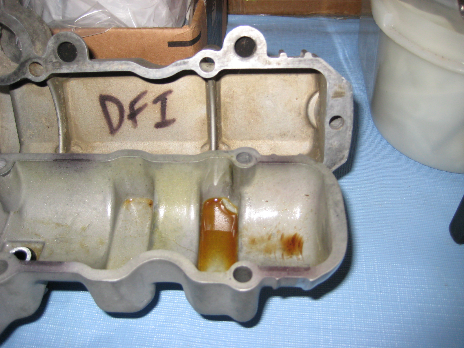

Here is a comparison of the two cam covers :

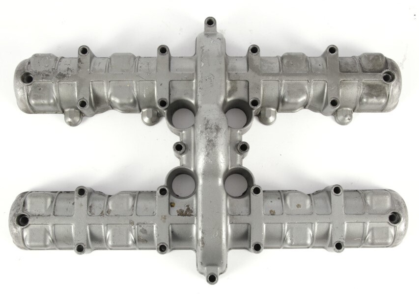

The 650 cover (at the top) is 23mm wider than the Z1 cover plus the bolt holes are way different. Like Zed1015 said the closest thing to a Z1 cover as far as "looks" is the 750 Zephyr cam cover (see below)
