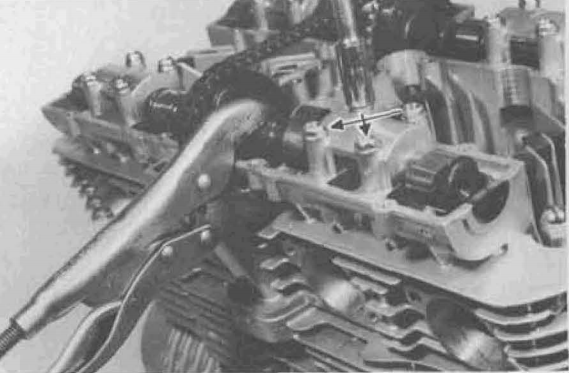

Interesting strategy using studs, If I find my self installing the cams more I will consider that. I saw someone mention a Suzuki tech tip, using vice grips to push the cam down and relieve the pressure from the cam cap when tightening. Would this work on a Z1 (would there even be space to do it)? One thing I hate about cam installs is using the cam cap to push down on the cam. Currently the way the manual reccomends just seems awkward, I feel like I'm damaging something.

The clamp method will work, not quite as controllable as studs for releasing the tension and may leave scratches on the head. Really just a question of preference
