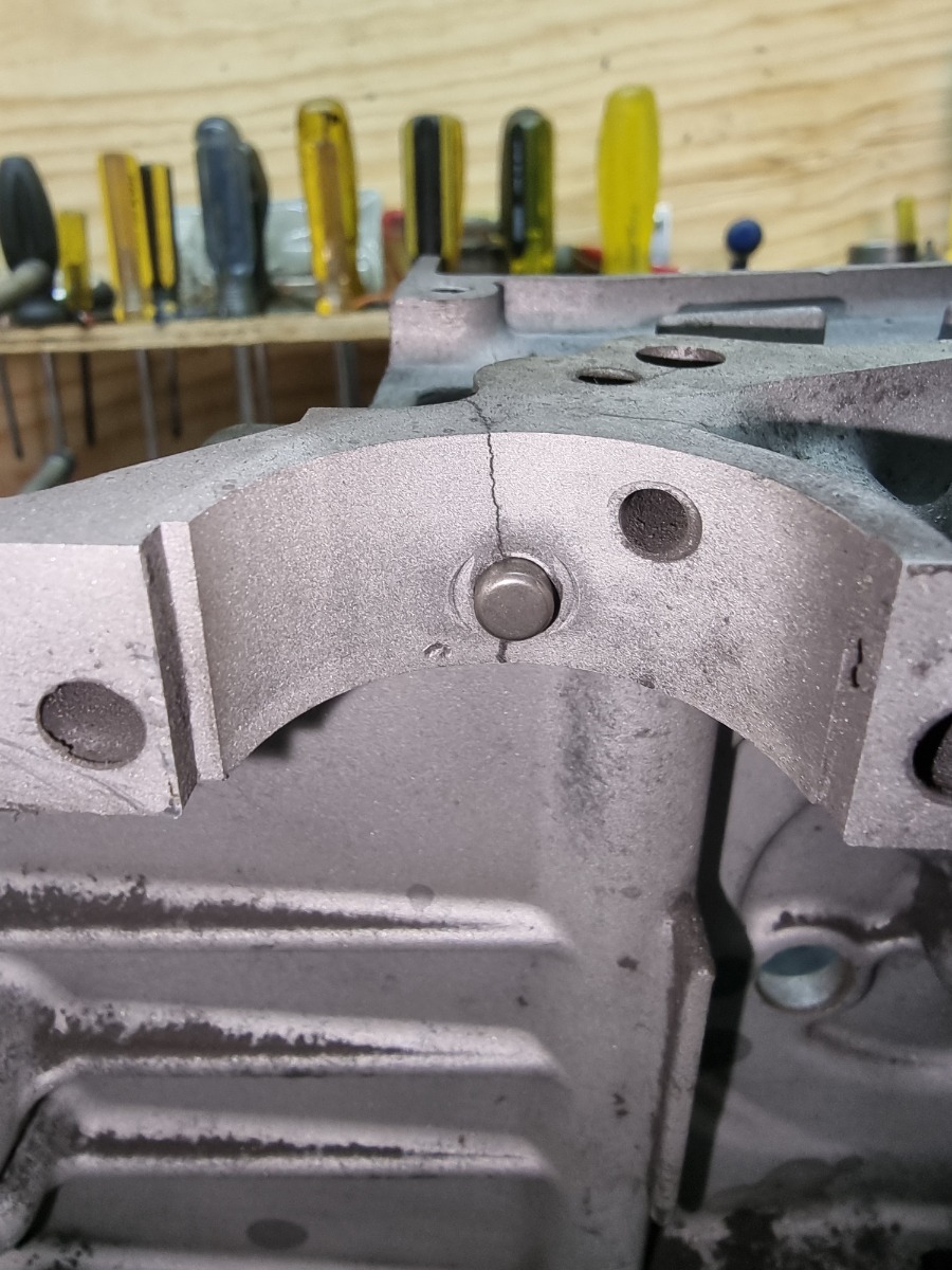

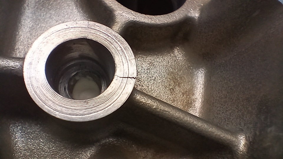

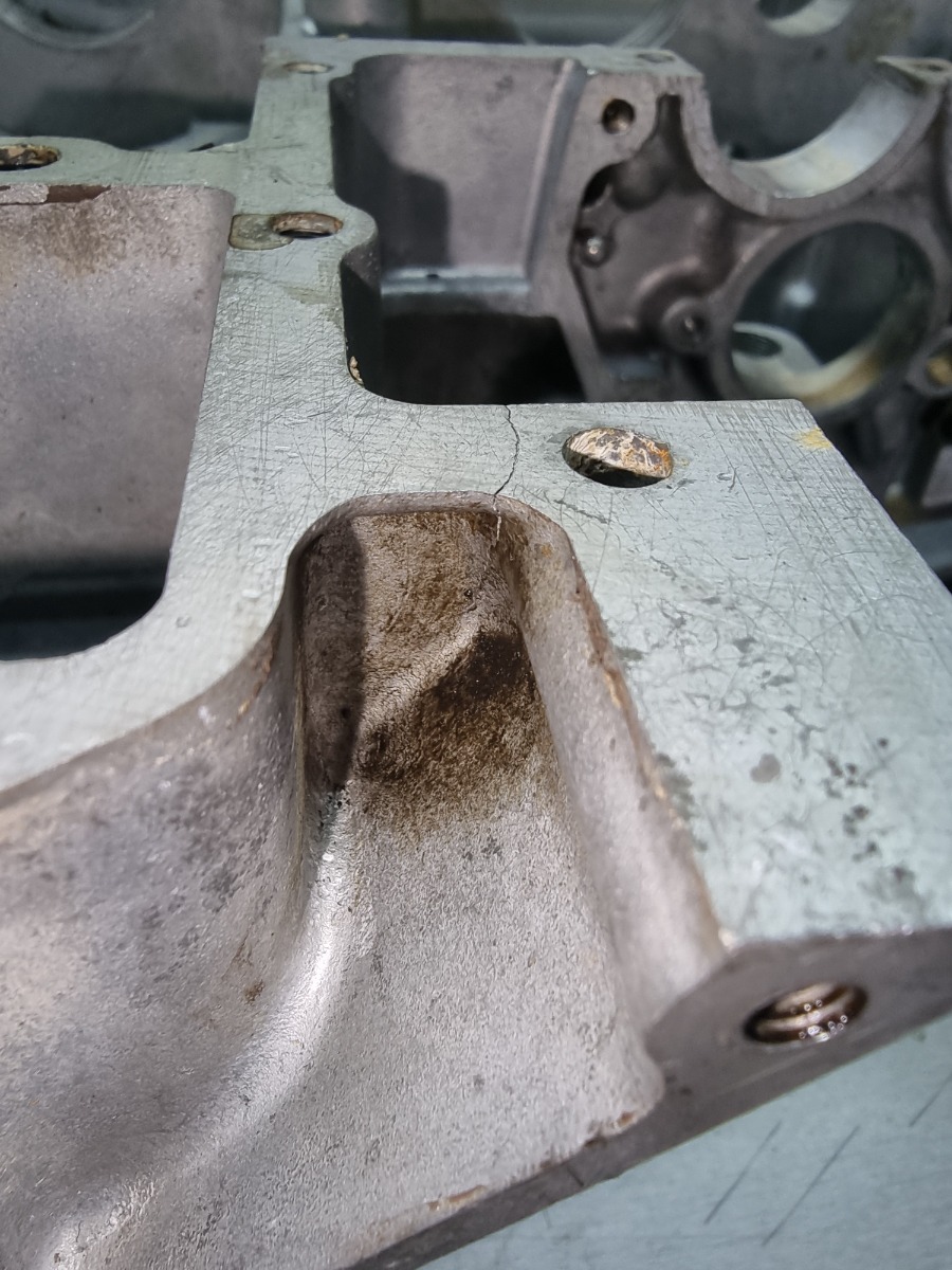

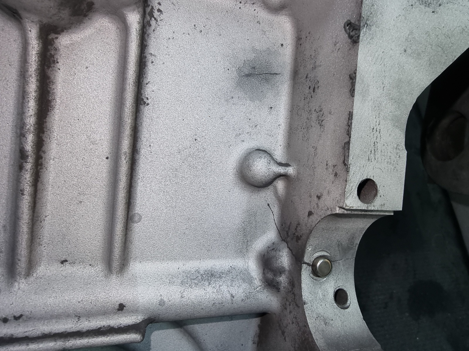

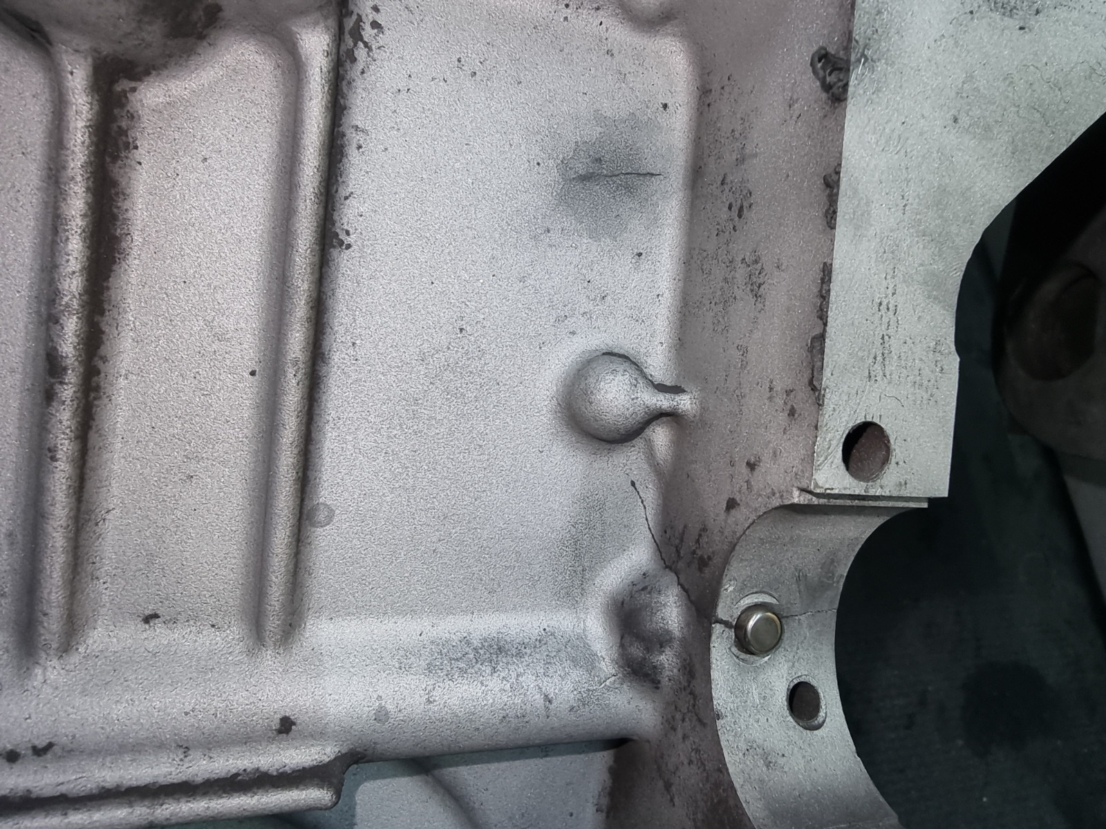

Hello to all,
I'm opening this post because I neeg guidance from the experts.
I'm currently in the long endeavor of turning my very bad condition z1900 into a restomod sactuary inspired beast.
Already all bike is completely disassembled and currently I'm focused on the engine and the frame.
Unfortunately I have found some fisures in different areas of the engine block.
Honestly I don't know how to proceed, at 1st I would like to confirm that it's possible to fix? and if it is what would be the best method?
I live in center Mexico and it's very difficult to find reliable welders, that is my current worry.
I would really apreciate your imput on this predicament.
P.s. If needed, maybe it's possible to get an additional bottom engine for cheap but honestly I would like to fix my current one.
Regards.

Re: HELP!!!! Engine block fisured!!!!!
02 Feb 2026 13:53 - 02 Feb 2026 14:15
What happened?
I repaired some engine blocks using different products like epoxy and aluminum paste to stop an oil leak after a drive chain broke.
I'm not sure about the bearing housing, but there are good products like liquid steel | McMaster-Carr
You can also have a Liquid penetrant inspection....(Dye check) to reveal evrey cracks.
Good luck! / Buena suerte Amigo !
02 Feb 2026 13:58
Those cracks are due to a previous owner not lining up the dowel on the gearbox and it's corresponding hole in the bearing race on assembly.
The crack where the bearing sits is due to the dowel being forced into the case and the other due to flexing of the cases when the case bolts were tightened.
The dowel needs pulling upwards to allow that crack to close up.
I've had the same situation on many of these cases and they usually aren't severe enough to cause a problem or warrant welding and are unlikely to get any worse as long as the same mistake on assembly isn't repeated.

- Posts: 6945
- Thanks: 4361
02 Feb 2026 16:03
If it’s bad enough to require repair it can be “stitch welded” but this is a specialised process that may not be available in your part of the world

02 Feb 2026 19:53
Hey @Kaw-boy 900 I got this engine separetly from the bike so Im not sure about the history in it, I just know I got it cheap jaja therefore my predicament.
I want to do the inspection test with the dye as you mentioned just not so clear where to find the dye maybe amazon?
Anyway thanks for your reply.
02 Feb 2026 19:59
Hey @zed1015 I followed your builds with the xjr1300 swingarm bikes, flawless job everytime.
Going back to my situation, In your experince would you leave it as it is? Or would you recomend some kind of reinforcement such as epoxy or something like that, I understand that in the contact surface with the brg is difficult to apply this kind of chemical but maybe outside it can help to avoid oil leaks in the future?
03 Feb 2026 00:51I would pull the dowel up to allow the crack to close and leave it at that.Hey @zed1015 I followed your builds with the xjr1300 swingarm bikes, flawless job everytime.
The crack in the bearing saddle will be blanked by the bearing itself, the trans gasket and will be closed further when the case bolts either side are tightened.
The other one will get filled with case sealer.

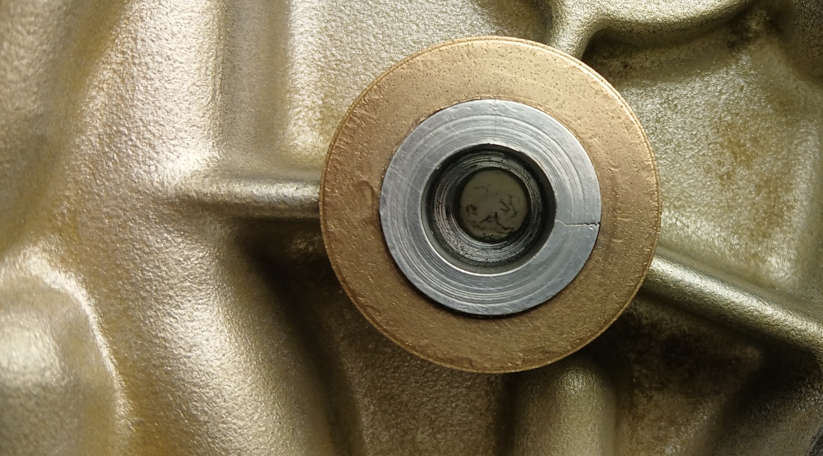

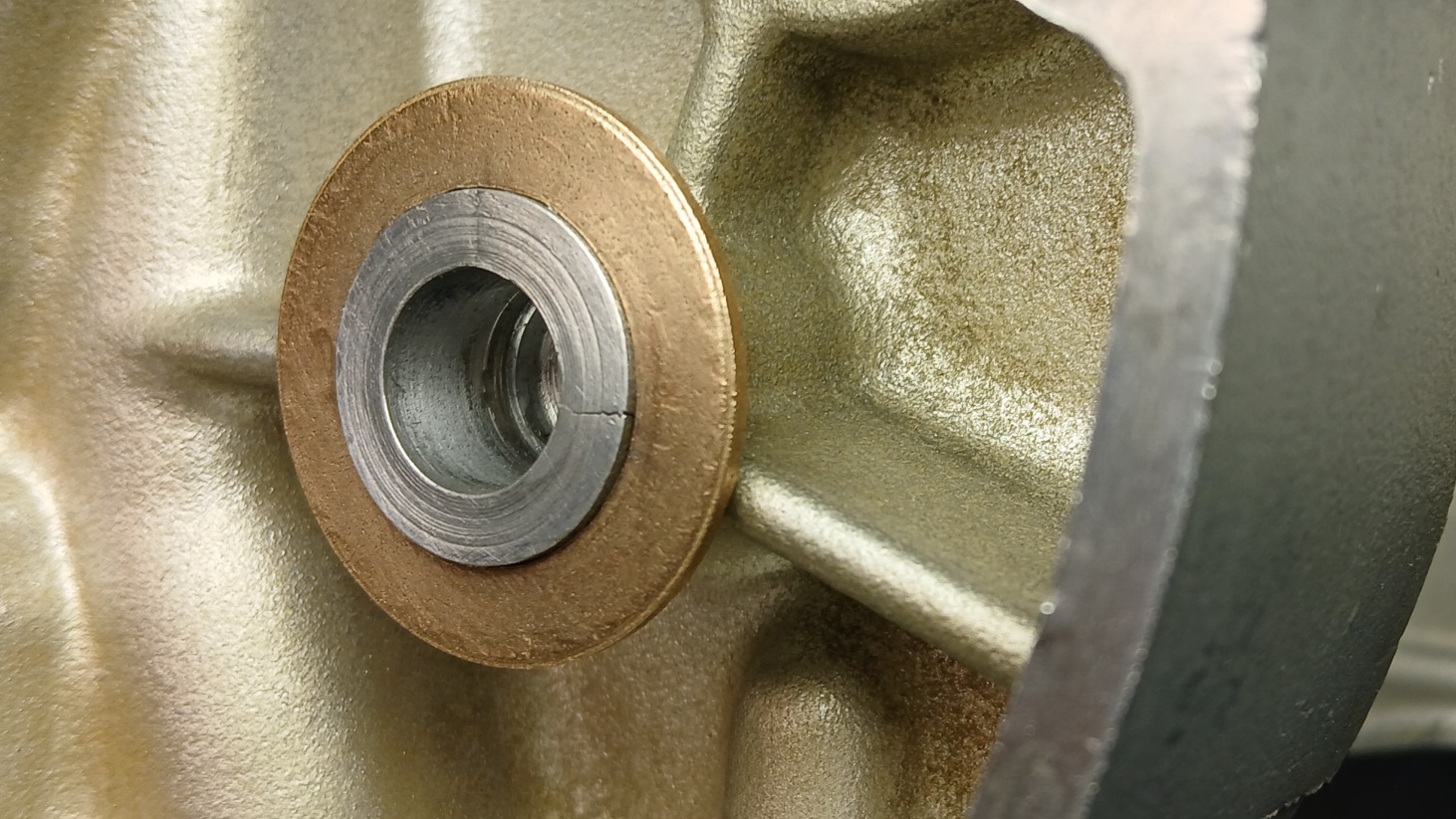

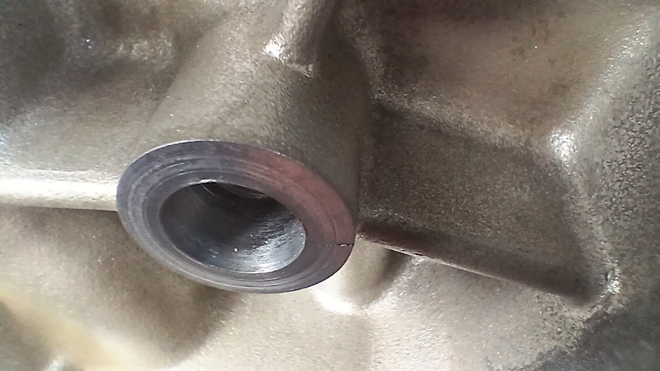

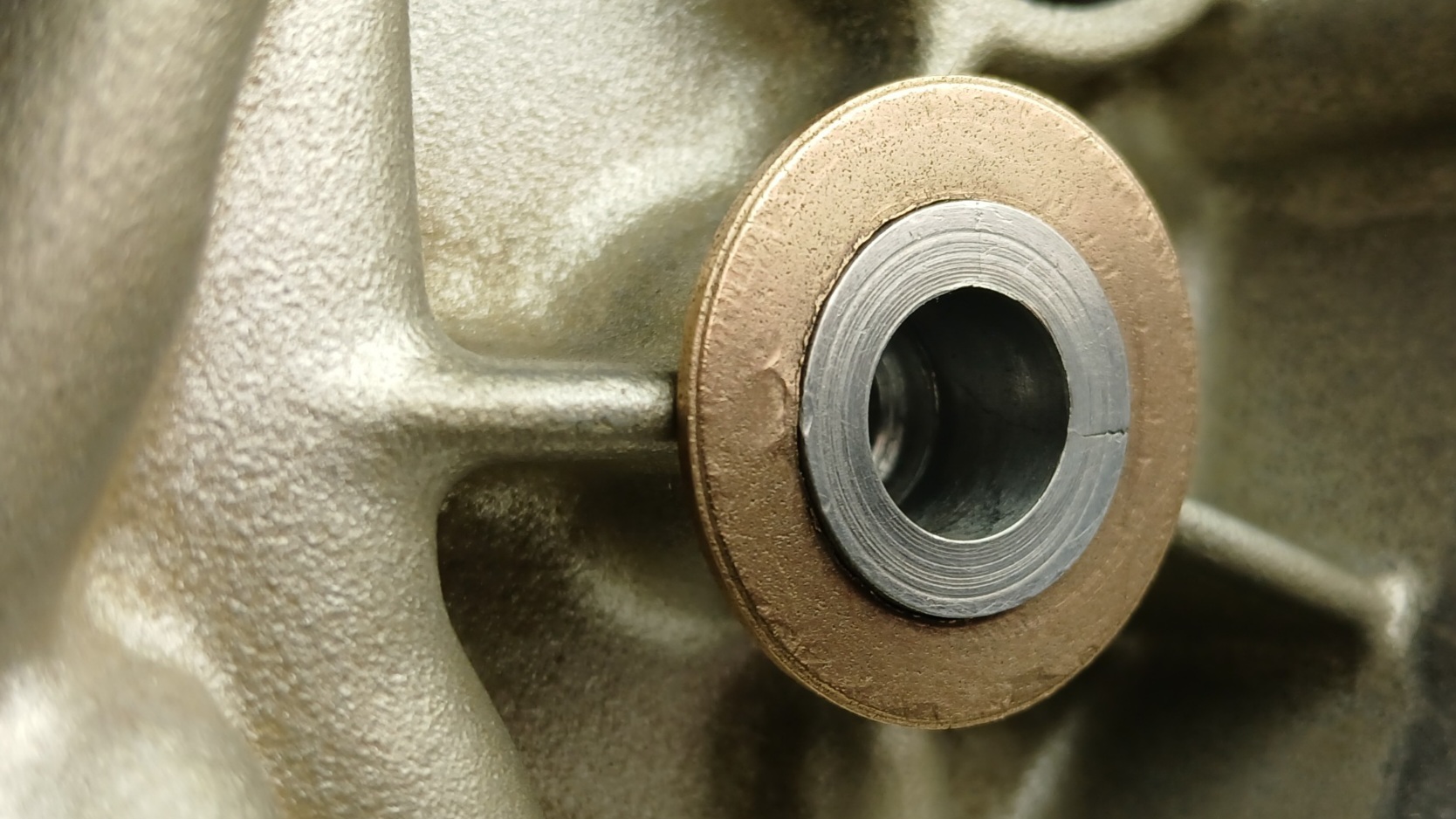

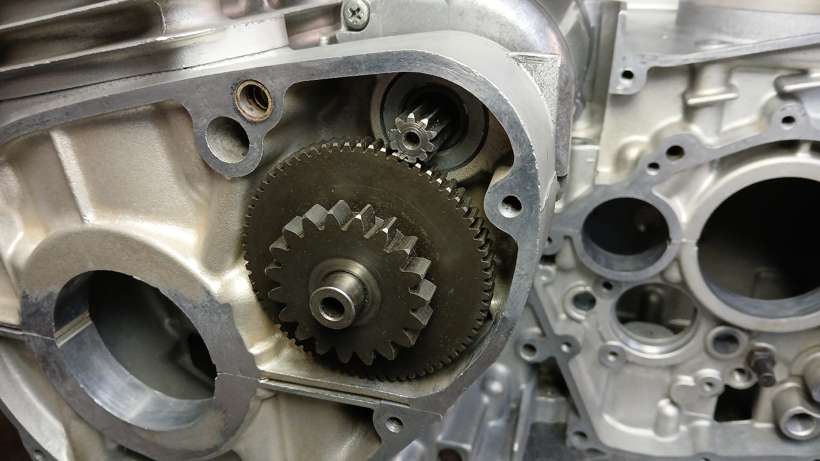

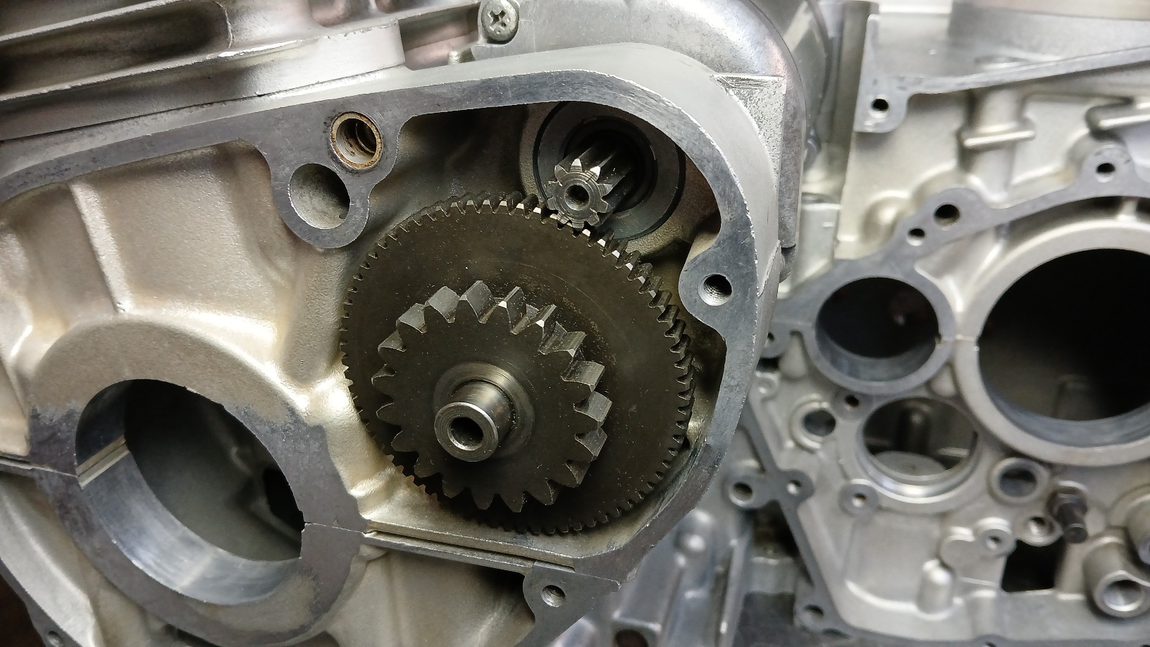

Here's a similar repair situation.
Guess who (lol) followed Clymer's "penny" suggestion, way back in the day...
Would a steel washer pressed tightly over the hub end be a sufficient repair vs having this breakage welded?

- zed1015
- Posts: 3376
- Thanks: 2087
04 Feb 2026 00:22 - 04 Feb 2026 03:24Here's a similar repair situation.
Again! I have seen this many times too.
The idler gears axle extends further into the case than the crack and is supported both ends when the cover is on so it not going to affect the function and the supporting webs around it which also act against the sideways forces on the axle prevent the crack getting any worse.
If anything. you could press a ring like you suggest over the hub to close the crack . especially if the cracked portion is loose or just hanging in there but i've seen plenty of these running just fine with the broken piece missing .
Once the case is bolted on the axle is captive and stationary in the case.
Last edit: 04 Feb 2026 03:24 by zed1015.
04 Feb 2026 07:45
Correct, the damage had no affect on starting function, nor has it visibly increased over time.

- daveo
- Posts: 3190
- Thanks: 910
17 Feb 2026 19:33Here's a similar repair situation.
3/4" ID bronze washer sized for friction fit:
EZPZ
1982 KZ1100-A2/1170 sleeper 😀
