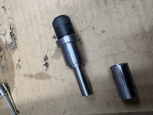

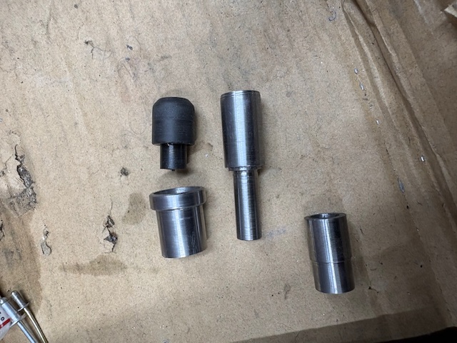

I also intend to fit the pistons into the block before install as I will doing it on my own and I believe it will be easier without damaging rings (time will tell) To that end you got me thinking about that tool. My years of being a "tool magpie" are long gone and I wouldn't consider spending $100 for it but I got to thinking, while my carbs are at the blasters, "maybe I can make one from my scrap pile". Below is what I came up with, the peg centres the tool on the wrist pin and also it's thicker than the end gap in the clips so it will prevent any "escaping clips"
I will let you know how effective it is in the coming months when I get onto the motor ?? (worth a try as it cost nothing)

I love it I wish I was seeing you before I ordered mine I ordered one from Partzilla for $47 it should come today but I'm not going to mess with it till the weather breaks a little bit too cold in the garage it's a separate garage I'll let you know how it works out
PS yours looks better
