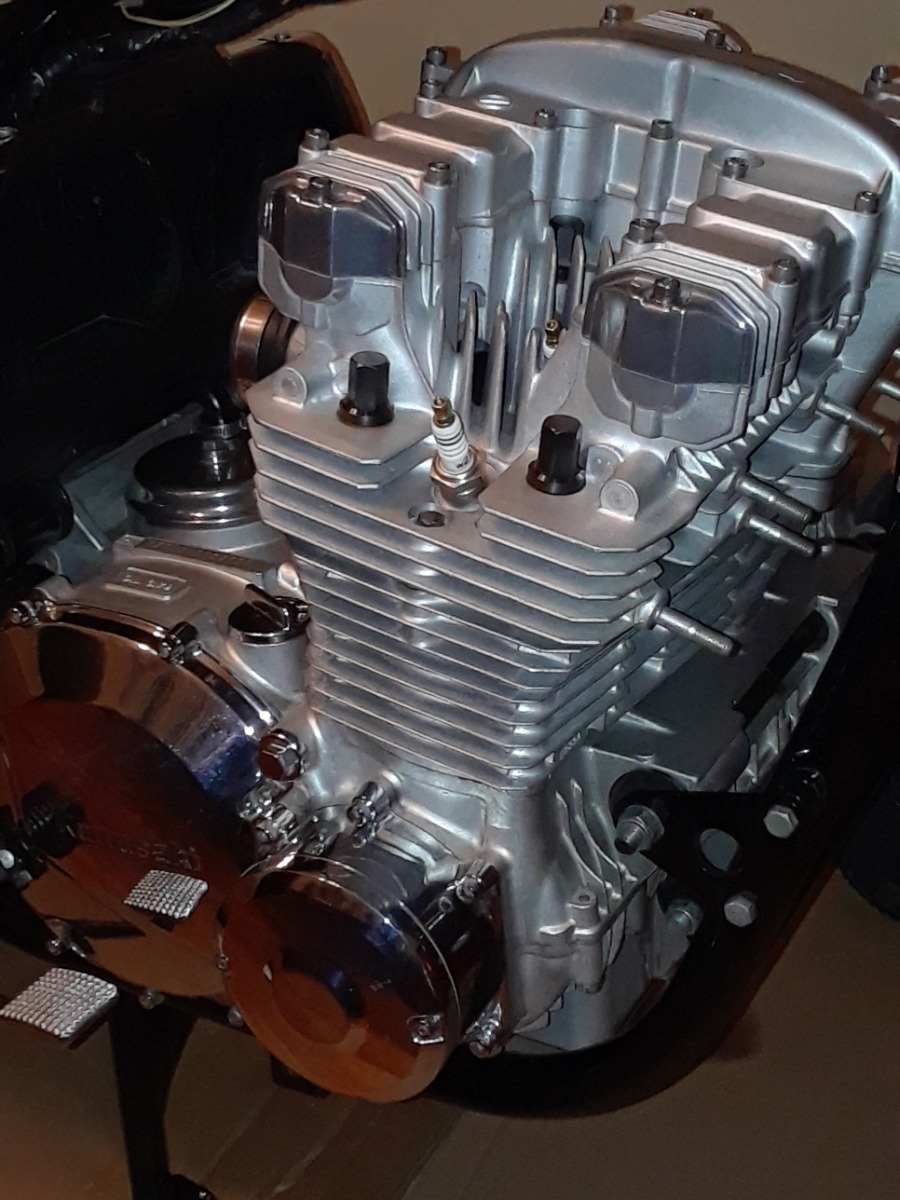

Cams installed... 😉
My old 82 motor drain plug thread is M20 x 1.5
The 84 is M12 x 1.5
1982 KZ1100-A2/1170 sleeper 😀
