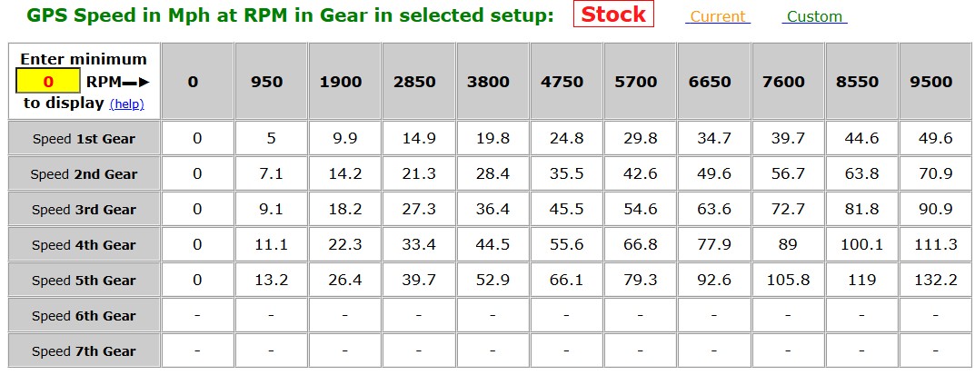

29 Dec 2025 03:17Don't disagree with any of the above but you are on factory gearing so the issue is bizarre. Normally a lack of "torque" will stop a vehicle pulling in higher gears but this would be apparent to a lesser degree in other gears also. Below is a chart showing what you should be able to achieve in each gear, might be worth going for a ride and see how your bike compares in each gear ?The pertinent question is "does the lack of performance become increasingly evident as you go up through the gears?"

Guys, i can race it like im going down a dragstrip through all 4 gears then it hits the wall in 5th. I dont think i hit redline but i do recall seeing 8000 plus on the tach. Buddy and i went for a ride just before i initiated the thread and we decided to race it like at a track. We found a back road and i went for it. This is how i know its ( from what im experiencing anyway ) a 5th gear issue. I can do it again and record speeds and revs at some point. Only gonna be 30 today so it wont be today.
I can confidently say it will do redline in first 4 gears if i held throttle till it did.. im sure of that. First thing is im gonna count teeth and see if they are both stock sprockets.
