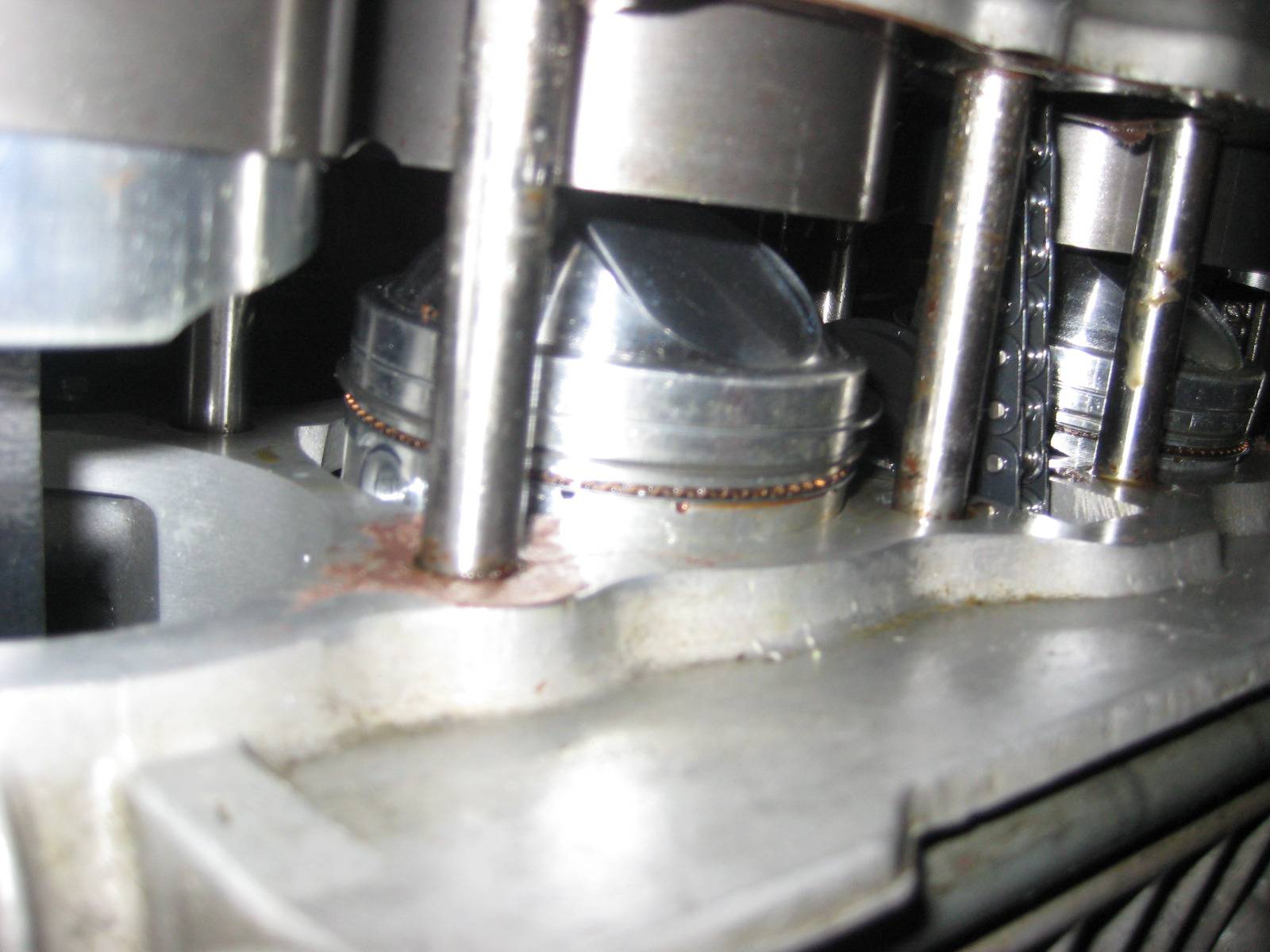

Re: Teflon buttons vs circlips for piston wrist pins?
17 Nov 2025 13:31 - 17 Nov 2025 13:50Buttons are the way to go on performance builds, easier to take apart and reinstall than cir clips especially on anything race orientated. Just make sure you have a small pick tool in your tool box to remove them.I have a motor opened up right now and I was just considering this - I have brand new Wiseco pistons in with only a few runs on them, but I was considering buttons with us pushing the RPMS a bit higher than I normally would.
Very interested some opinions on this -
This has aluminum buttons, notice the notch in the liner. That piston head combo is giving +16:1 comp.
