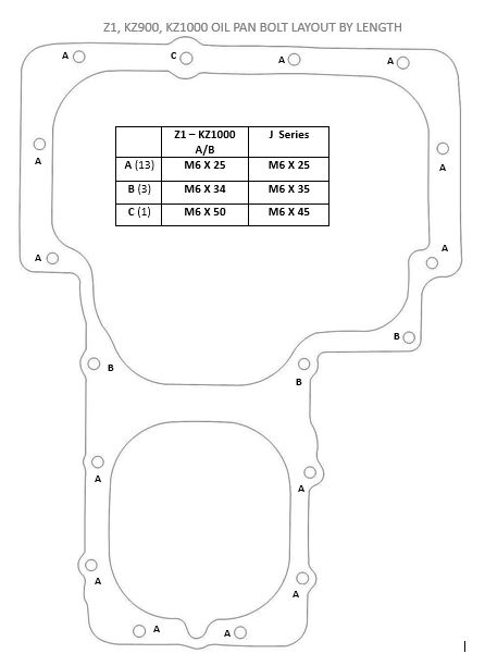

In the process of troubleshooting oil flow, I removed the oil pan to ensure all good with the pump. While re-installing the pan, I got to thinking some folks may have forgotten where the different length bolts go. So I put this together in a Word Doc. Don't know if it is already available but thought I'd share. If the moderators deem it should go somewhere more easily accessed, feel free to move it there.

Unfortunately when i look at the doc the A,B,C, aren’t next to the bolt holes on the drawing
