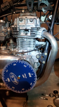

I'm trying to figure out if I'm losing power somewhere so I decided to degree my camshaft.
Just in case anyone needs numbers for comparison.
Camshaft specs kz440 1981 D2
oct 11 2025
temp 63˚ f
humidity 70%
baro 30.18 in/hg
intake left side
starts to open 47˚ BTDC .005”
.050” opening 8˚ ATDC
.309” max lift 62.5˚ BBDC
.050” closing 47.5˚ ABDC
duration at .050” 216.5
intake right side
starts to open 76˚ BTDC .0005”
.050” opening 6.5˚ ATDC
.309” max lift at 61˚ BBDC
.050” close at 47.5˚ ABDC
fully closed by 47.5˚ BTDC
duration at .050” 221˚
exhaust left side
starts to open 69˚ ATDC .002”
.050” opening 32.5˚ BBDC
max lift .313” at 76.5˚ ABDC
.050” closing at 1˚ ATDC
fully closed by 80˚ BBDC
duration at .050” 213˚
exhaust right side
starts to open at 64˚ ATDC .001”
.050” opening at 33˚ BBDC
max lift .313” at 75˚ ABDC
.050” closing 0˚ TDC
duration .050” 213˚

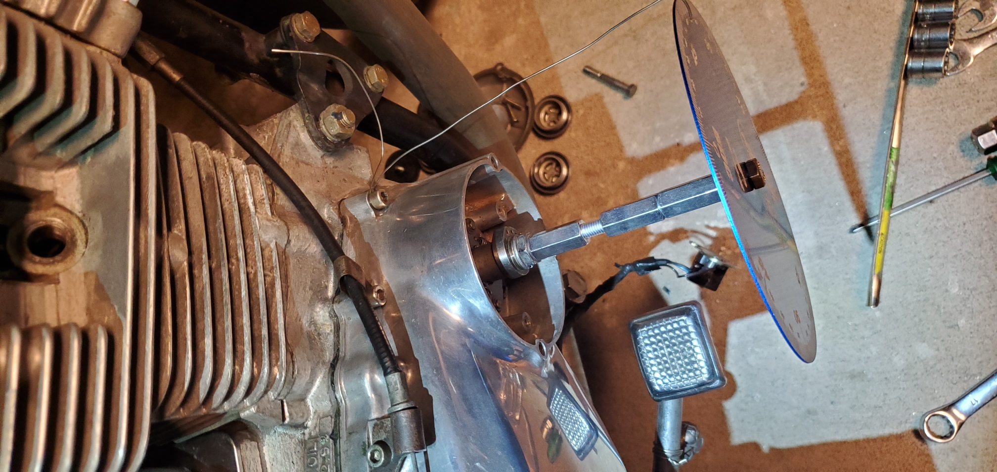

I used:
1-M8x1.25x130mm full threaded stud
3-M8x1.25x30mm hex coupler standoff nut
1-M8x1.25x16mm hex bolt
purchased from Belmetric
Motion Pro degree wheel had to be drilled out to 8mm as the center hole was only 6mm.
