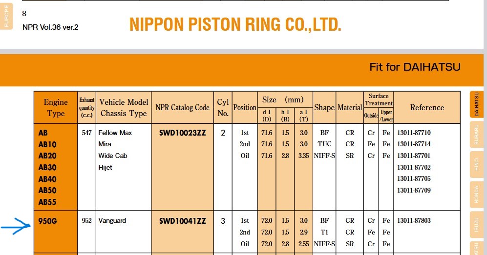

If your ring lands are truly XN size (.059"x.059"x.110") then these should fit :
From the NPR catalog. Its a little sub 1 liter engine so not too popular.
Search Ebay "72mm STD Piston Rings Set Fits for DAIHATSU D07 13011-87803 SWD10041ZZ 9-7034-00"
They are $26 a set (1 piston) out of India. Maybe see if you can order direct from NPR of America to avoid a Tarrif charge.
