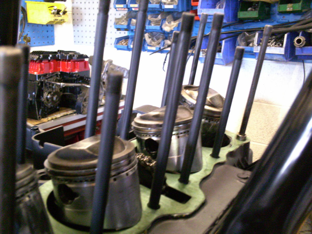

Thanks to everyone for the input. Here's some pictures of the project bike and a piston.

25 Sep 2025 23:40 - 25 Sep 2025 23:41Your pistons appear to be Honda CB450/500 twin so you will need two sets of std rings for those.Thanks to everyone for the input. Here's some pictures of the project bike and a piston.
Do you guys think this piston/ring kit for a 77 KZ1000 (standard bore) work?
ebay.com/itm/304952801100
I've had a few 900's with the Honda pistons fitted as shown in the attached pic.

Thanks for the info. I'm going to decarbon the top of the piston to give you a better picture. The top of the is raised in the center with an identation on top in the front and back.
