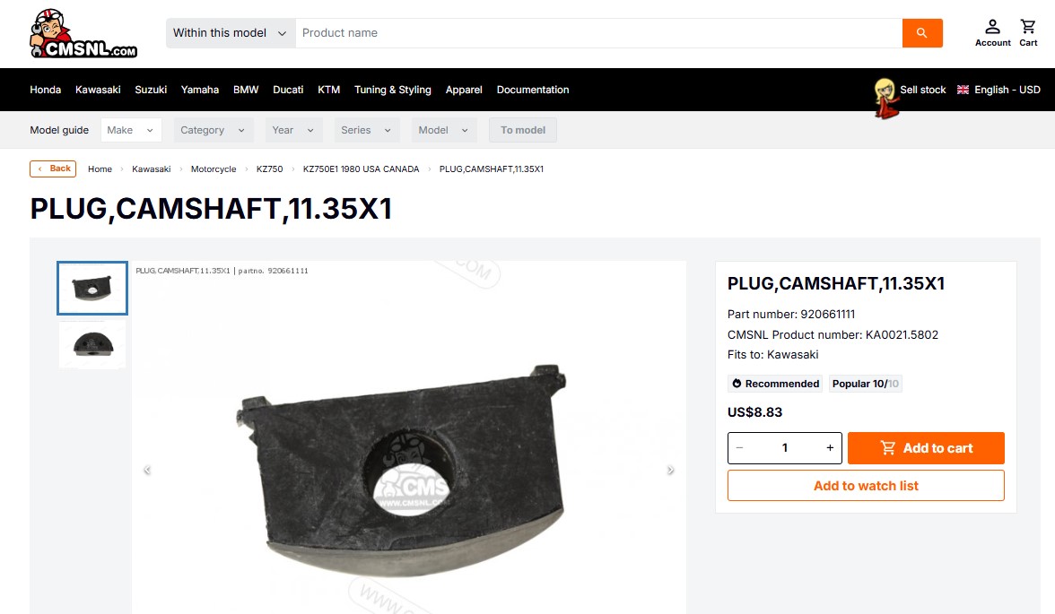

Doesn't "add to watch list" mean it is out of stock with no idea when it will return?

@Wookie58: Sometimes solutions are so close... I wasn't thinking when I wrote this thread after even having ordered there multiple times... Thank you!
@TexasKZ: If they are out of stock you'd see a greyed-out "Add to cart" button. Watch list is more like a bookmark to remind yourself of it later on.

I bought four new cam plugs from Webike Japan, OEM Kawaski.
$4.94 per plugĀ
$4.94 per plugĀ
