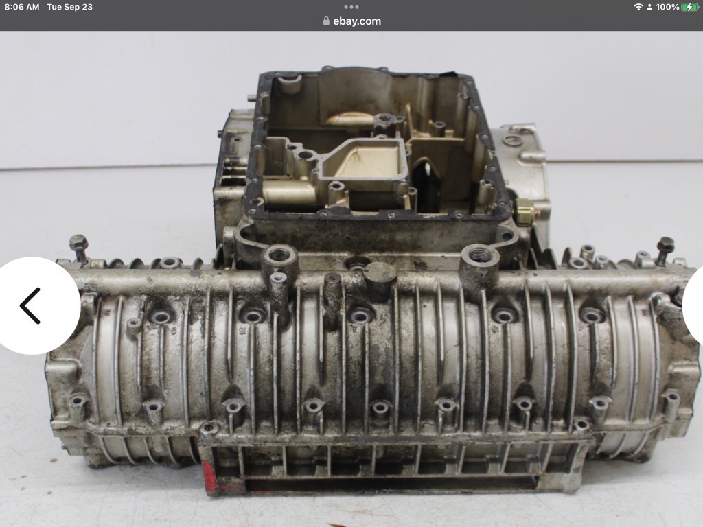

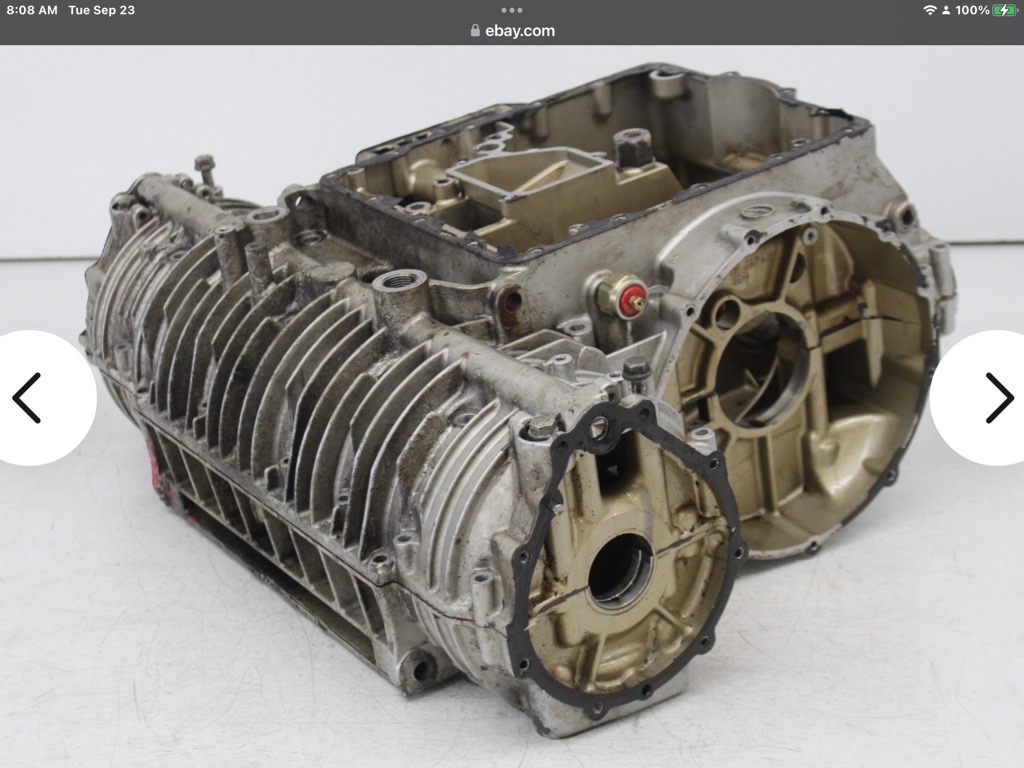

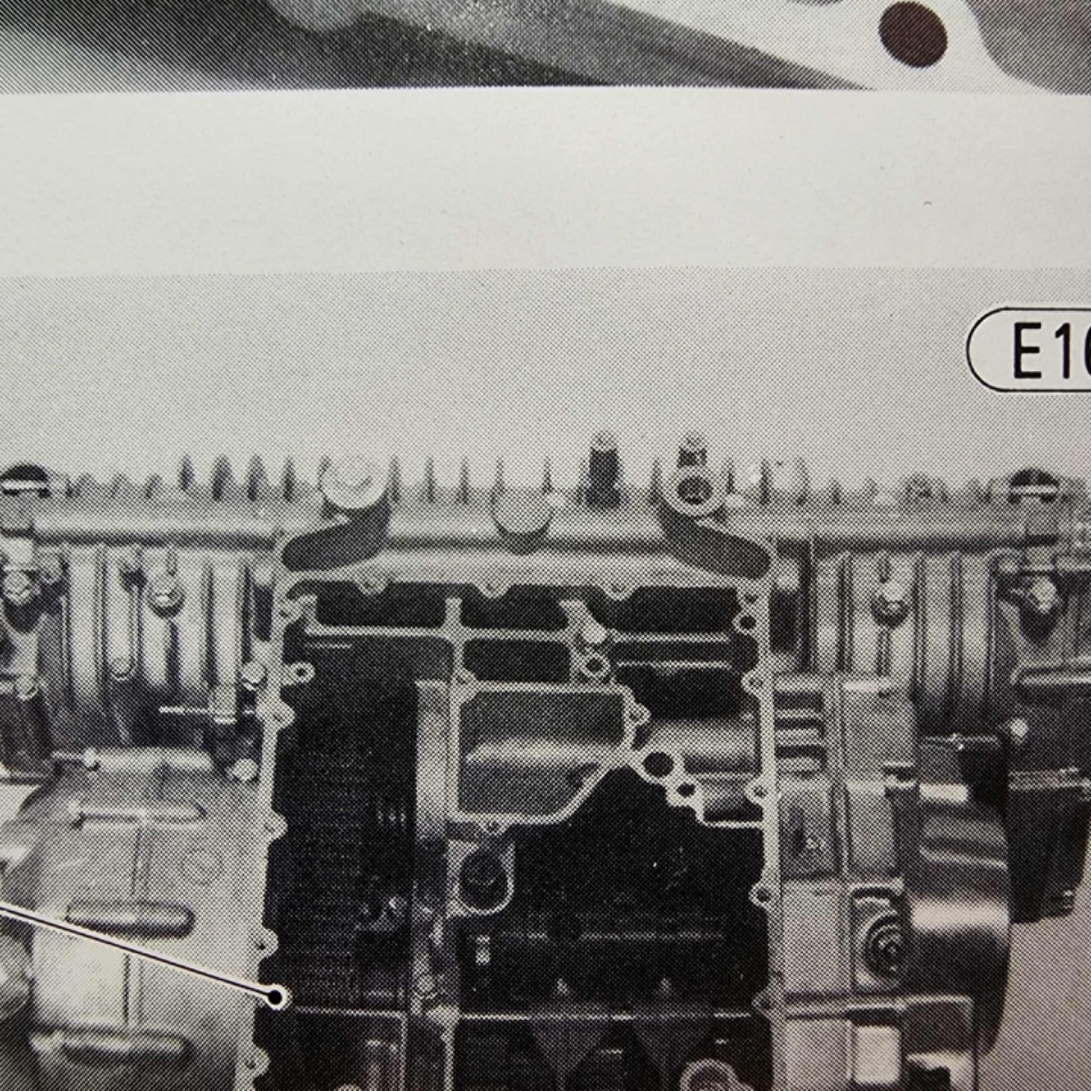

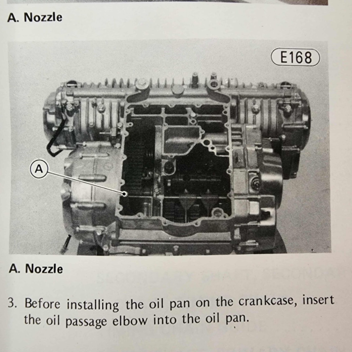

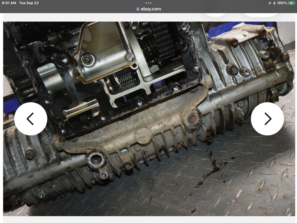

ThankYou for the responses. I located the drain plug with a socket wrench 17mm between the first and second exhaust tube on the clutch, stator side of the engine case, it faces forward and canted downward a little bit.
I went on a ebay search for kz1300 engine and posted sone pics from the site.
i also found similar photos in the KZ1300 manual on page 91.
See the pics, I believe this when drained yields about 5 oz. The best I can figure is it drains one or both the stator and clutch compartments?
