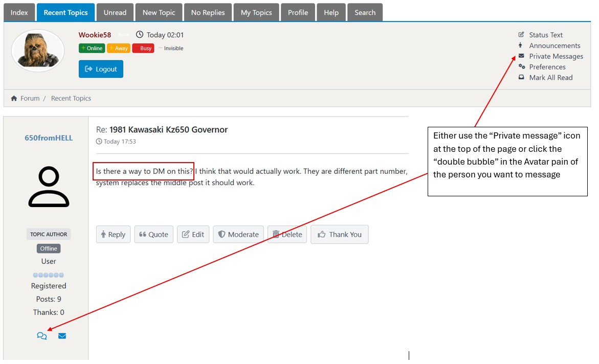

Is there a way to DM on this? I think that would actually work. They are different part number, but they look basically the same. Plus since the electrical system replaces the middle post it should work.

07 Sep 2025 02:19Is there a way to DM on this? I think that would actually work. They are different part number, but they look basically the same. Plus since the electrical system replaces the middle post it should work.
