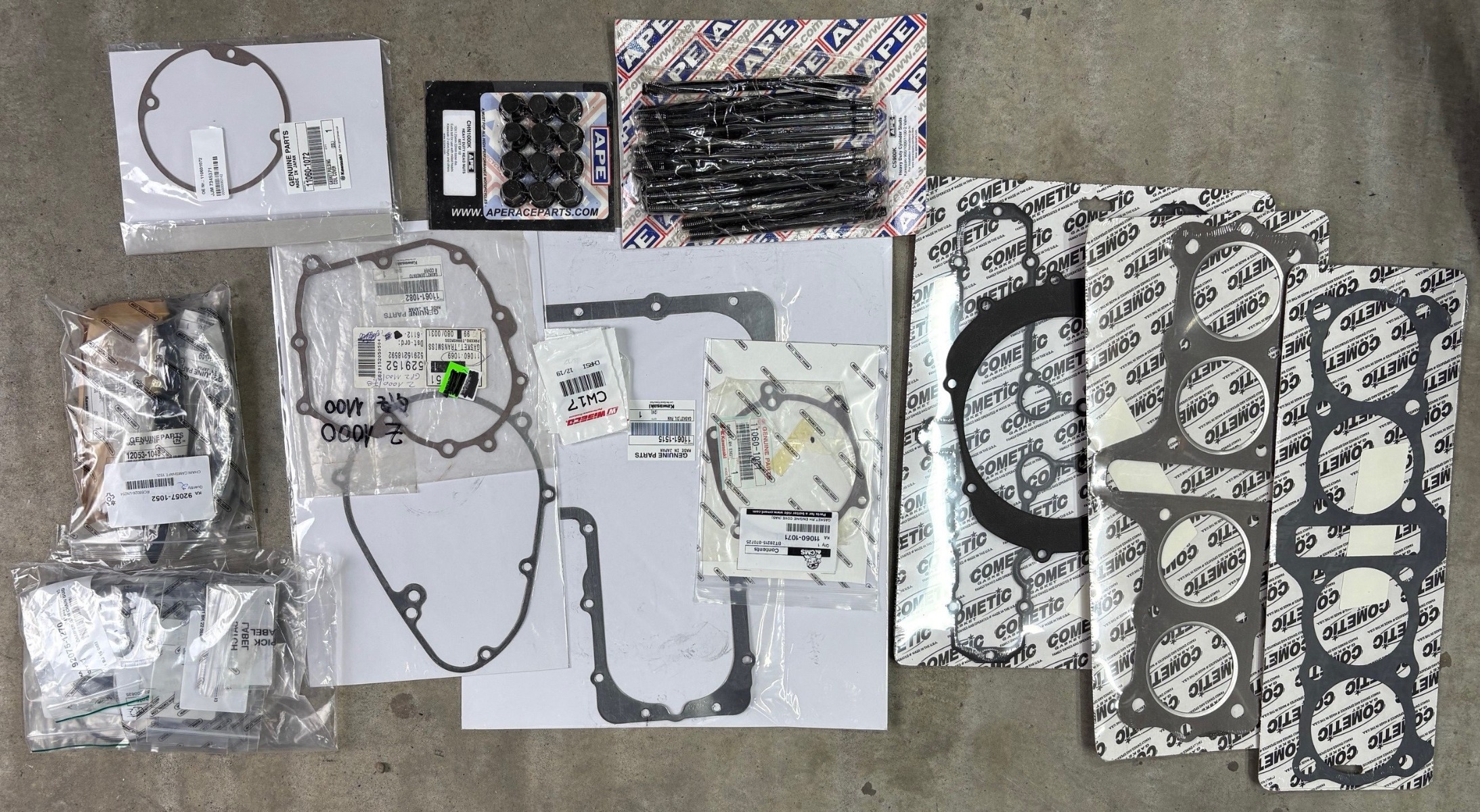

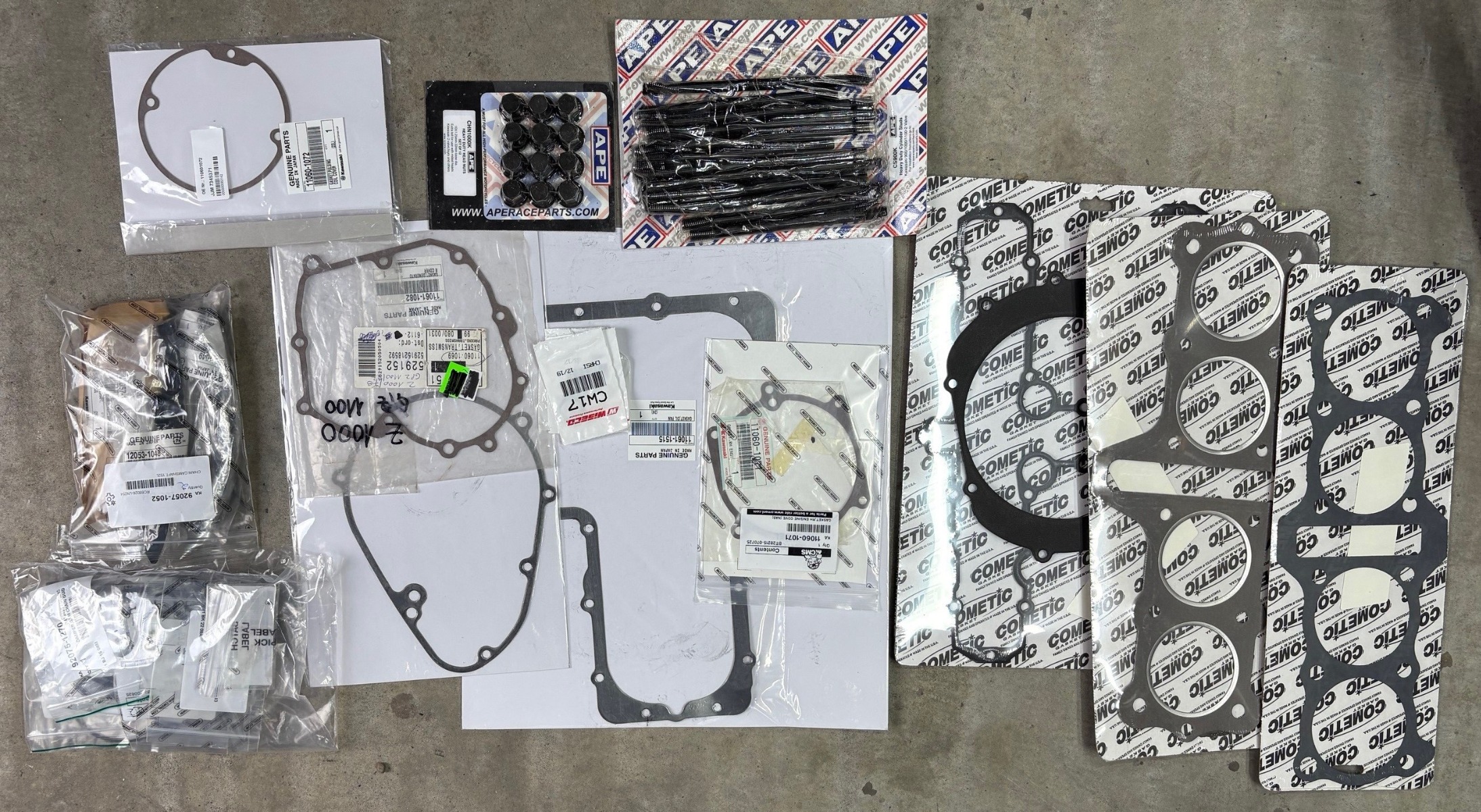

I guess it comes down to budget, your skill levels, facilities, desire and available local builders if you don't have the confidence or desire. All parts are available but not cheap for quality parts (I just received 95% of the parts I require for a "J" motor - mainly gaskets, seals, studs, head-nuts, cam chain and guides etc but without pistons or machining I'm still into around $800
