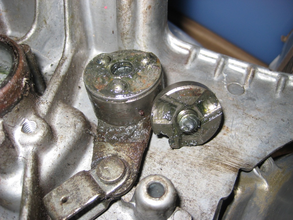

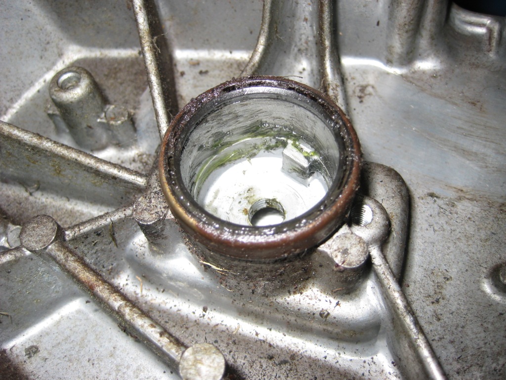

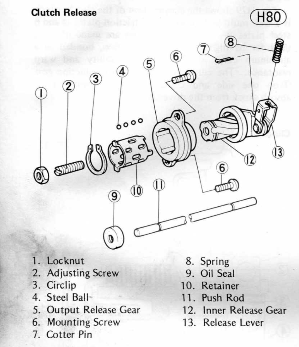

The 650's, and early 750's, used a clutch release mechanism as shown below. Later bikes, used the arguably superior three ball ramp mechanism.
Either way, these mechanisms should be cleaned and greased occasionally. Most people NEVER do this. Not to mention, lubing the cable.
The three ball ramp is a little harder to setup; you must be sure that when the level is released, that the mechanism is at the base of the ramp. If you start too far up the ramp, it's possible to jump over the top when pulling in the lever. Ron's point about not messing with the adjustment, relates to not screwing up there the mechanism is baselined.
