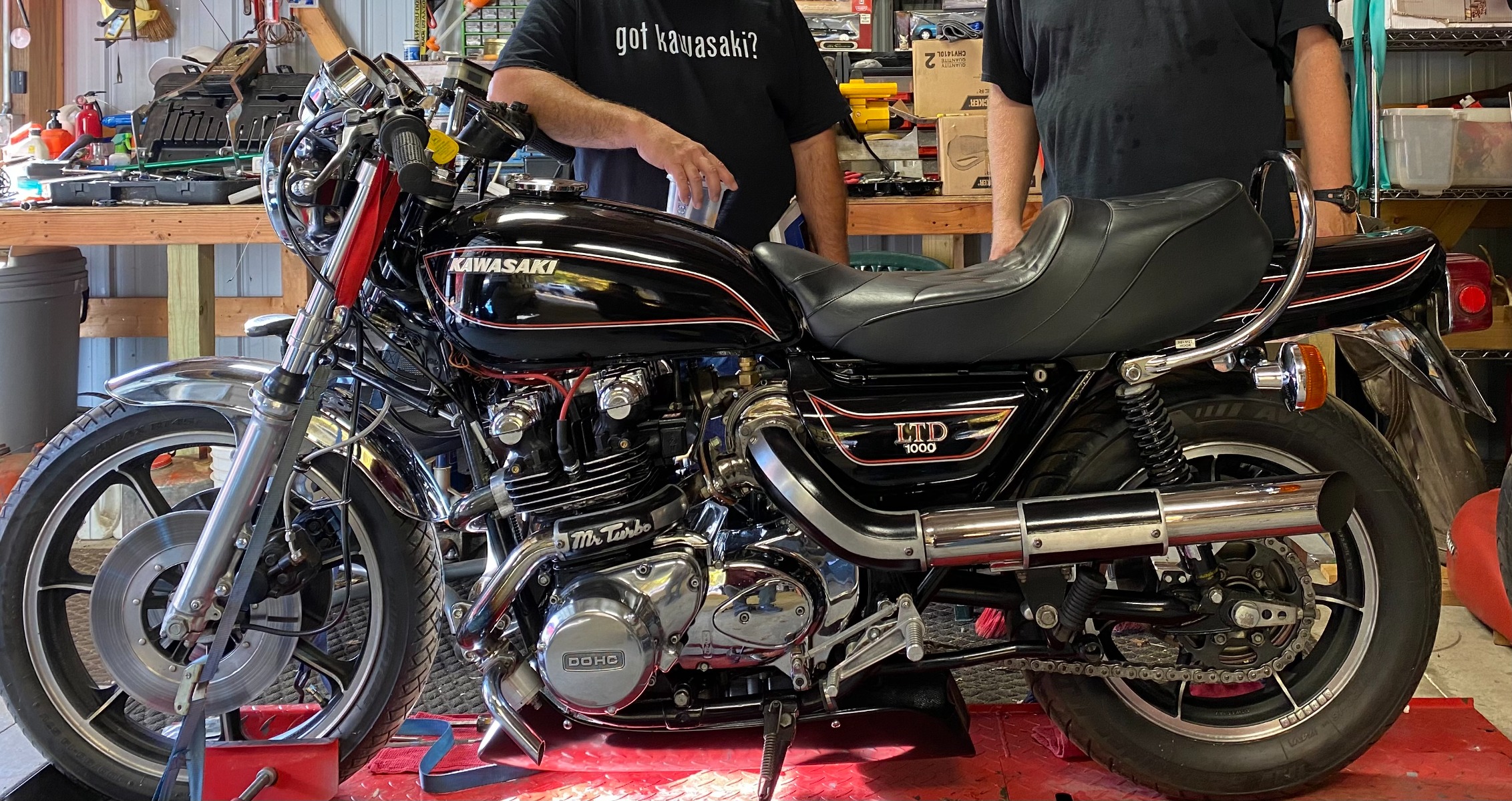

Here is mine

Joe did my 80 KZ 1000, bored to 1075 and degreed the stock cams for more mid TQ…I am gonna say I get a smile every time I go past 5000 rpms
