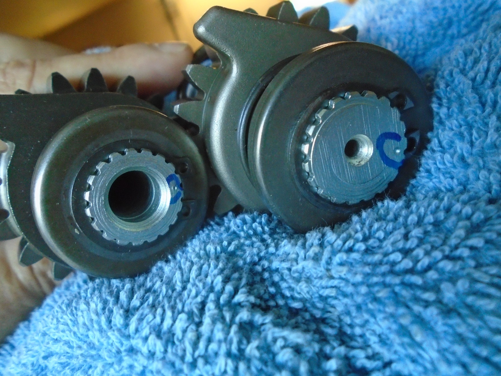

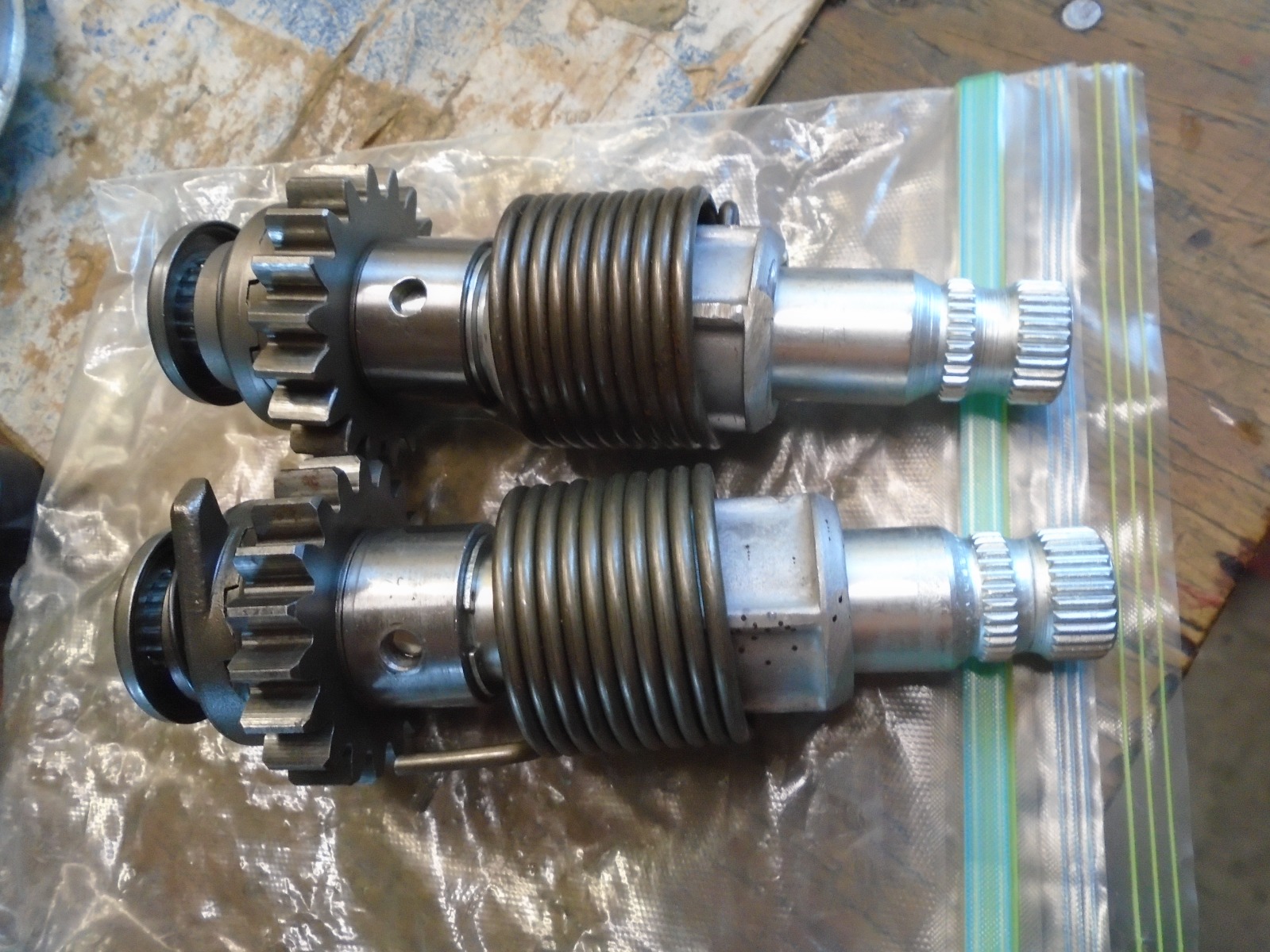

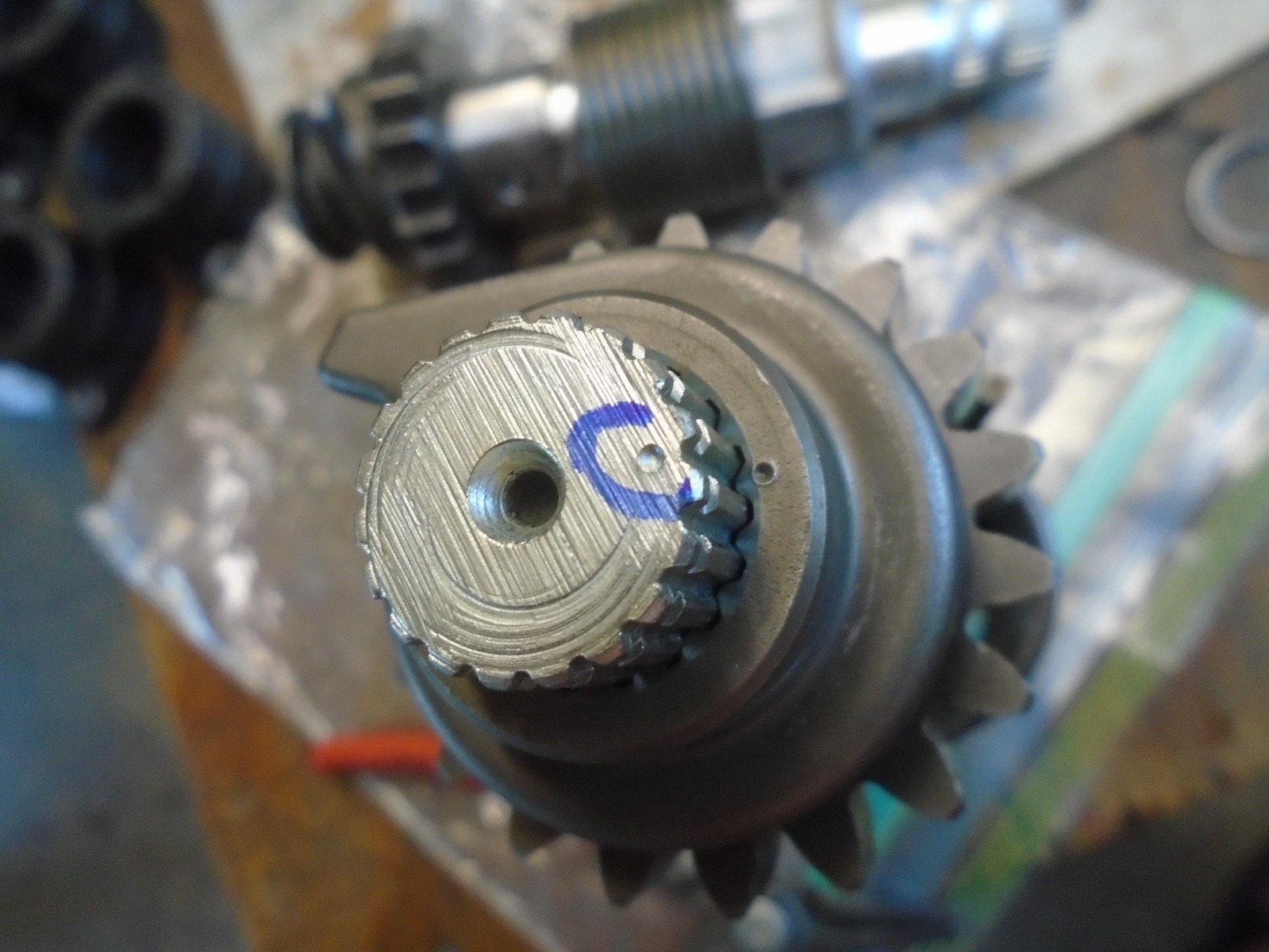

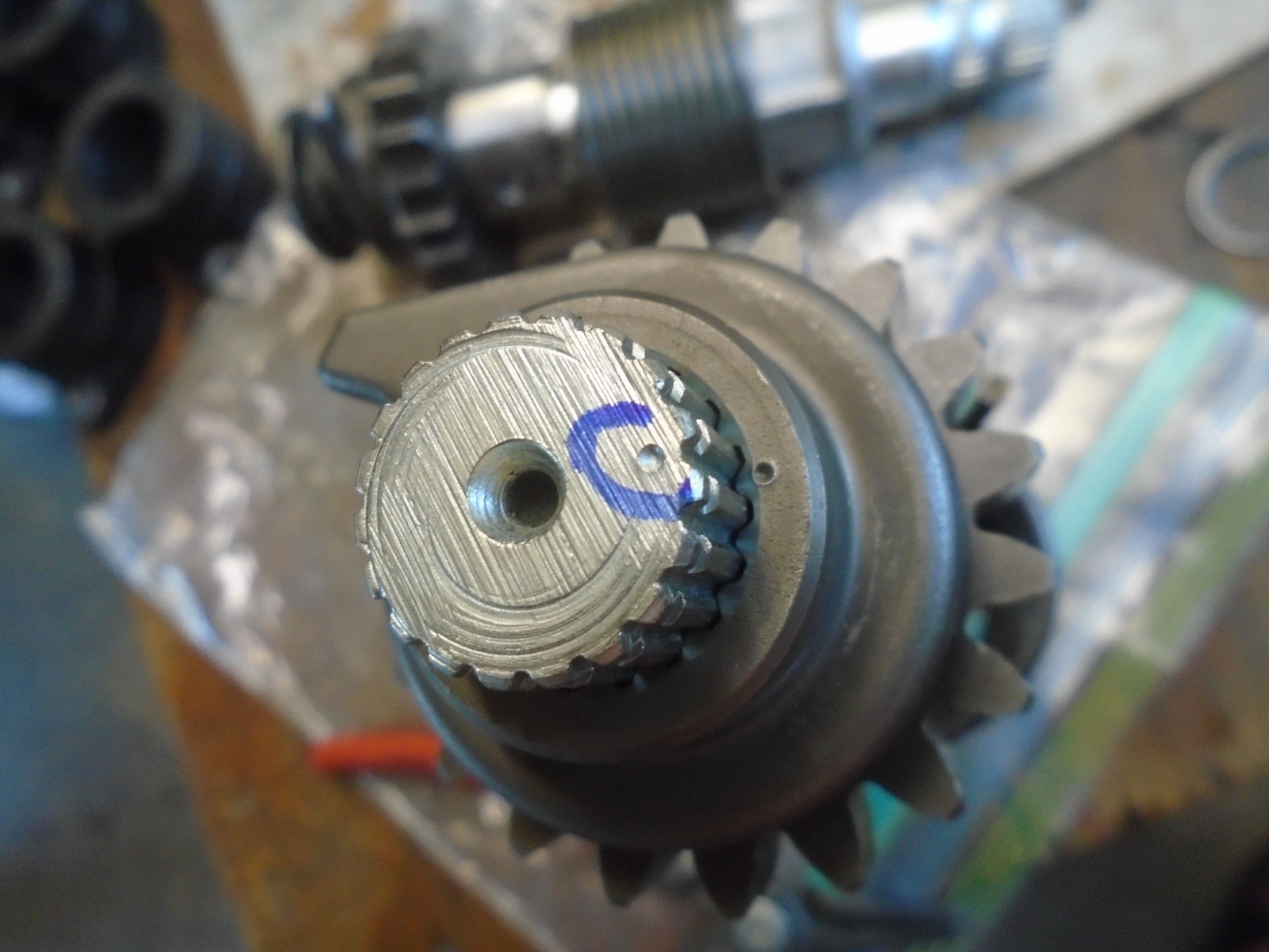

Ditto Wookies comment, clutch has to have the plates in it or no kicker action. I asked about if you had split the cases because you might of disassembled the ratcheting mechanism on starter shaft? These HAVE to be indexed correctly or the kicker won't work! Or work correctly depending how far off the punch marks are off. Shown the two types, early (hollow shaft) and later solid. But note the punch marks on shaft and rachet stopper. You have to align these marks when installing the rachet stopper. Remember back what you fiddled with??? Unfortunately if incorrect then you will have to split the cases again, uggg.
