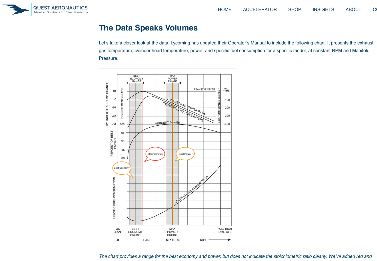

Well, that was a rabbit hole.
Time to get an EGT and CHT.
quest-aeronautics.com/leaning-aircraft-engine/
