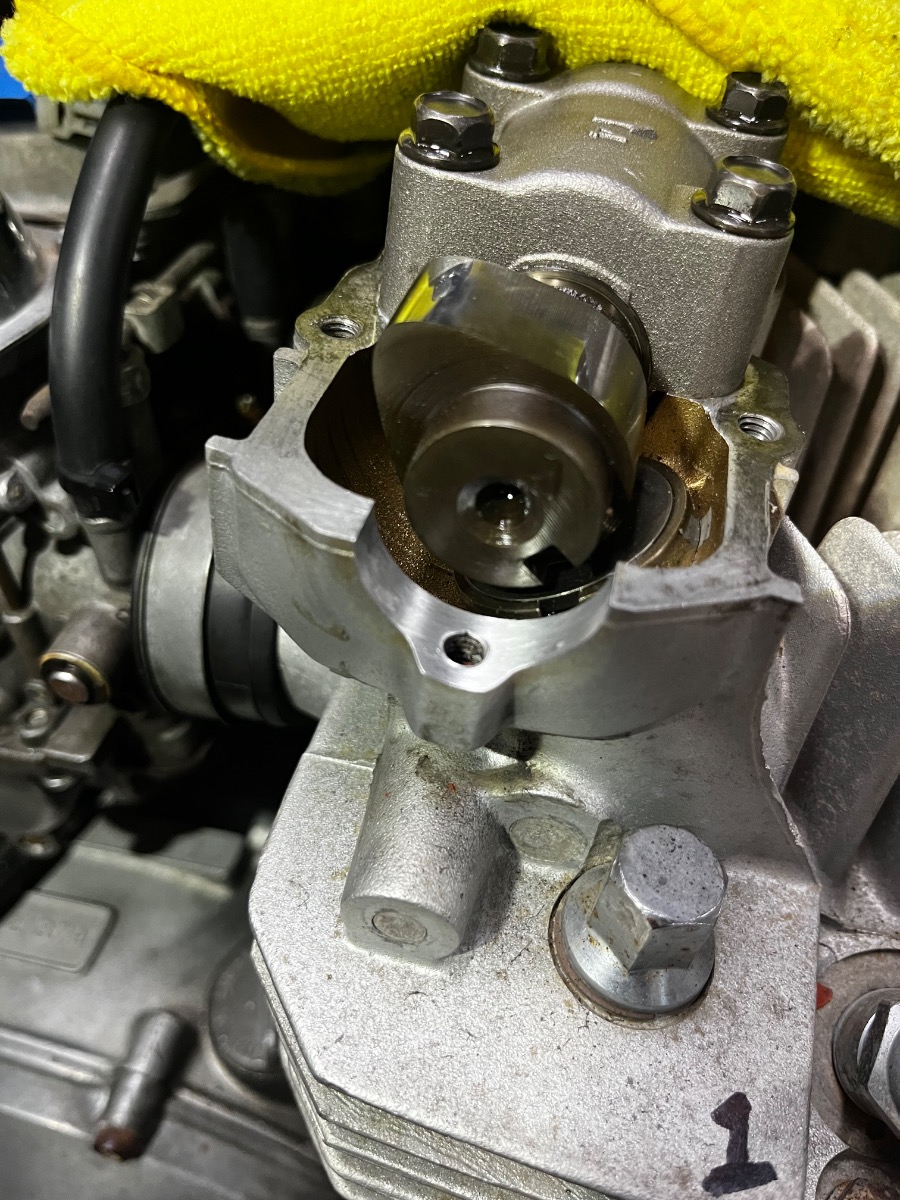

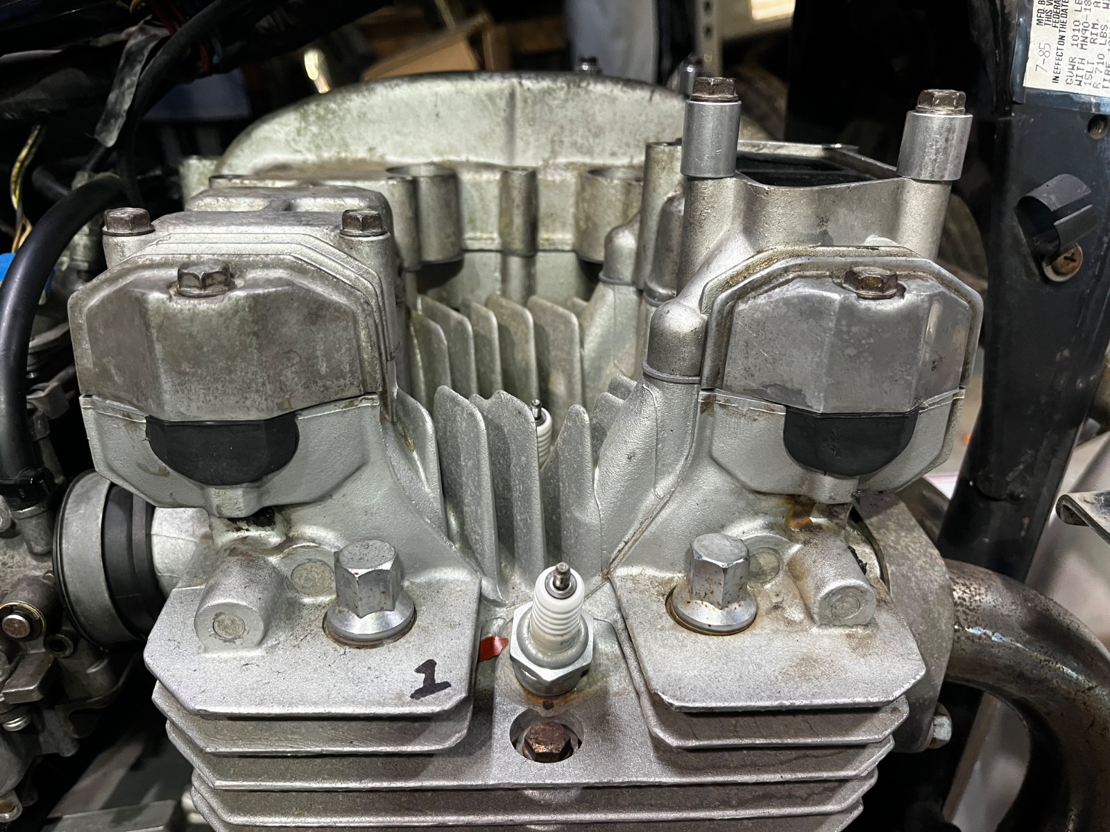

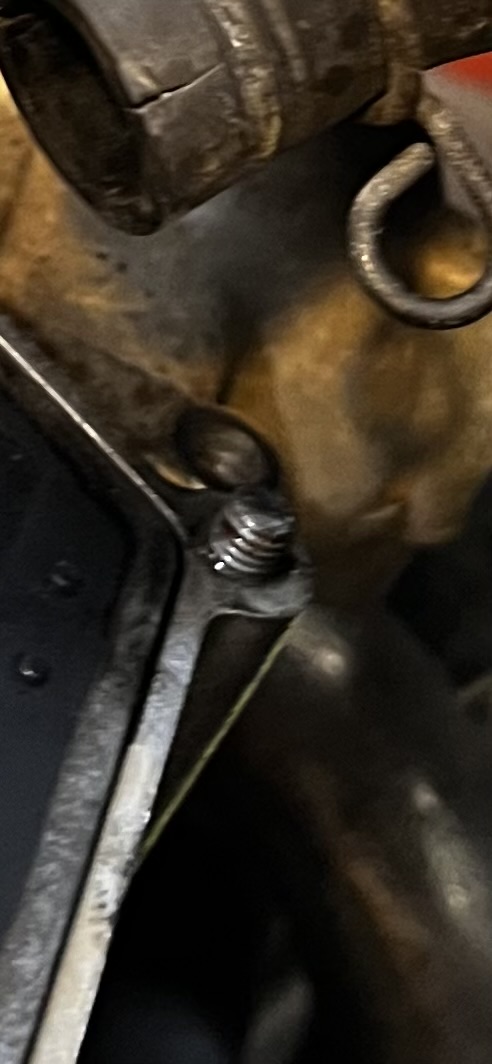

A little snafu on the cam cover. Two of the bolts that hold the reed cover to the cam cover broke off when i removed them, one on each side. A drill and tap (1/4-20 was all I had) and we’re back in business. Thoroughly cleaned the surface where the plugs seat and added some UltraBlack. Put the new gasket and cover on and just snugged down the cover to let it setup over night.
I know this has to be an afternoon job thats taken me 3 evenings after work. Tomorrow we’ll slapit all back together and hope she’s sealed.
