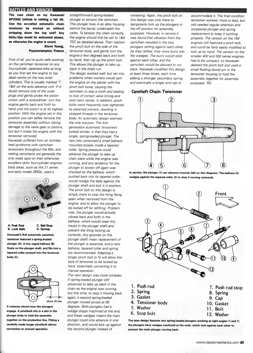

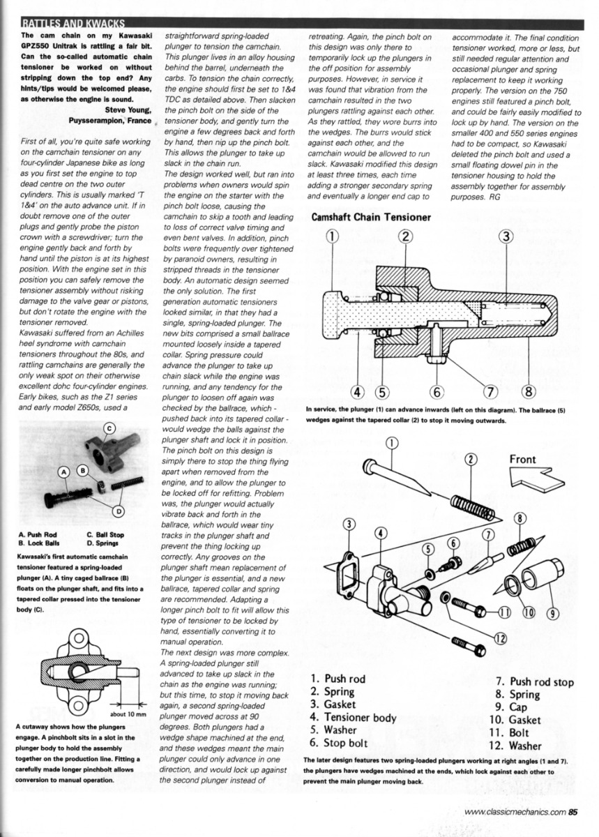

Let us know if the ball race does lessen the noise. Though the attached doc is about the units that came stock on the 650s it does explain how the ball race is supposed to work.

Noteworthy. Those "retainer", nothing more then a caged ball ring, have been problematic for everything they put them in starting in 1979. Theory is it's supposed to "wedge" around the pushrod and not back-out. That's not always the case though, they slip back and spring isn't strong enough to keep the chain tight. They used this on the KZ1300 but everyone replaces them, google it, you'll see the similarities in design. The KZ1000 1979 -80 also used them, same issues. That other "two" wedge design gd4now shows is a better design.
